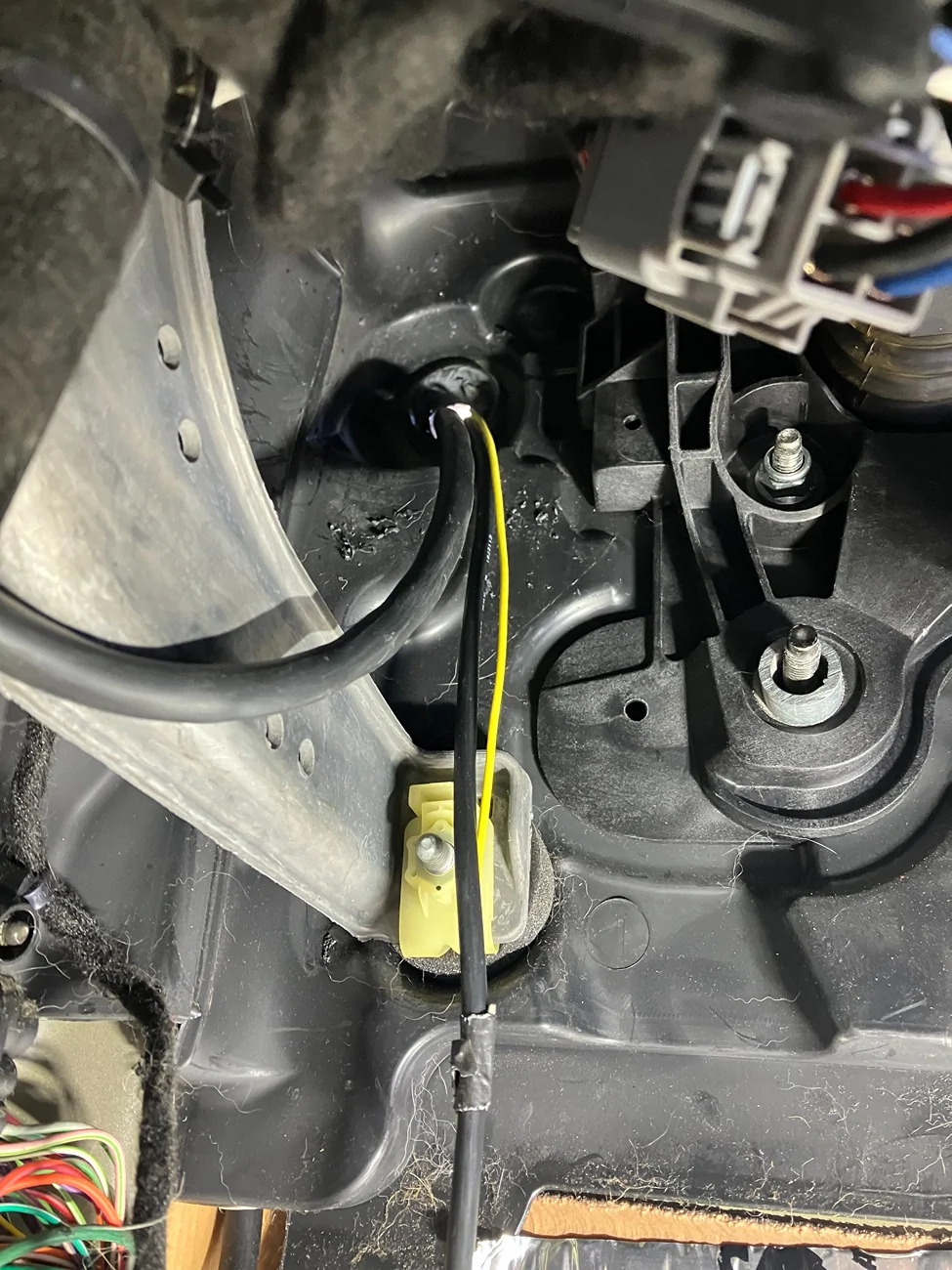

For anybody looking to run any wiring through the firewall, there's a round plastic fitting on the driver's side firewall, just below the brake booster. I used a step drill on a flexible extension to drill a 3/4" hole in the fitting. In addition to the Cool Tech cable, which is 4 insulated wires inside a black covering, I ran the yellow trigger wire for my AMP Research retractable step, and the break away wire to feed in my brake system.
Here's a picture of the hole in the firewall from the inside;

NIce mod running it inside the Jeep!
