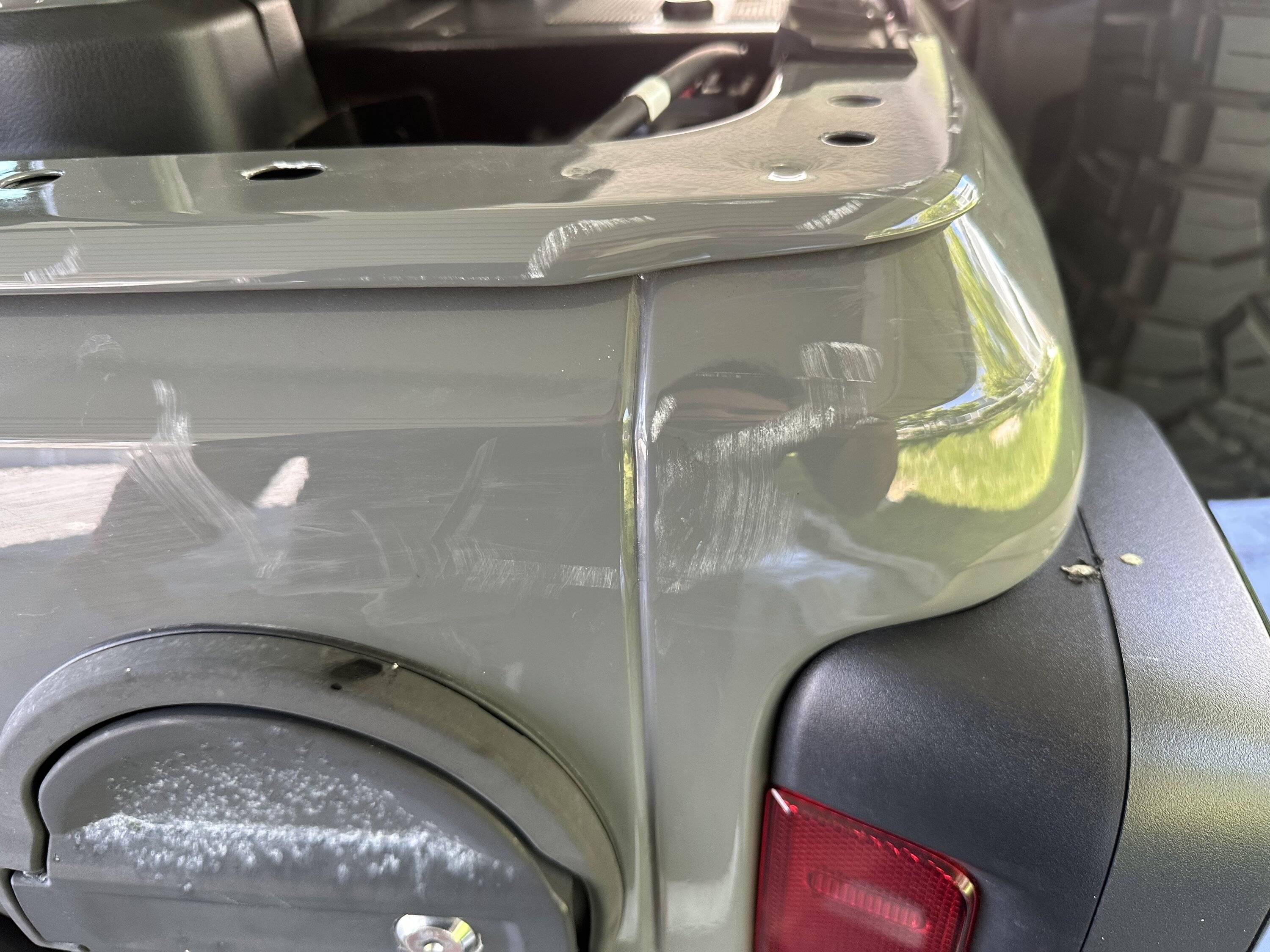

My brother in law dropped the hardtop weight on the side of the jeep and it looks like it scrapped off the clear coat. When I apply water, the white powder goes away but comes back in like 3 seconds. Would the products in the photos resolve this?

Maybe, but they would be skipping some steps.
Can you actually feel the scratch? Like does it catch a fingernail?

it does not catch a fingernail. Seems to be just the top layer
Good, you should be okay then.
Hopefully you can pull it out by hand.

the " powder is fiberglass from the hard top. the scratches look like they may buff out. I always start with clay bar to remove the top lay in the areas wax. then a good compound buff fallowed up with polish and then get a good gel ceramic coat not the spray. Typically the spray on waxes are for between big hand wax coatings. I use the turtle wax Ice spray wax on windows and paint every wash.

note looks more like the fiber glass imbedded into the clear coat. should come out pretty easy.
