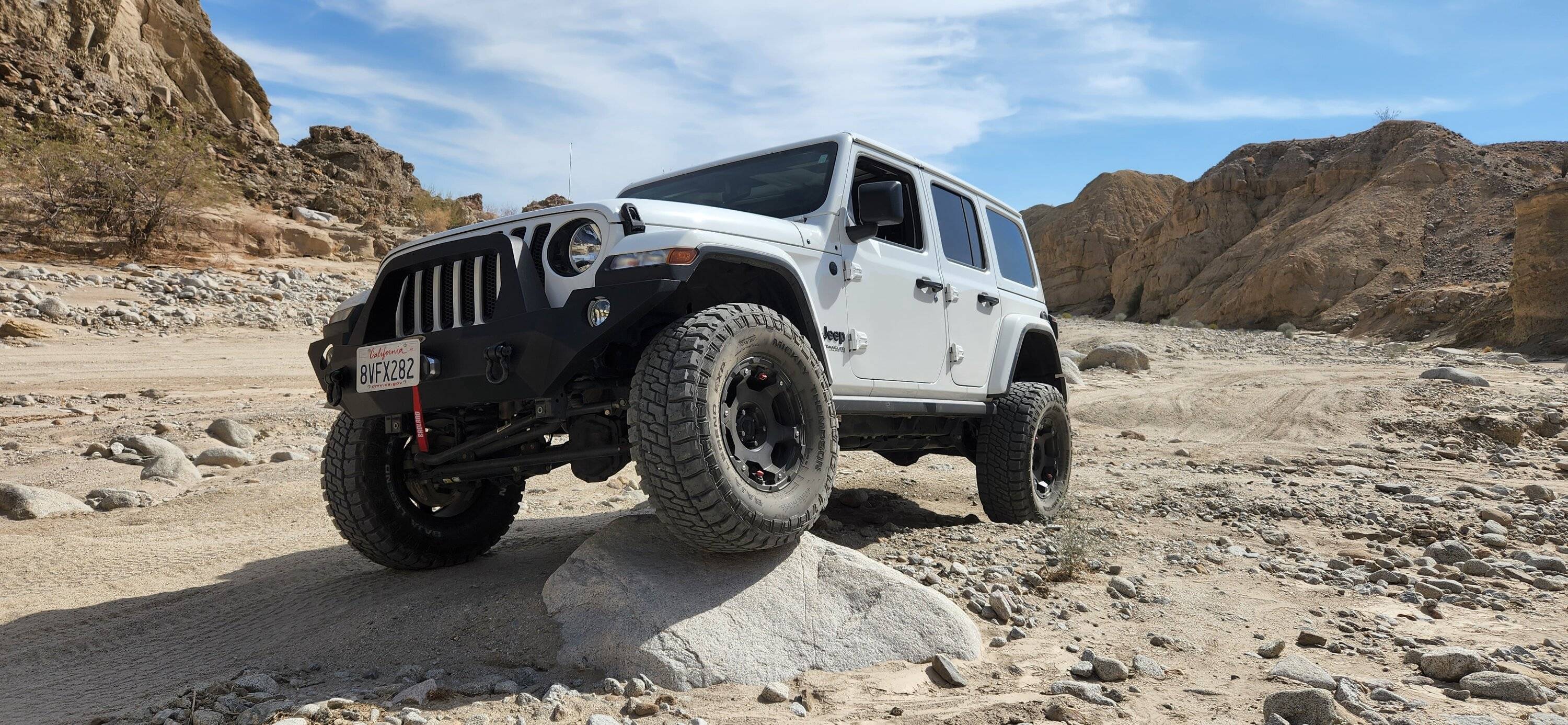

Is that picture in Sandstone Canyon/Fish Creek Wash?

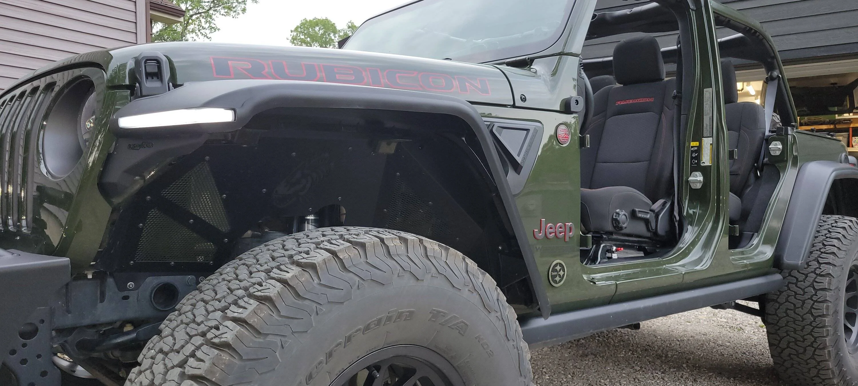

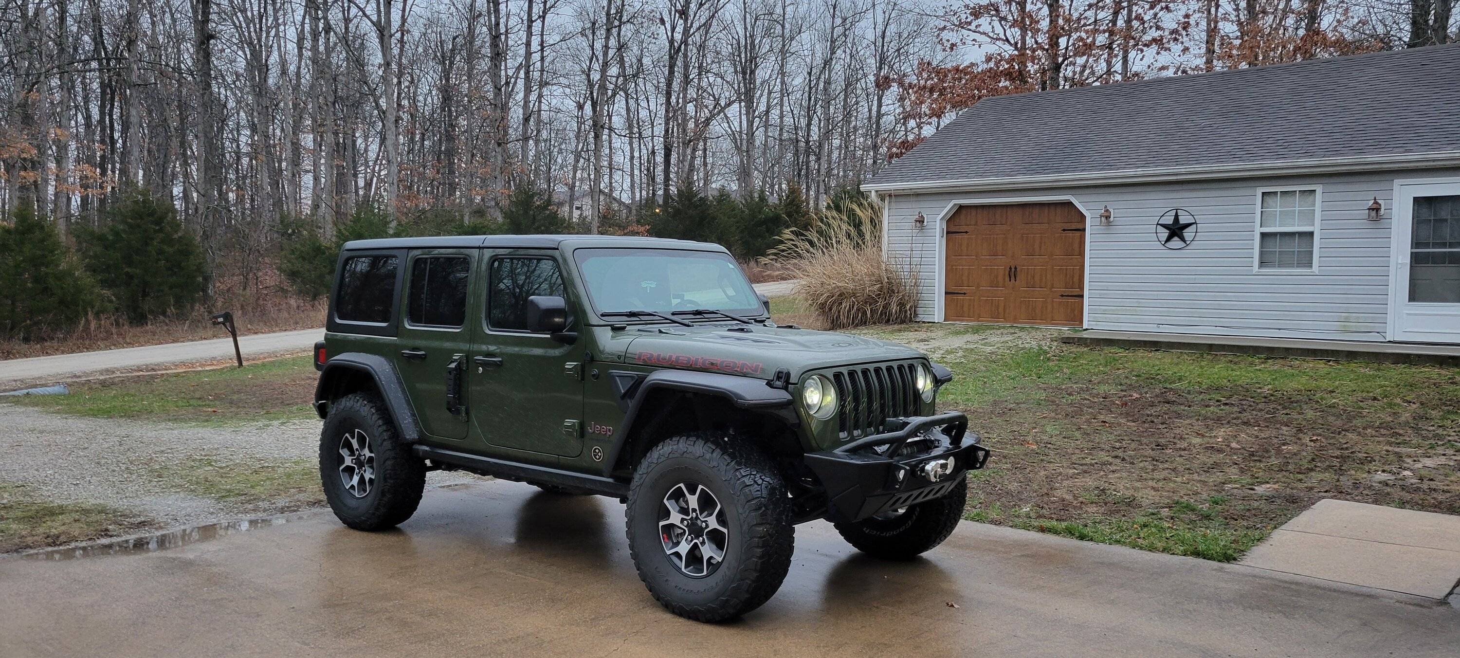

I installed a Dynatrac 2" lift with the lower control arms out of the Mopar 2" lift on my 21 JLU with 37s. These pictures are not factory fenders but they run just fine with factory.

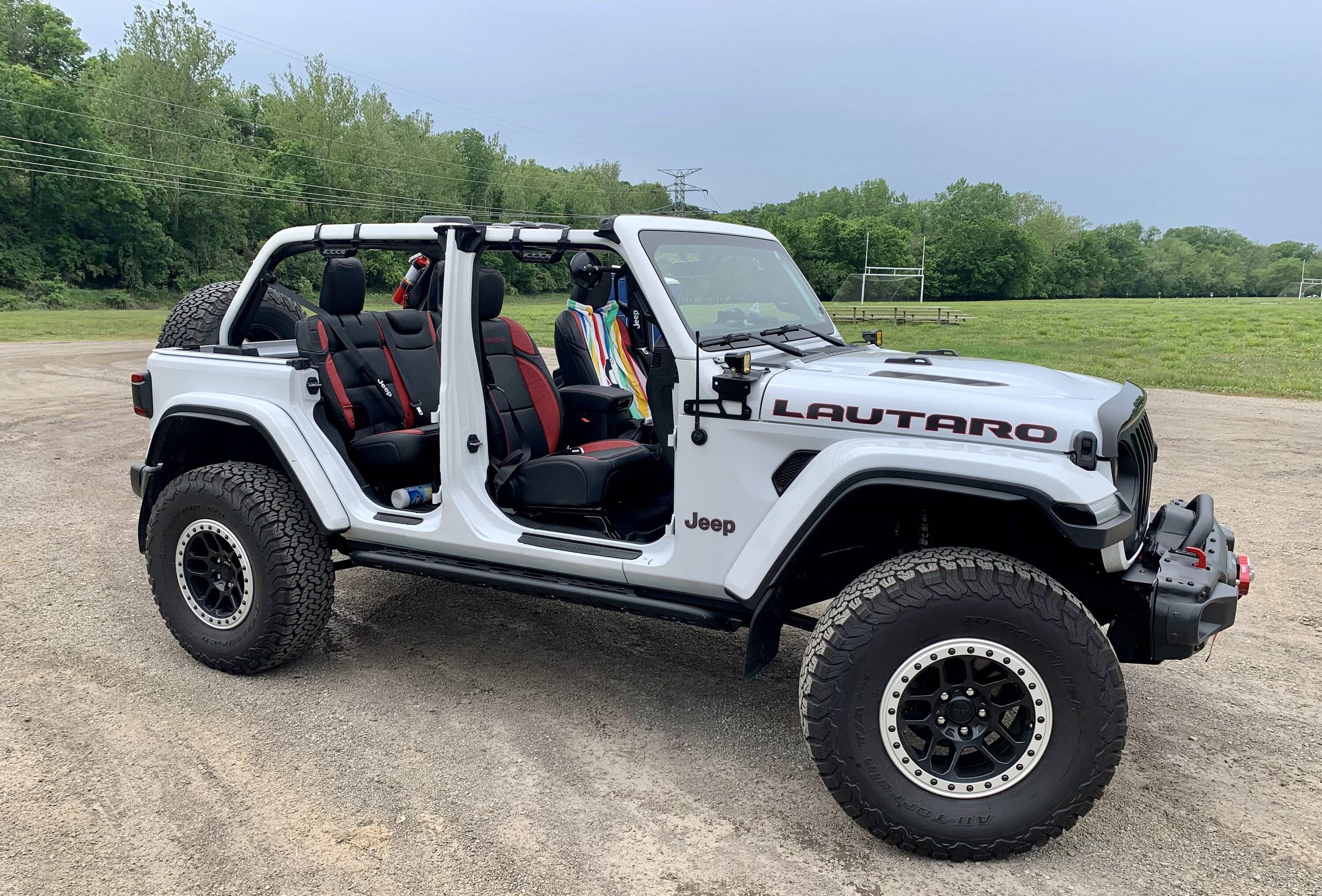

I have a 21 JLUR with a Mopar 2.5” lift, 37” tires and -13 offset Beast rims. No rubbing or problems.

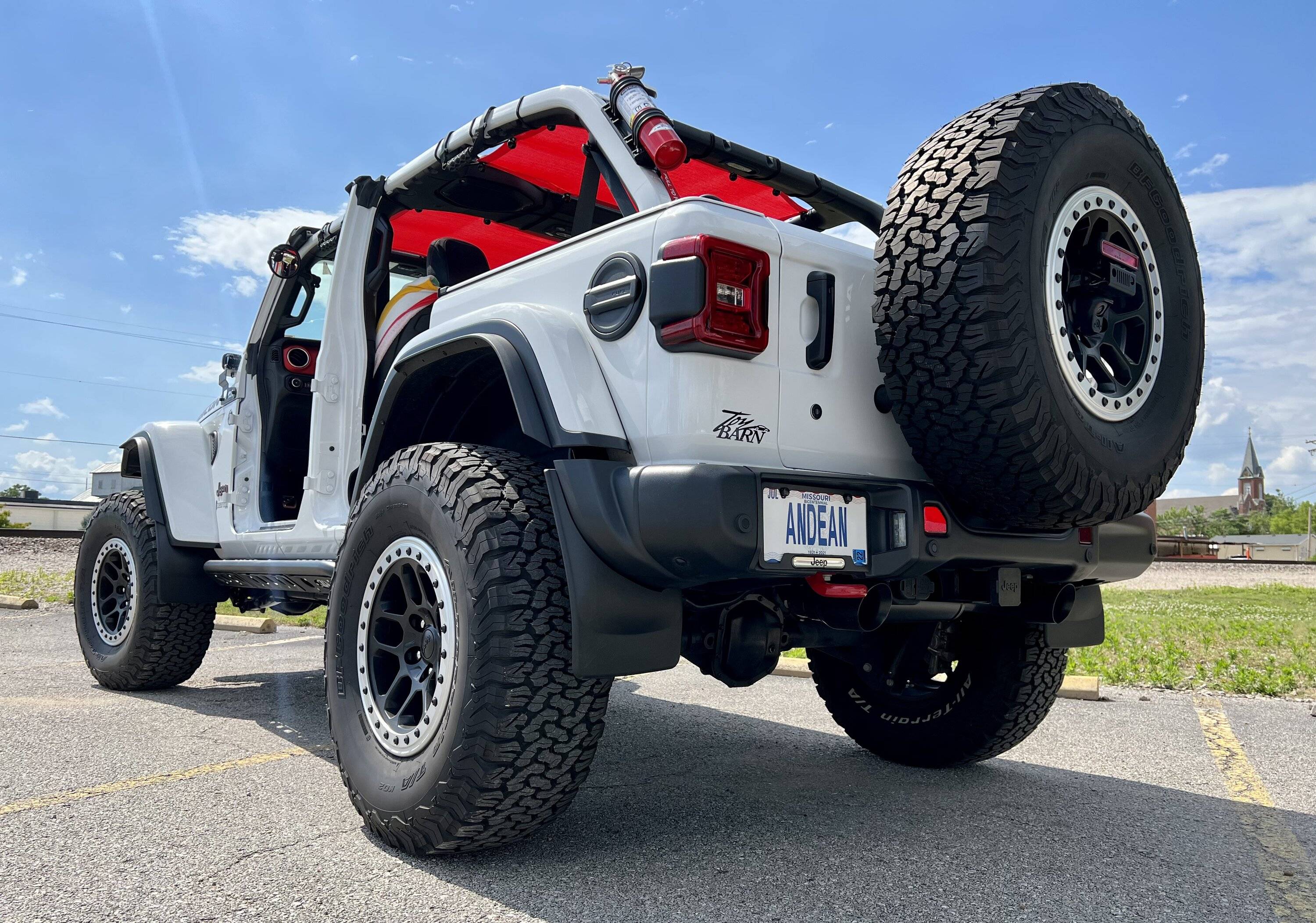

@73TAWM love the Army green! Are those Method Race wheels in the bottom pic?
They are!
Usually that's the first thing people change but it took over a year, and after several other mods before I changed wheels. I was waiting for a good deal. Found one at a local Overlanding Convention in Missouri.
