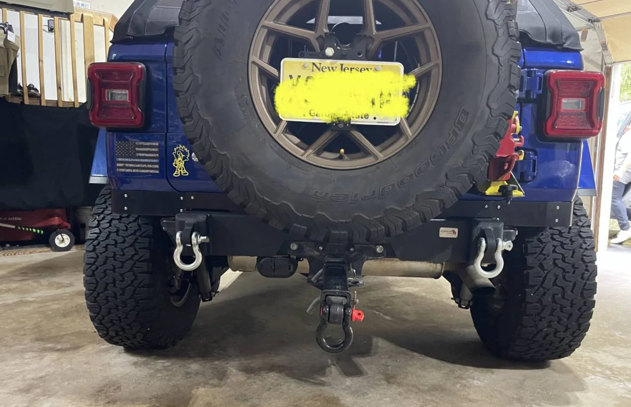

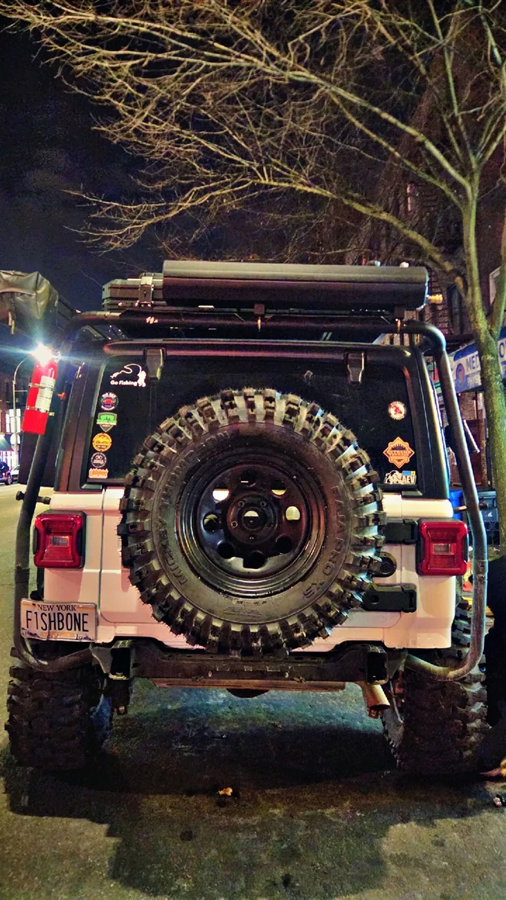

I am going with a Nemesis bumper but I just took mine off and have been doing that while waiting for parts.
Curious to see-how the deletes look.

I have gotten used to it like this so if I didn’t have everything ordered and in progress would likely have added these and called it good and saved a ton. Or one like you are going to use.
https://cavfab.com/products/jl-jlu-rear-recovery-d-ring-mounts
Why I picked up the Factor 55 hitch recovery point why I wait so I have something.

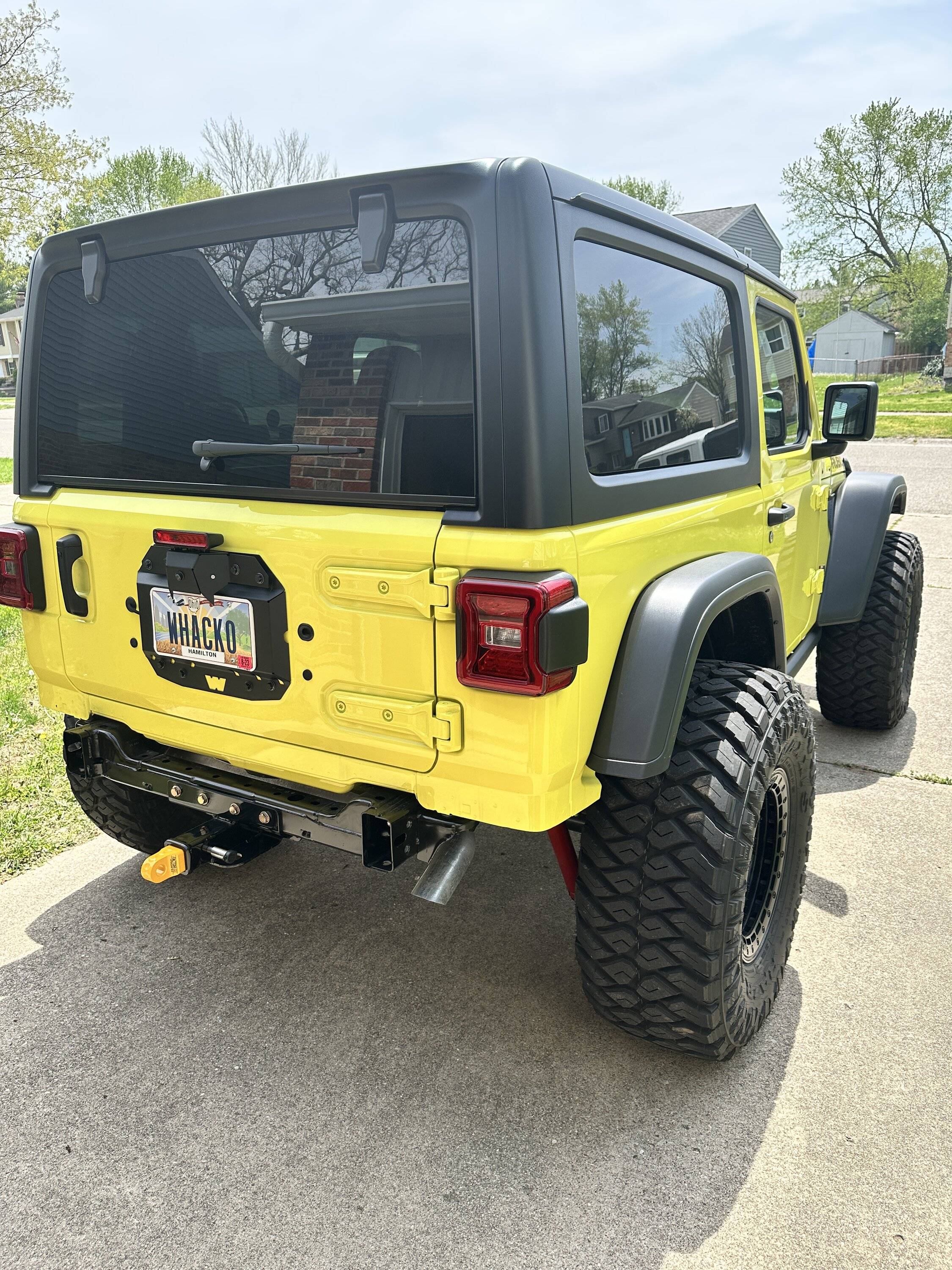

I just installed a rear delete on mine. I'm particularly pleased it will allow me to adjust my rear spare tire down. I'm waiting for some JB weld to cure after trimming the rear of the wheel well before I get it back out there. It did require a deadblow to convince it to slide into place.
What are your plans for the license plate? I don't care for the spare tire mounts, so I found one that mounts to a shackle and added a light.

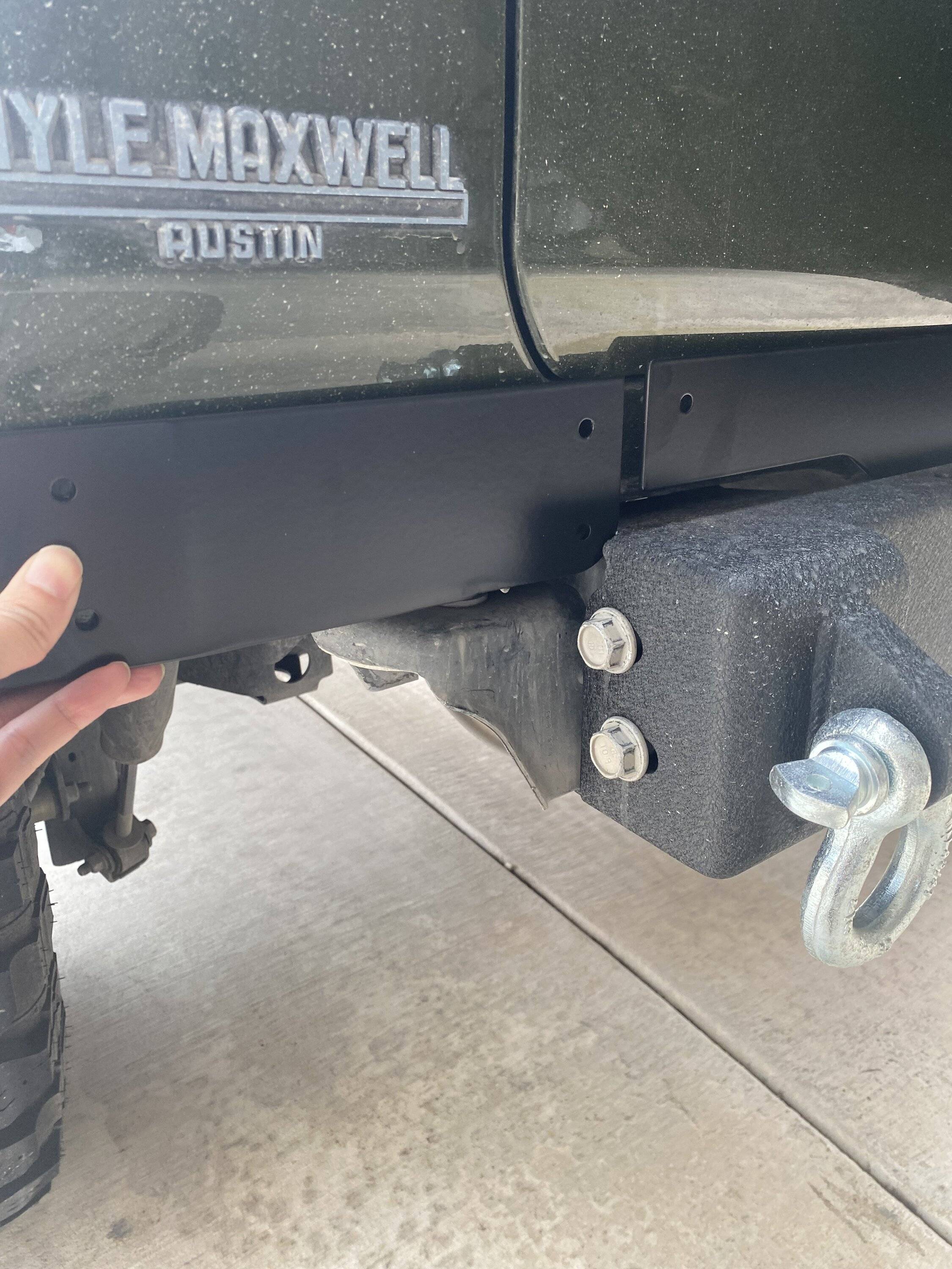

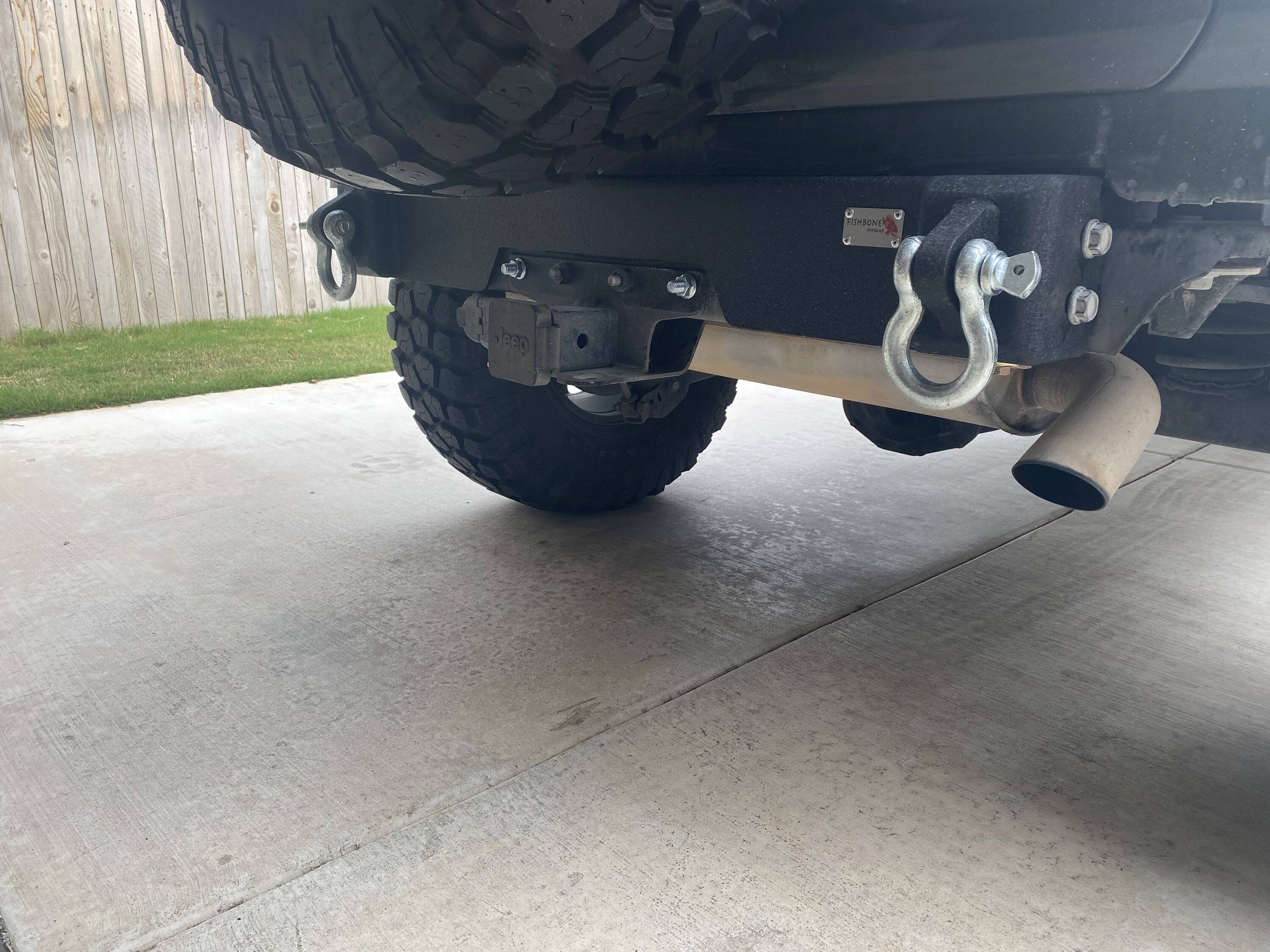

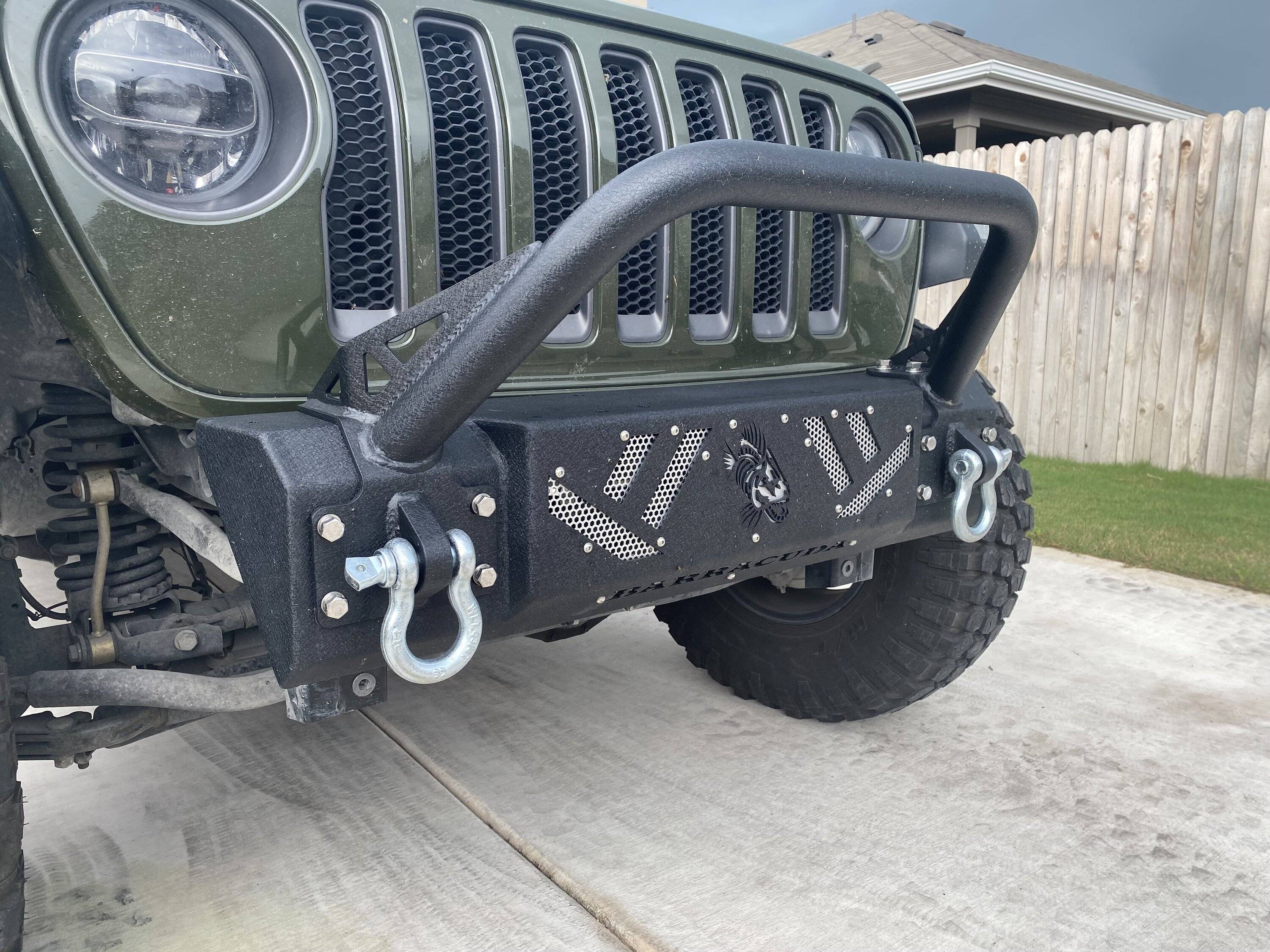

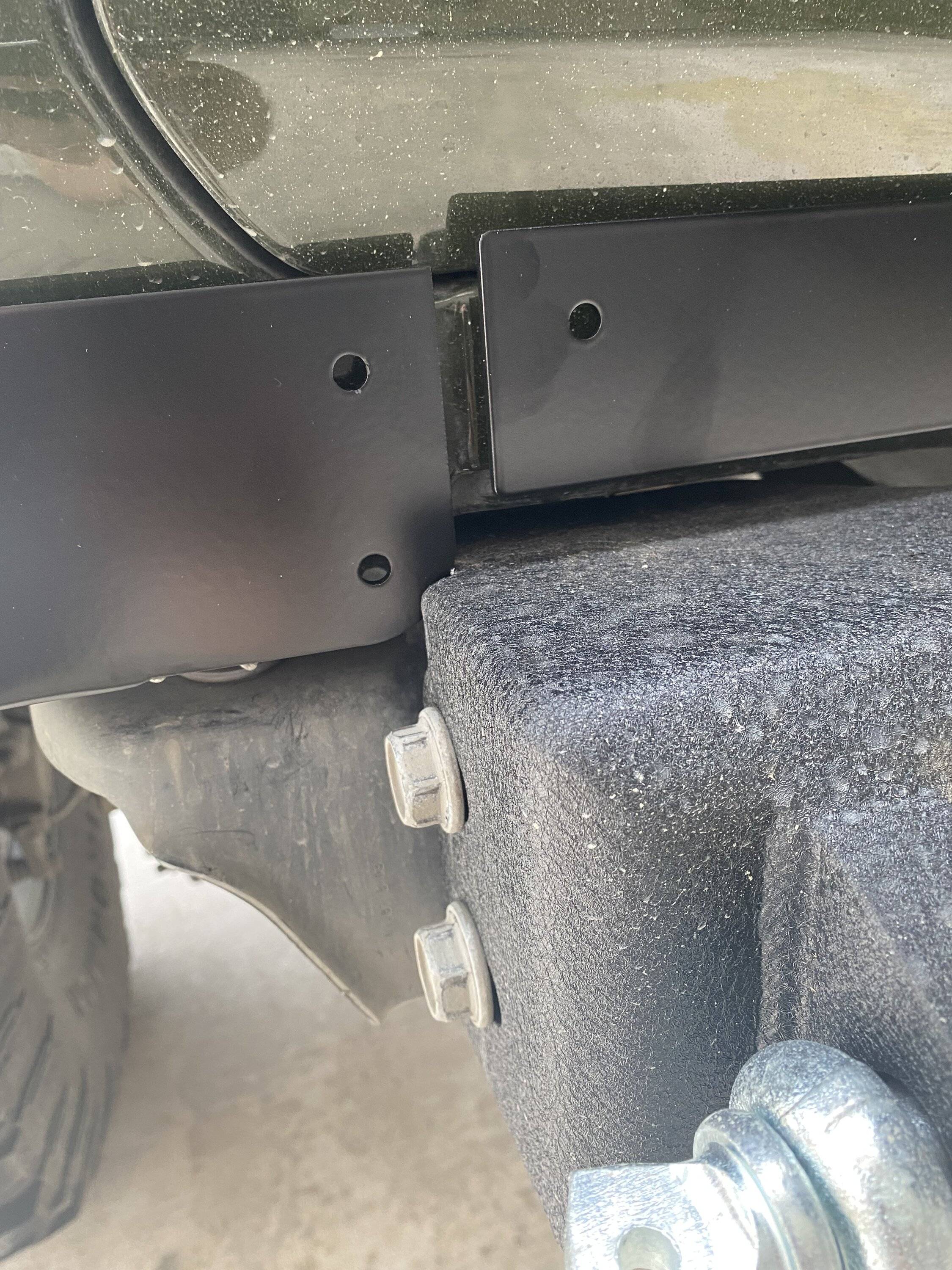

I have the Fishbone Barracuda from bumper and the Fishbone Rear Bumper Delete. Just finished the install of the Rusty’s rear fascia as well. No pics of the rear fascia fully installed yet. Just some mock ups, trying to get everything in line. I did notice with the rear delete that the middle section of the fascia doesn’t quite line up. Some massaging will have to take place.

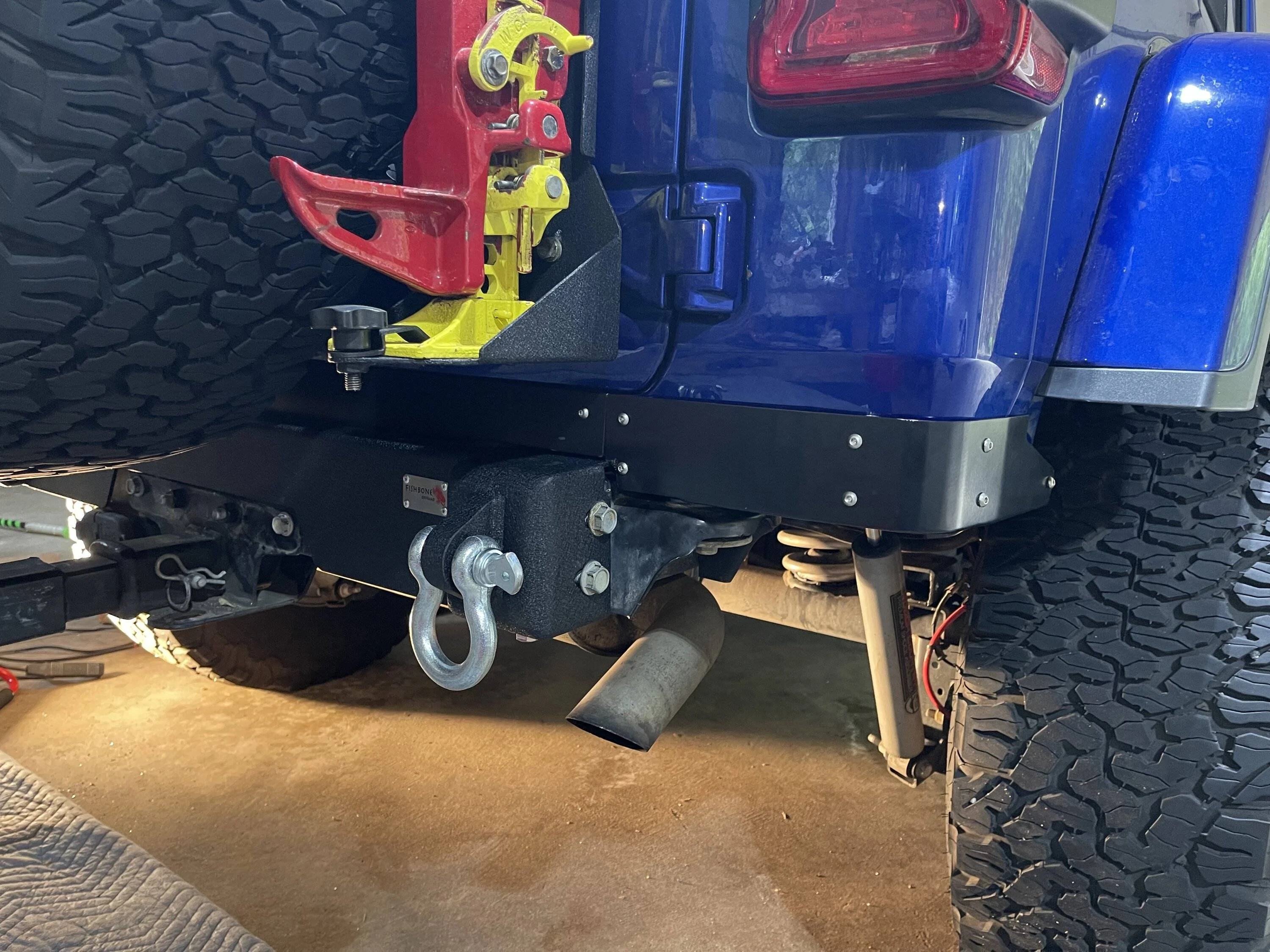

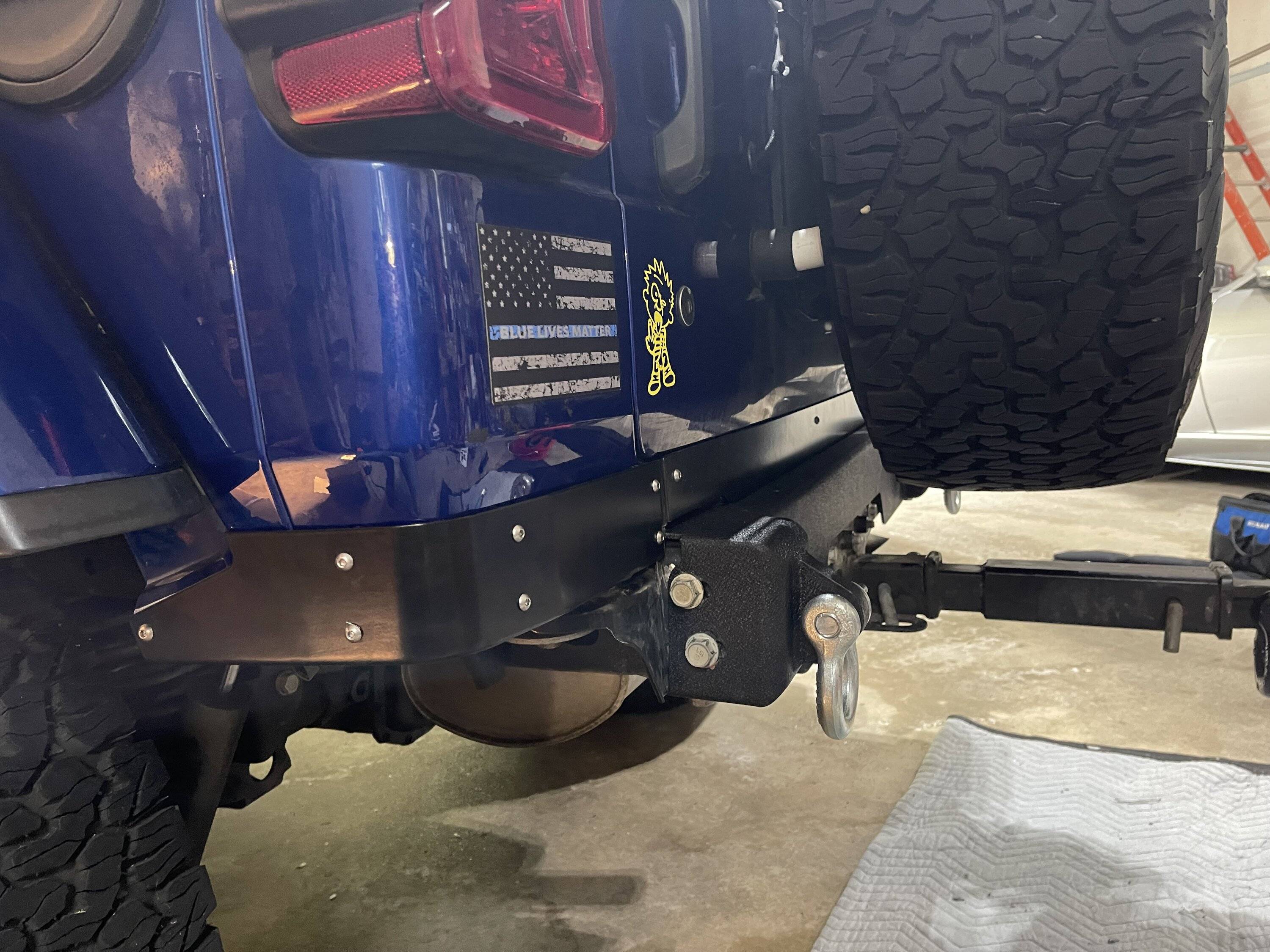

update: I installed the Fishbone stubby and Rusty’s rear fascia. Be aware- 1. you must reverse the tow hitch nut plate and two outer bolts or the bumper will not fit. 2. I need to use my angle grinder and cut away about a 1/4” notch in the L/R corner fascia so the bumper would slide on and align with the mounting holes. These are relatively easy fixes but if not creative, it wouldn’t have worked. Now that everything is installed, I’m very pleased.
No bumper needed used to have fishbone rear deleted bumper took off
Jeep Wrangler JL Fishbone Stubby bumper / bumper delete Snapchat-504327978
