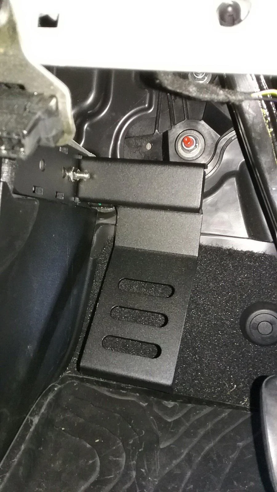

I finally got around to installing the pedal yesterday. Not sure of the brand, it was a gift. Yup, a pain to install. My body doesn't contort like it used to! I had to mount the pedal section all the way back because of the position of the bracket holes. A very poor design. I'd rather have the pedal height much closer. I may remove, rebuild and reinstall it after my back recovers.

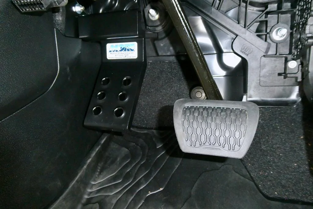

When I installed mine, first time I put it on the furthest setting, and it took a few minutes, but I decided that I wanted it closer :facepalm:
Twenty minutes later, and lots of twisting and squirming I had the middle setting done.
What I figured out is that an offcut of 2"x1" drops down behind the thing inside the frame and holds it in place while you bolt everything together!

That is a good idea I hadn't thought of. I installed mine yesterday and first tied some thread around it in case I dropped it initially and then put a zip tie around it to hold it in place while I got the bolts on. I also stuffed a rag in front of the bracket just in case I dropped a washer or nut. Took about 10 minutes to do the entire process using the closest setting of the 3 options.

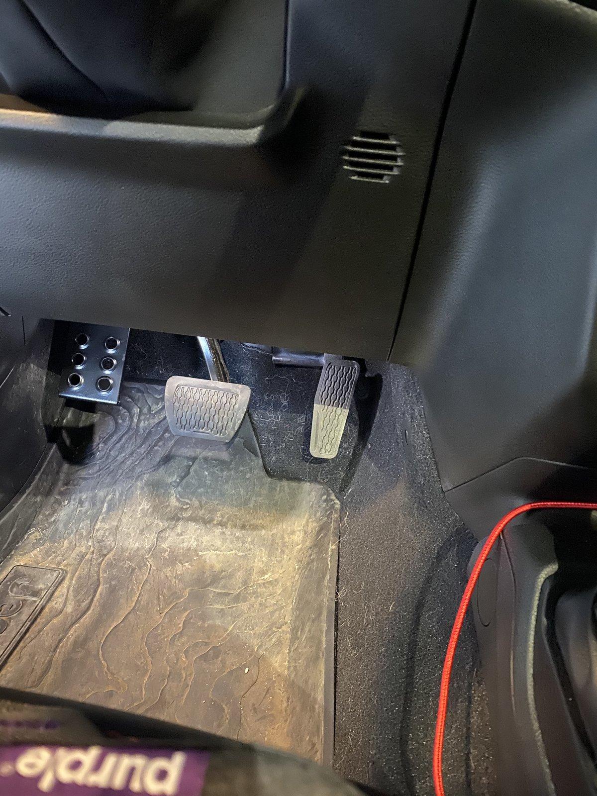

Hopefully this helps. It’s placement is similar to a clutch. Also. I have it set to the nearest setting. I tried it alway the back and I could barely reach it. I’m 5’11” for reference.
