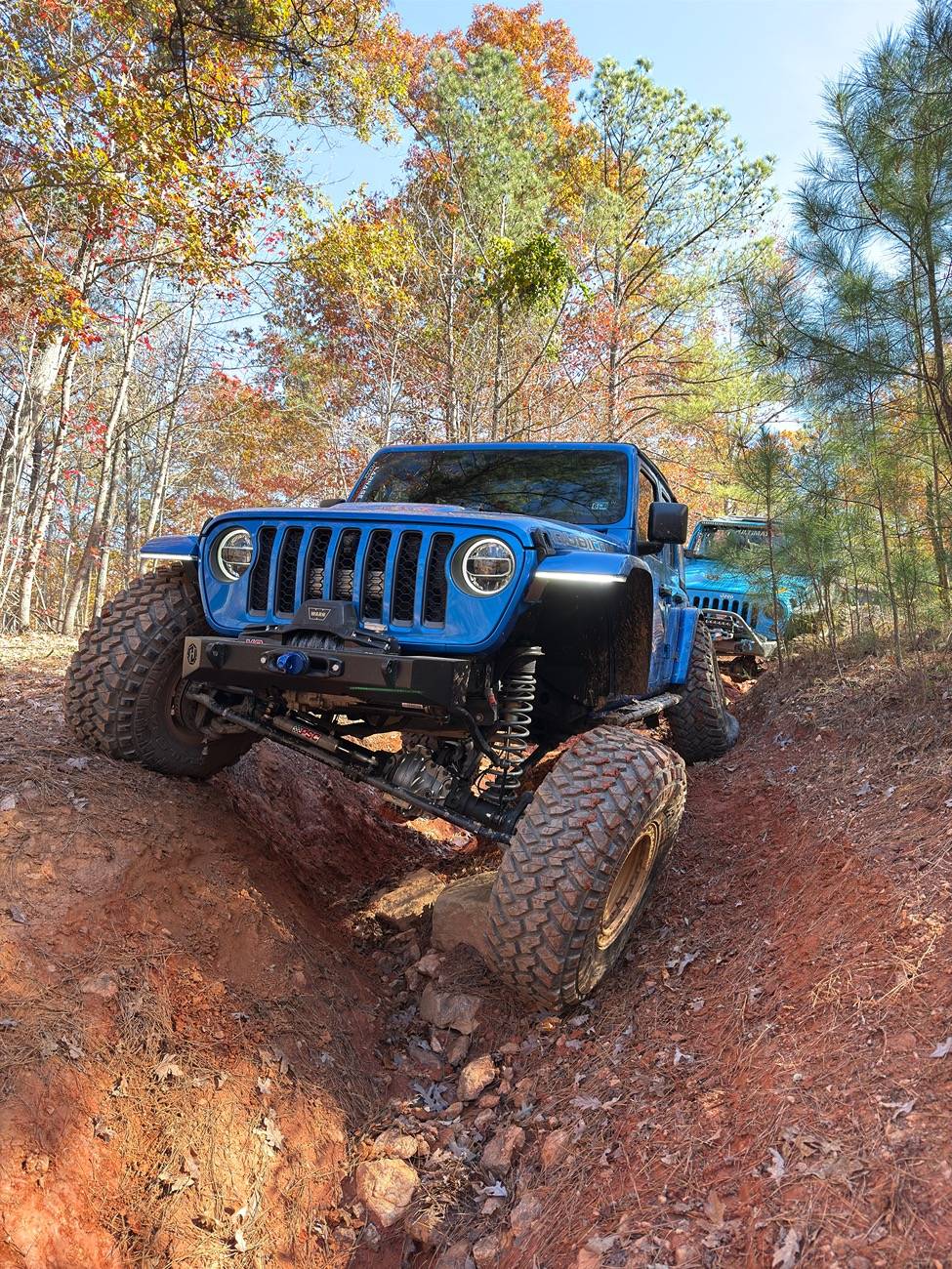

I have used the Tazer’s “cool down” mode while going 80MPH when I see the oil temperature at 240 or higher and it does slowly start to bring it down a couple of degrees. The coolant temperature goes down even faster. Granted if I was going 75MPH or even 70MPH the oil temperature would be closer to 231 instead.
This is running 40s on UD60s and 4.88 gears. Highest I have seen since new has been 249 oil temperature but no derating as I slowed down and stopped to refuel when driving to California.
Still have the stock hood vents untouched and using a recessed winch bumper but like others have said these don’t seem to be big factors. I do wish the PSC cooler wasn’t located where it is but it didn’t seem to make a difference either.
