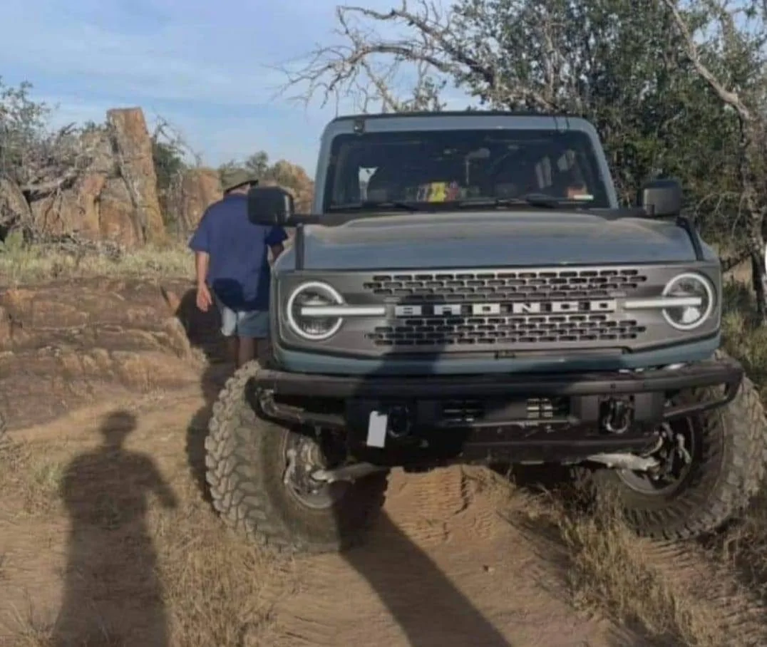

Buy a Bronco, they gotta be good for something……….. then again….. probably not…?
