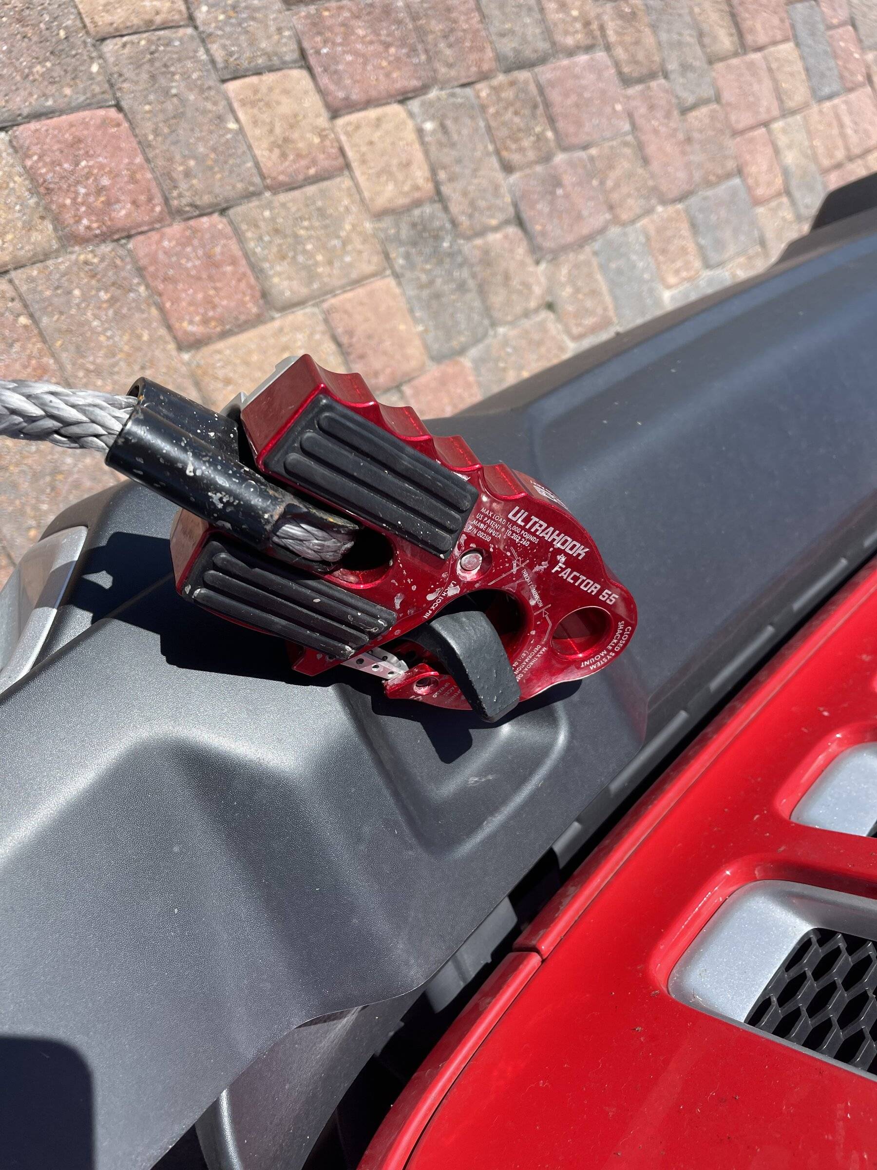

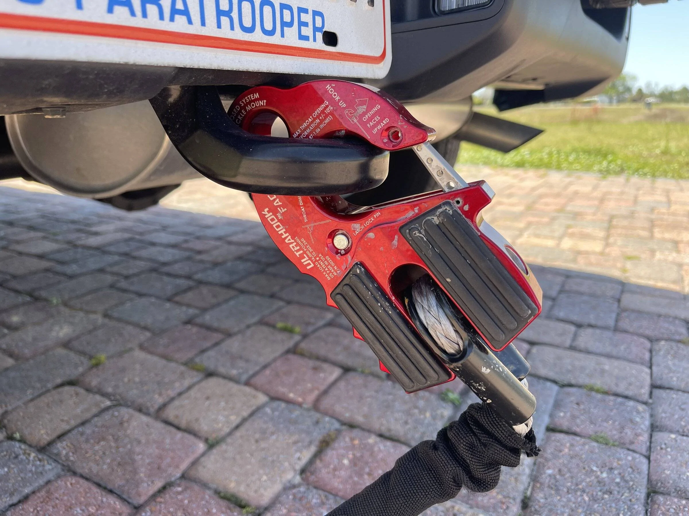

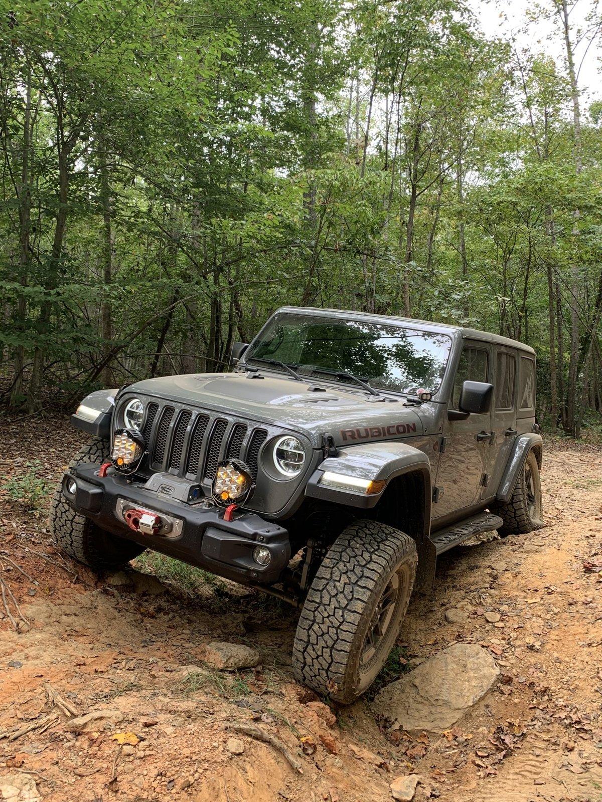

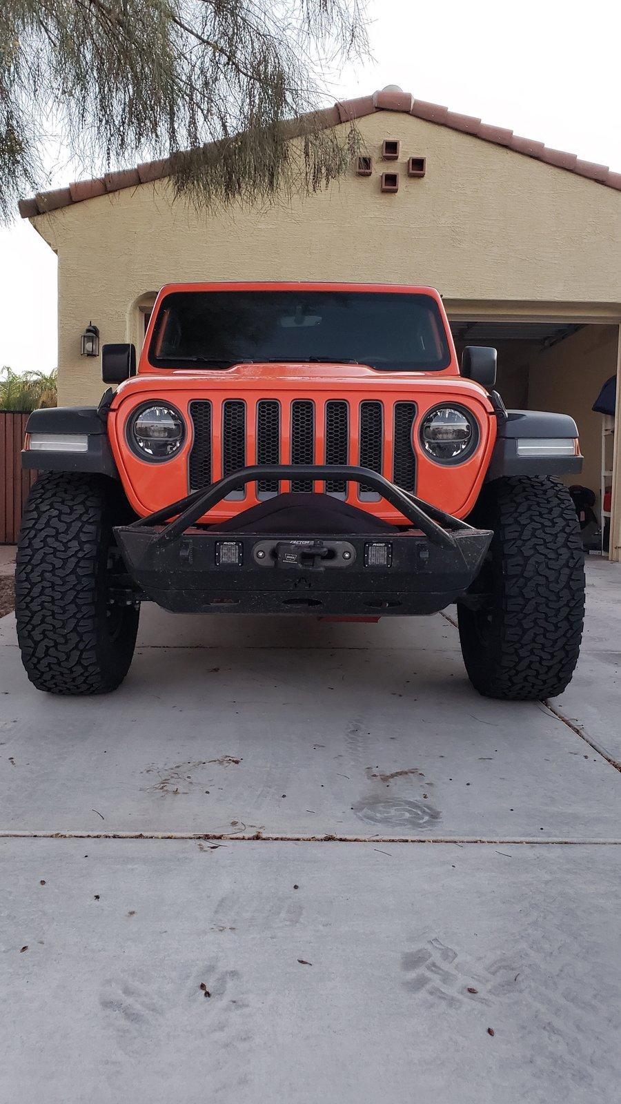

I have the Ultrahook with the guard on it. I have used it a lot over the past two years.
The reason I went with this model was it give you two options of either a closed or hooked system. The hook has a locking pin that can be used to make sure the latch will not open on the hook.
Their are times where it’s not a major recovery and a quick hook is faster than getting a D ring or gator soft shackle out.
When I’m doing a major recovery I’ll use the closed loop part.
Always remember when using the hook part, the opening on the hook should point up. The Ultrahook is designed to where your hand grabs it to hook it up vs down.

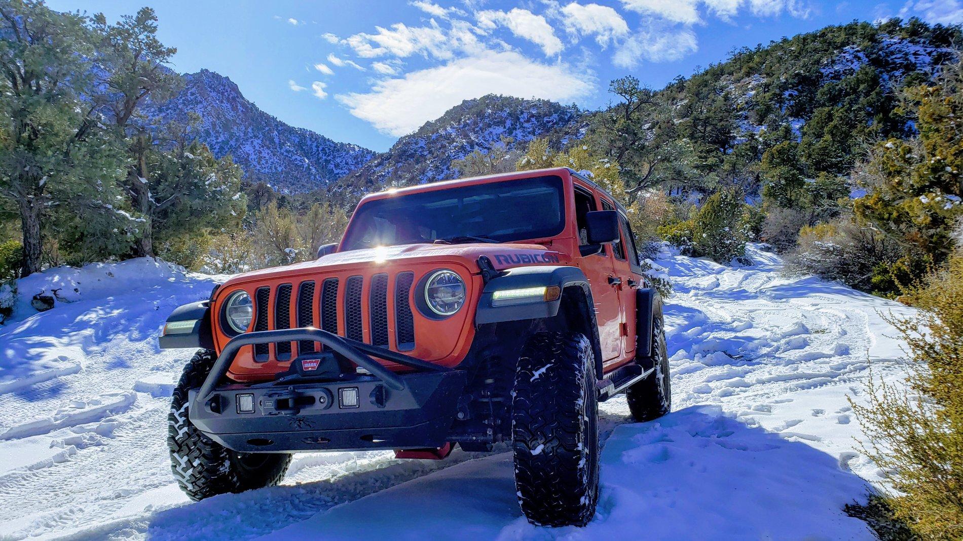

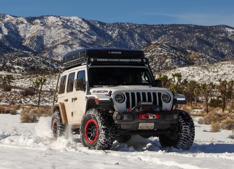

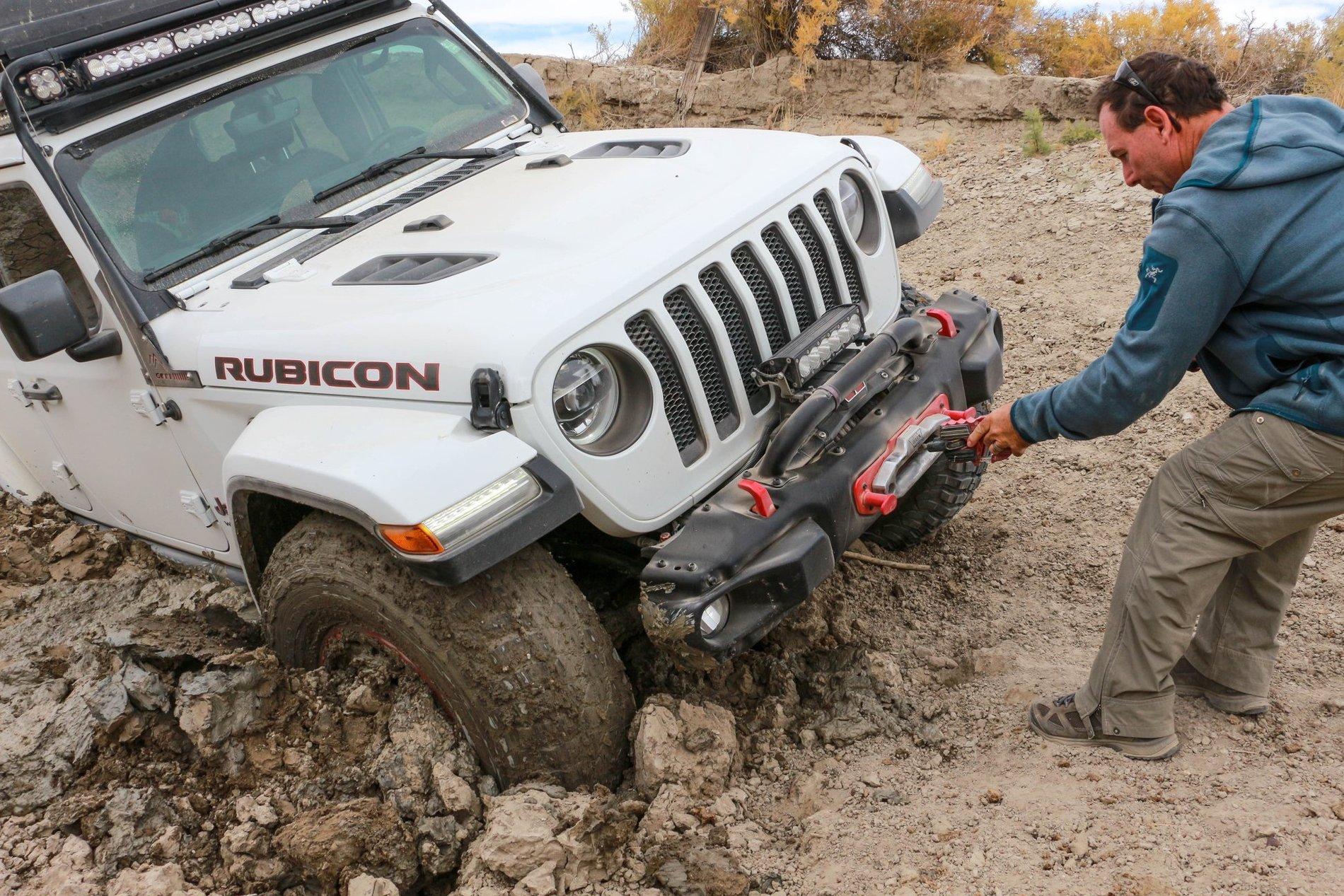

I was planning on a factor 55 product again as I had one on my 2019, however for my 2020 JLUR I went with the Warn sidewinder. It works really well, and does a great job protecting the rope. I was not sure at first, but after using it a few times I really like it.

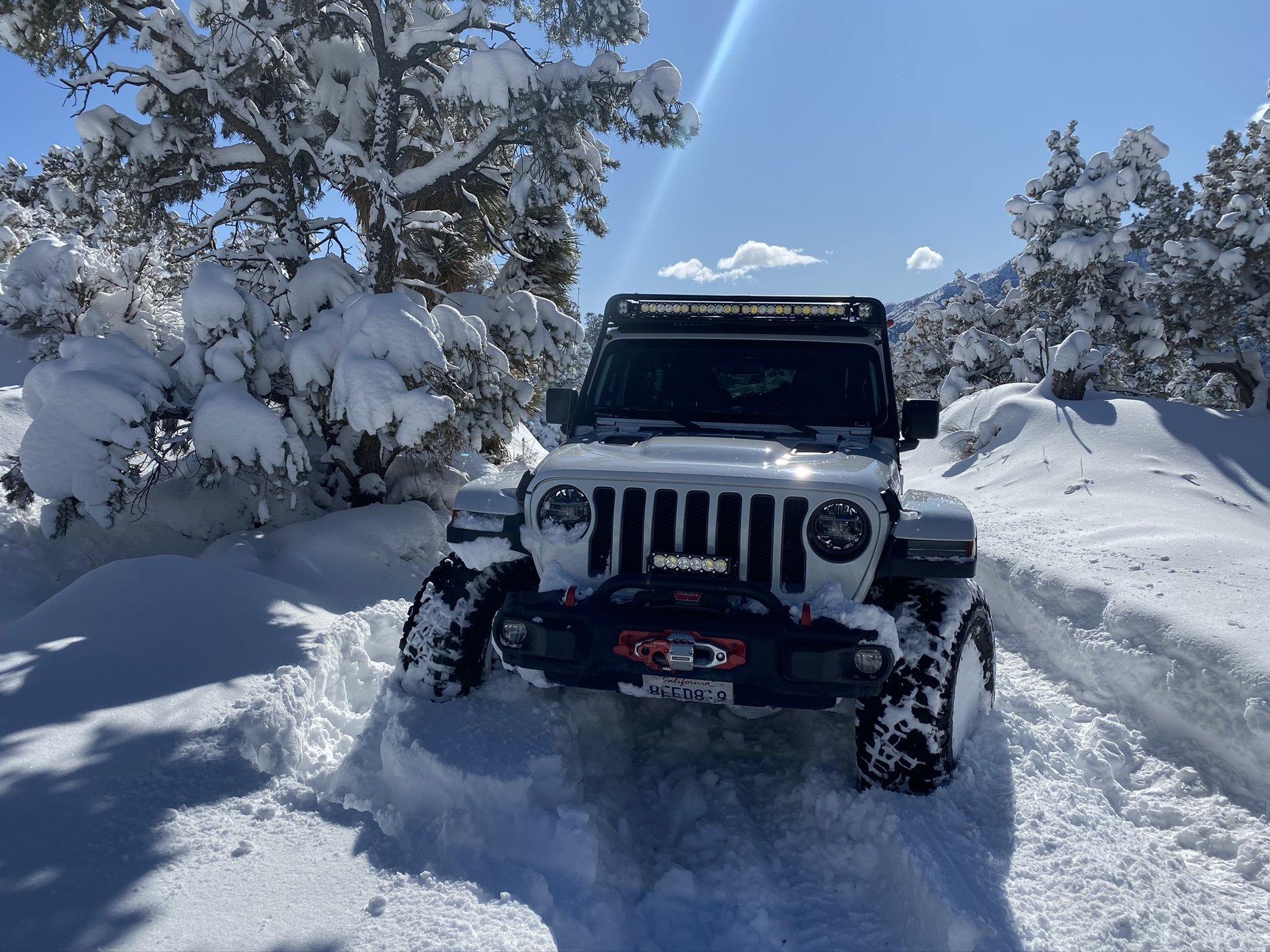

Front doesn’t really go on and would not use it.
Jeep Wrangler JL Factor 55...Flatlink vs Flatlink Expert vs Ultrahook FF25C560-9DED-42EA-85C1-6C2B94F1D9CD
Jeep Wrangler JL Factor 55...Flatlink vs Flatlink Expert vs Ultrahook AC67555A-6E43-4D72-B029-1C98ECBBFC44
Rear would do in a pinch. I would use a shackle.

Agree with @SH556JL just because you can get it on there, doesn't mean you should. It would probably get stuck under the tusk and tear things up in the process. Recommend you keep a soft shackle in the glovebox with the winch controller and gloves. You will probably need it to connect to anything you pull anyway, be it a vehicle, tree saver, or larger bow shackle.

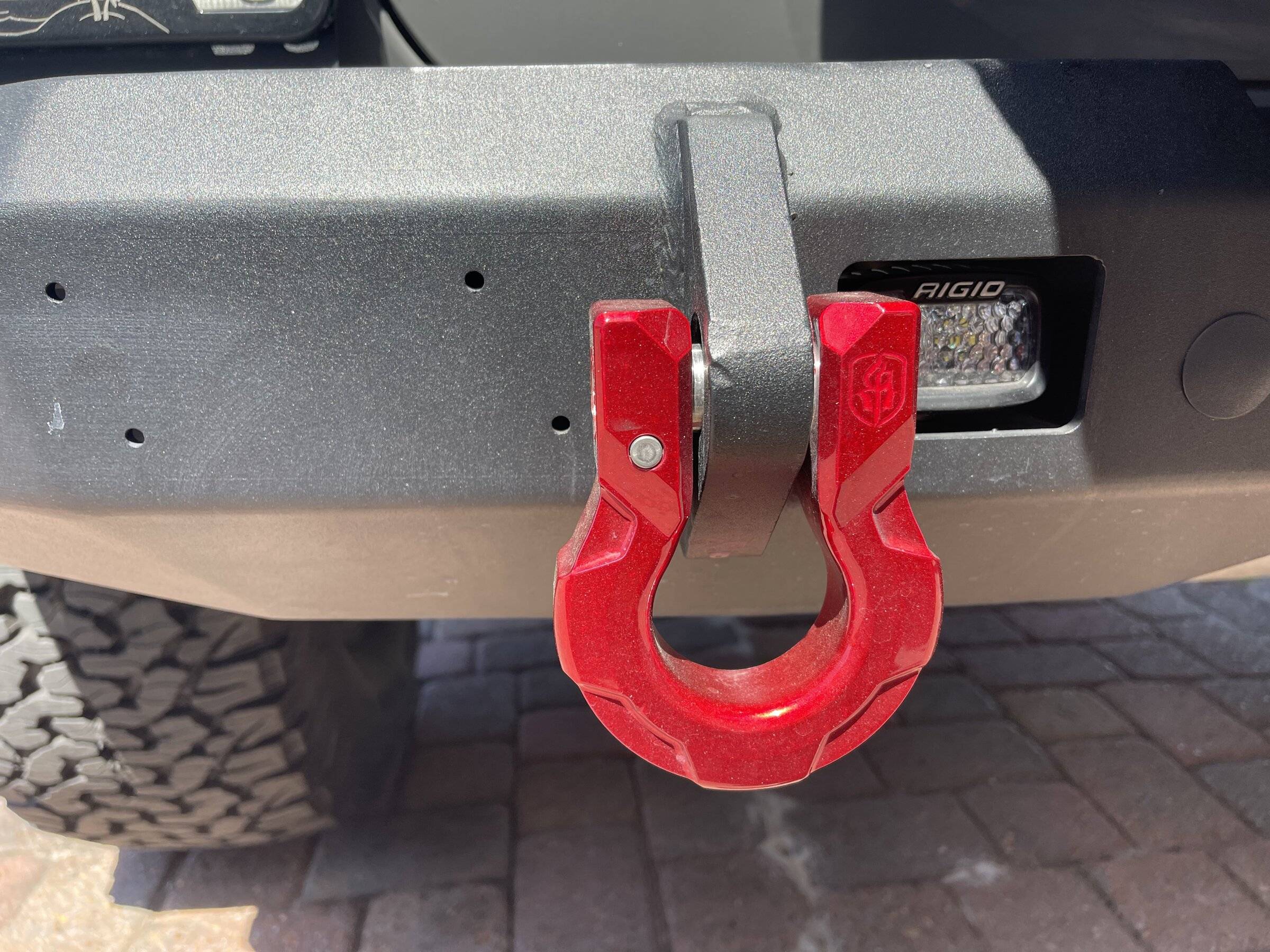

Yep, I also learned that my shackles are for looks. I couldn’t even hook to them if I need to in a pinch…
