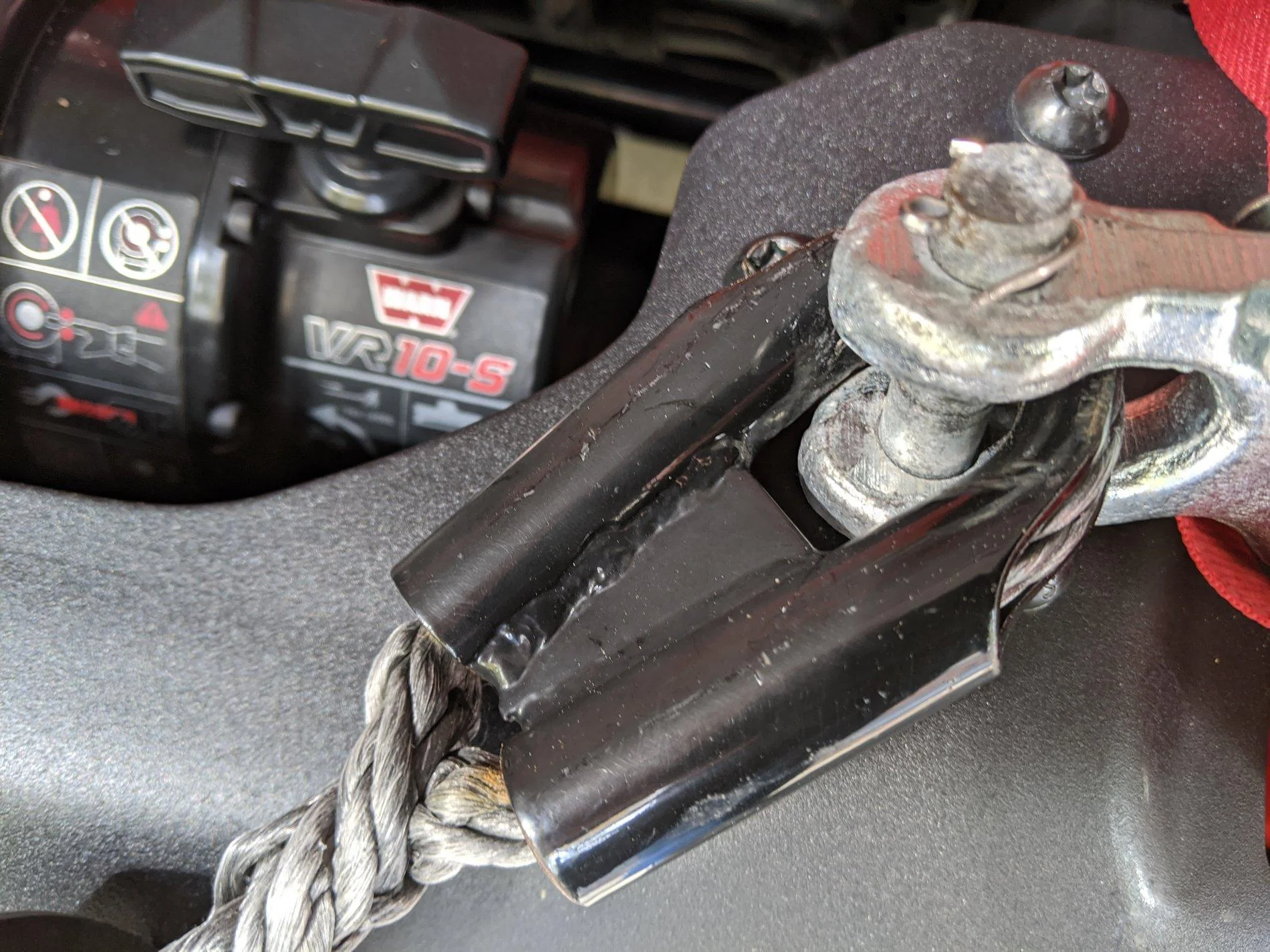

Bought a Factor 55 Ultrahook for my wife for her birthday. We went to install it on her Jeep ('19 JLR), which has a Warn VR10-S winch and we can't fit the Ultrahook over the winch cable eye - it's just too wide (thick) for the space. It will attach at a 90-degree angle, but that's no good for actually winching. Anyone seen this?
Here's a pic of the eye with the old Warn hook attached:

Do you have a measurement of how far off it is?
What's the width of the clevis?
What's the width of the Ultrahook opening?

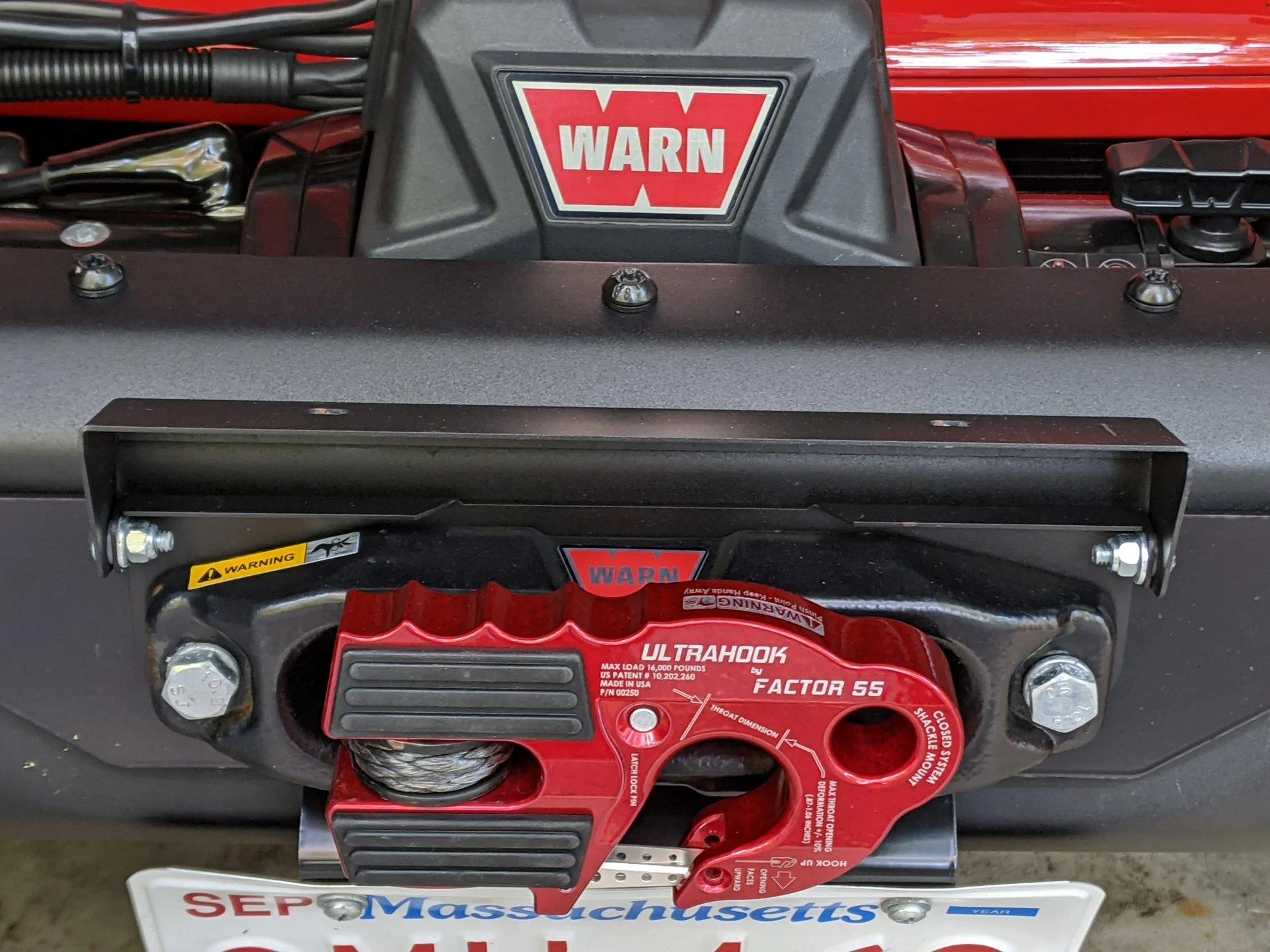

From the Factor 55 website under their FAQ...
Exactly... I was going to suggest hammering it, but didn't know how far it would have to go; wanted measurements before I suggested it.
Good find. That should do the trick, for sure.

Genius! Thanks for finding that so quickly. It did the trick! It looks great and she loves it!
