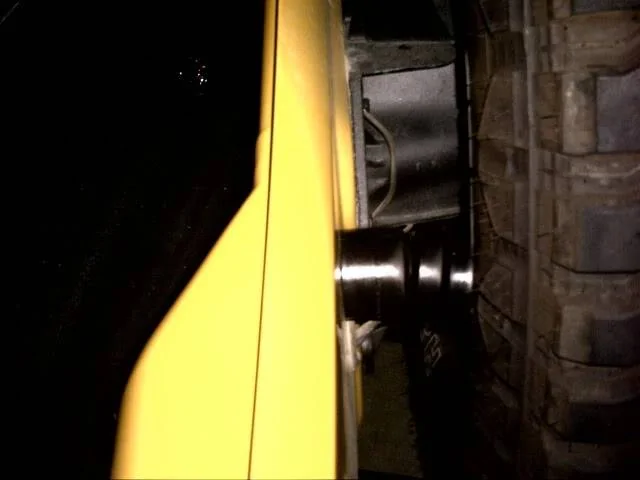

Aluminum spacers turned on my lathe
Nice looking! Can you give us details about where to find this kind of spacers and how you fixed it? Using a thread nuts maybe?

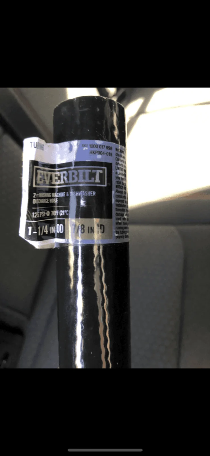

Was looking around for bump Stop extension ideas and came across this thread. My spare has a - 38mm offset so I cut two 5" pieces of 1" pvc pipe and used 1.25" rubber leg tips. Then covered the pipe with wire loom. I think it looks alright.
