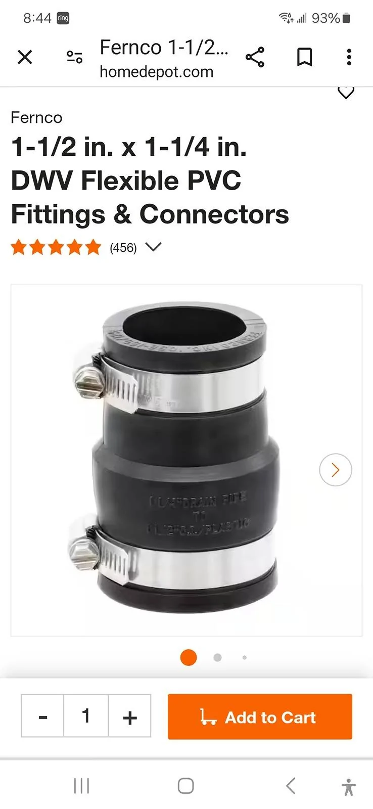

I used rubber step down plumbing couplers. They slide ride over the stock bumps and you can cut the length to what ever you need. The fit was tight enough that you don't need the clamps.
This. picked up at nearest local big hardware store and spare does move at all.

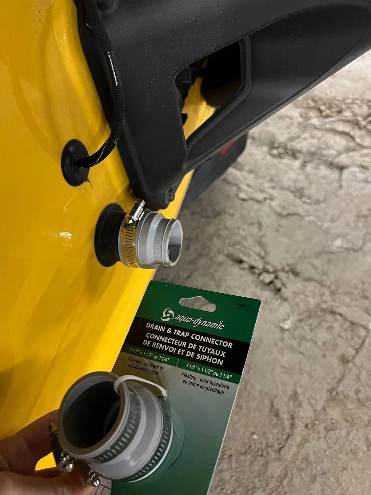

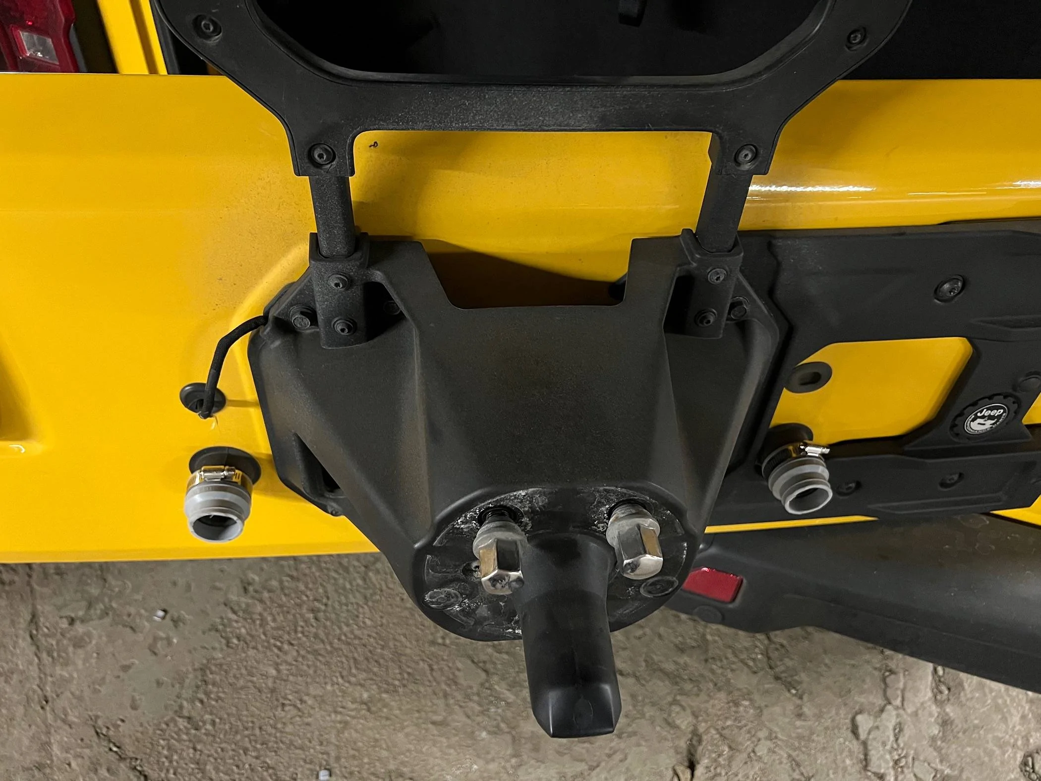

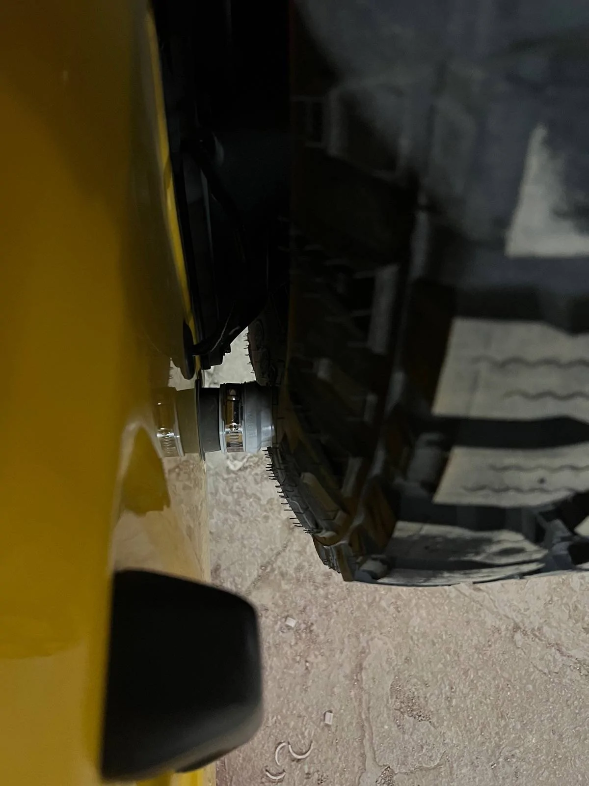

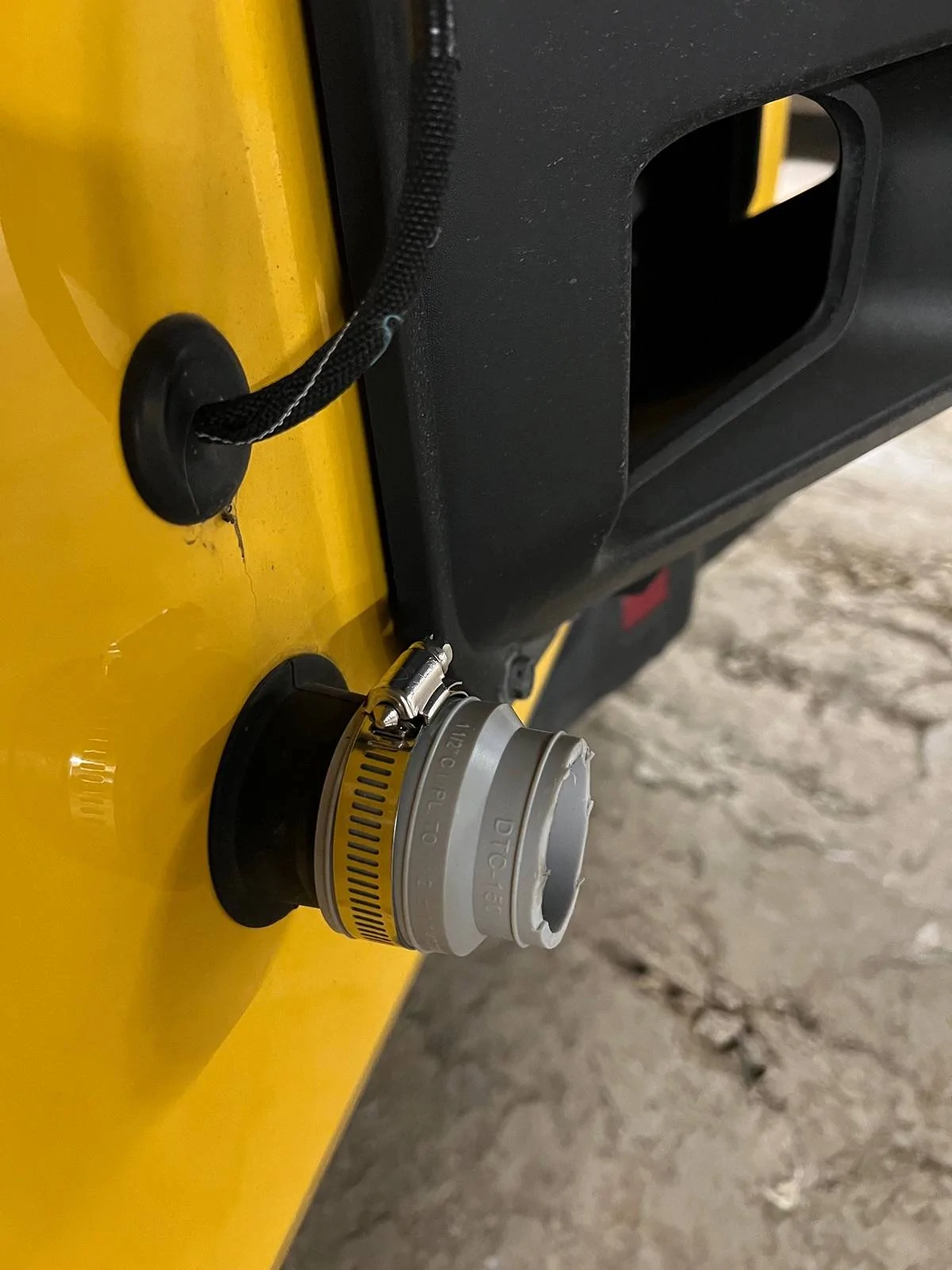

Thanks for this tip. They slipped right over the factory bumps and i trimmed them to the length i needed. It works great and was below $15 in canada.
