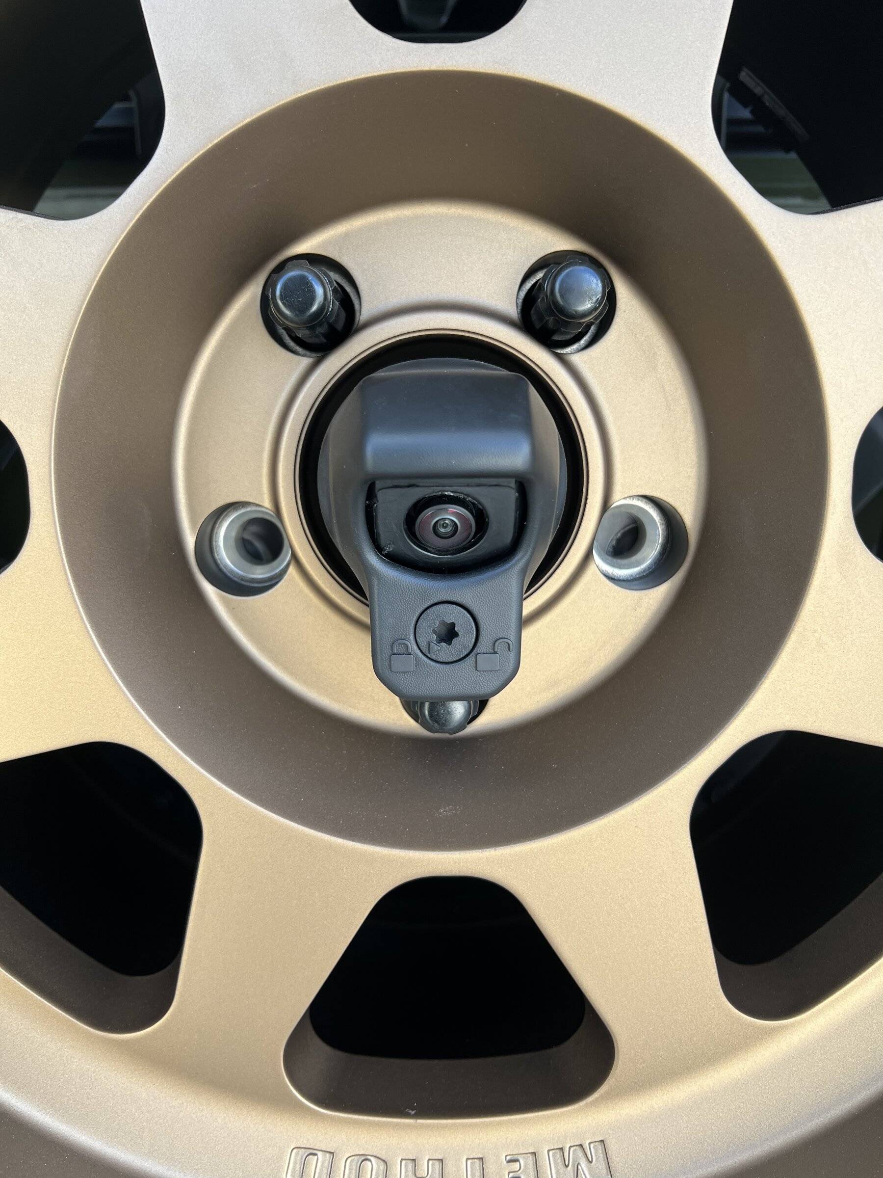

I’m getting Method 701s 17x8.5 put on tomorrow and just considered the 4.75” backspace/0 offset causing a gap from the tailgate bump stops with stock 285s and stock carrier. Anyone have this same set up? Did you buy something like quadratec/energy/daystar extensions? Don’t want a DIY fix. Also, did the rear camera bezel still fit? Just worry about the wheel/tire weight stressing the sheet metal on the gate.

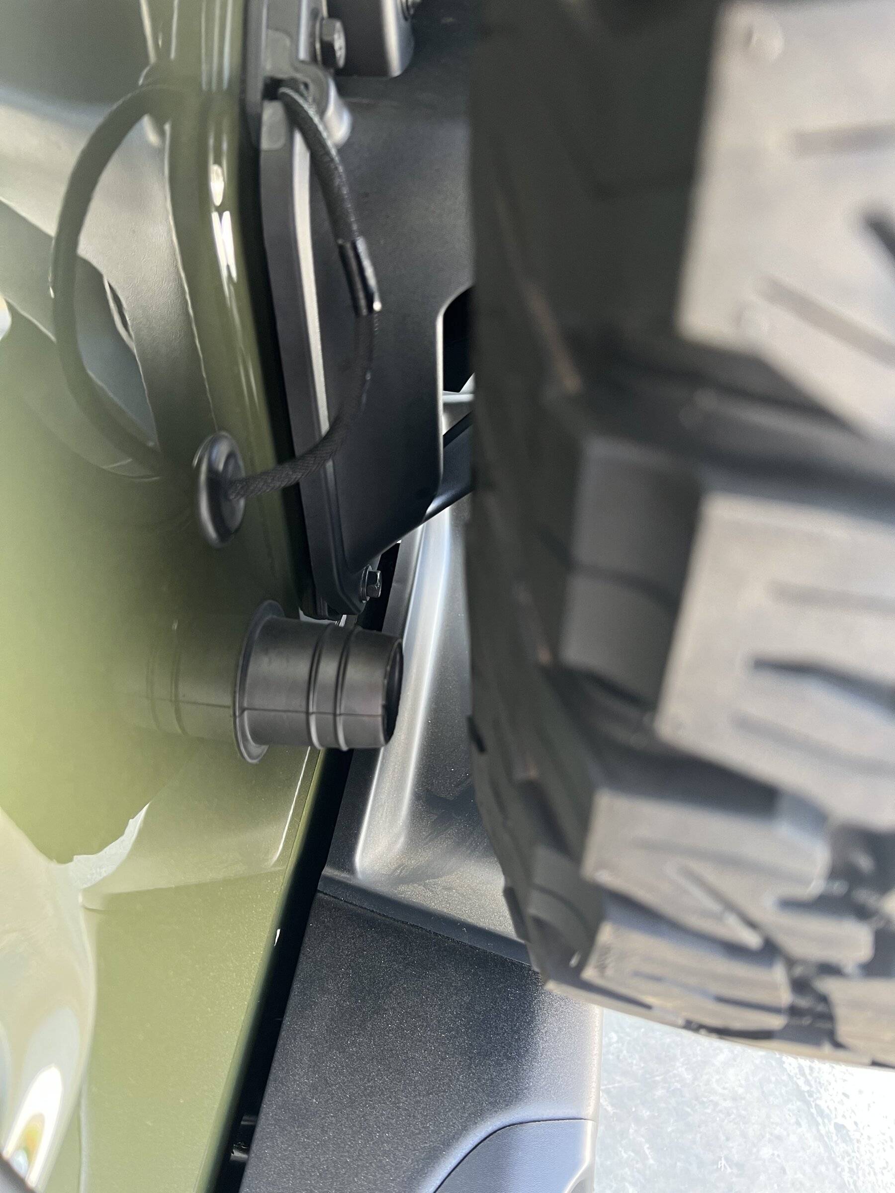

For anyone wondering, this is the outcome.
Jeep Wrangler JL Wheel Backspacing & Tailgate Bump stops C3A42118-BC1A-4FFF-B67F-966DCC9CC043
Jeep Wrangler JL Wheel Backspacing & Tailgate Bump stops EC49504F-CABB-4352-89AE-C02C6F7AAF2F
Jeep Wrangler JL Wheel Backspacing & Tailgate Bump stops C3496332-6778-4582-A304-66C17D766E16

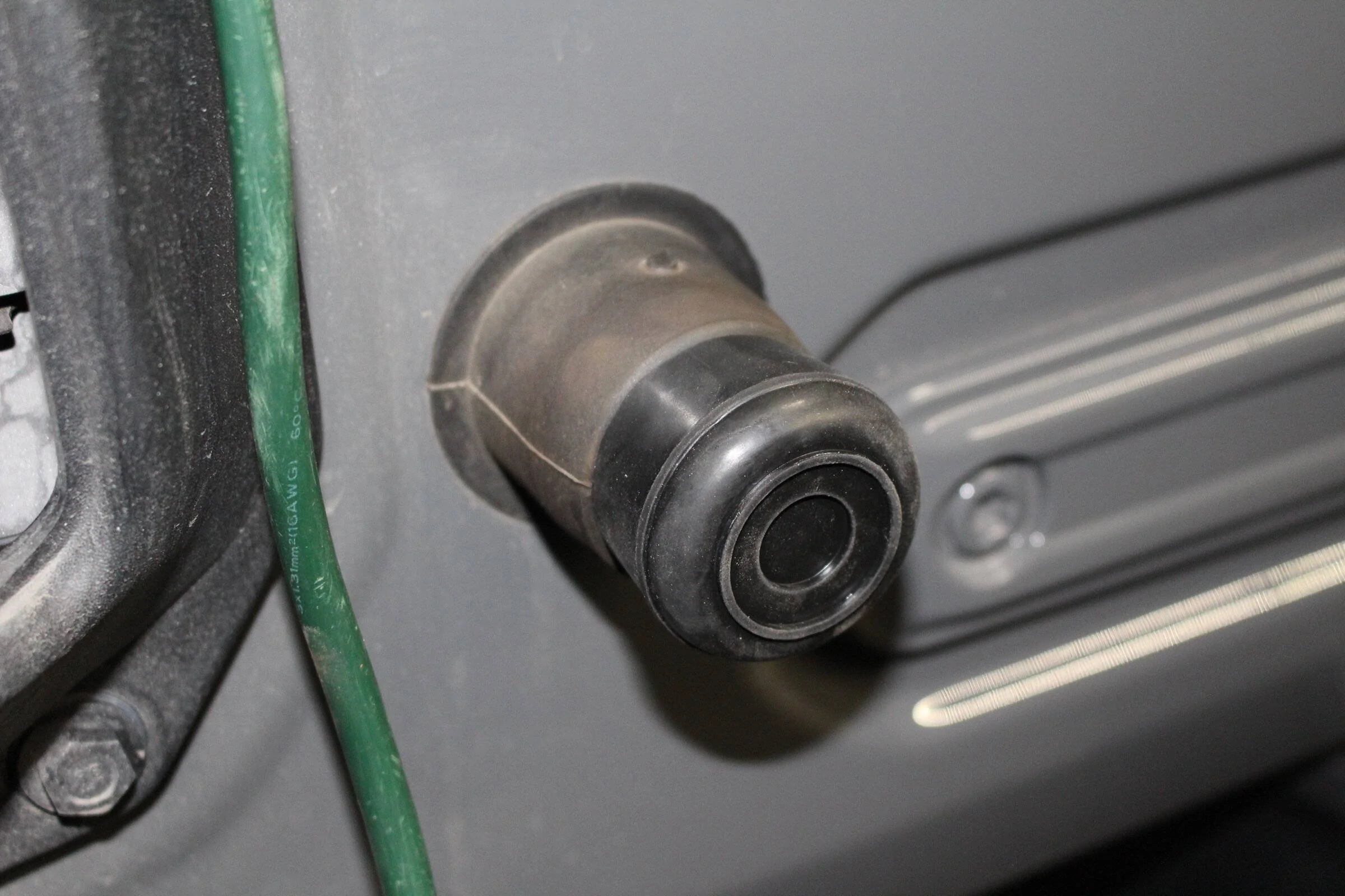

I put a couple of these on her JL after we got a set of Mayhem 8015's on 35" RG's. Stock carrier with factory tailgate reinforcement:
https://www.amazon.com/gp/product/B004Y75VWW/ref=ppx_yo_dt_b_asin_title_o06_s00?ie=UTF8&th=1
And I went with the Teraflex carrier on my JL with a Mopar beadlock accessory wheel and a 37" KO2. I really like the fore aft adjustability. My tire is closer to the tailgate than hers and you get the rubber snubbers right up against the tire.

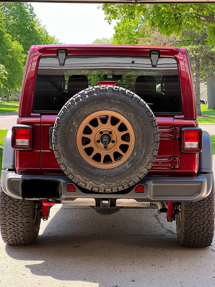

Method 703 +25 offset and KO2 315/70R17 here… engages stock spare tire stops properly. Actually tried longer ones but they prevented the spare to seat onto the carrier.
Jeep Wrangler JL Wheel Backspacing & Tailgate Bump stops 863927F2-9DC0-47B4-8970-BB1FCE35D2BE
