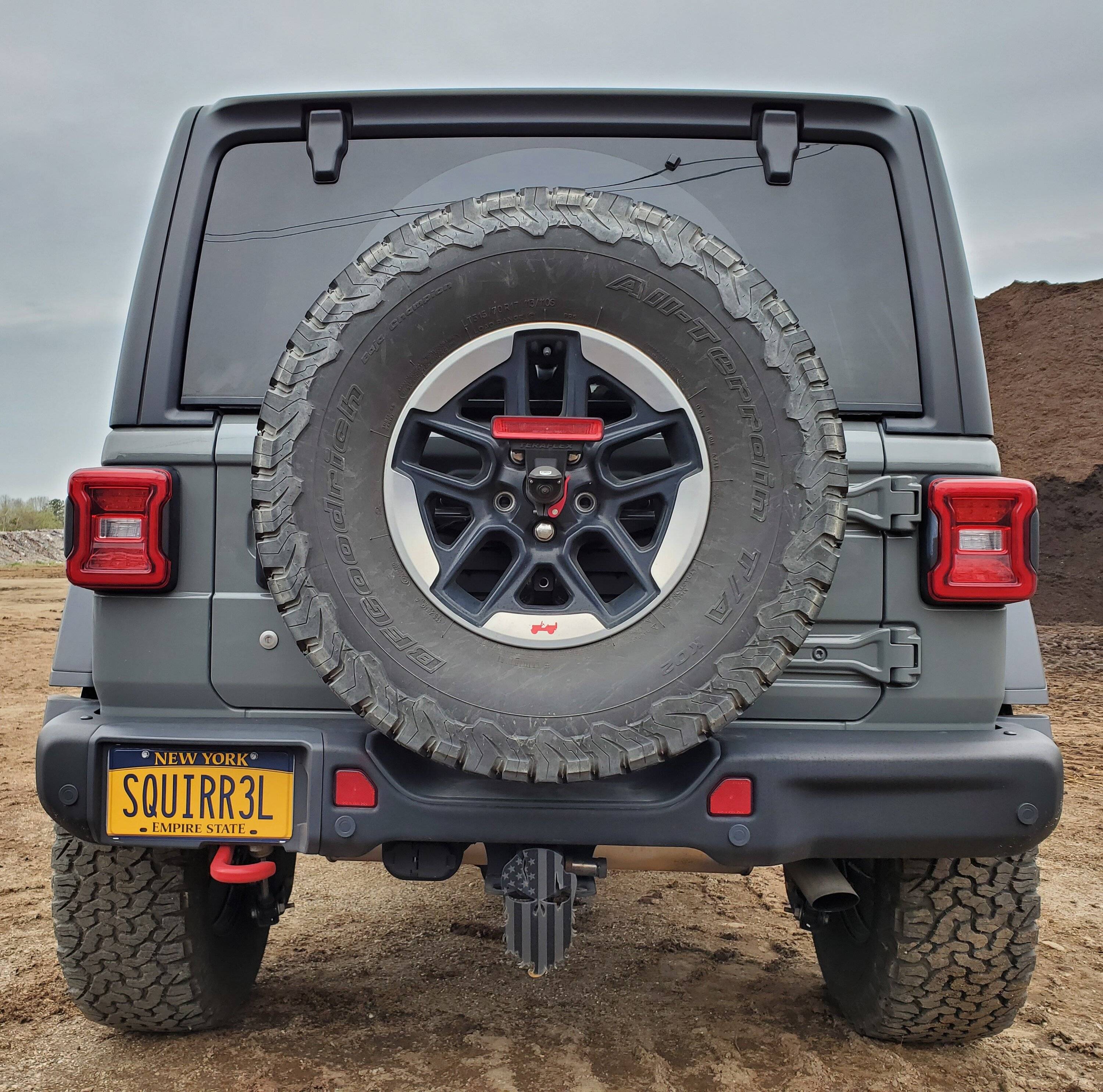

The only real proper solution, that doesn't fix one problem while adding another, is an adjustable carrier. If sticking to 35's or smaller, I highly recommend the Teraflex Alpha HD carrier.
The Alpha has 3 height positions to properly clear the rear bumper. This is important, because the bumper is hard mounted to the frame, whereas the body is mounted to the frame via rubber isolators. This gives the body and bumper the potential of being able to move independently from each other. If the spare is contacting the bumper, that independent movement will transfer unnecessary stress to the tailgate.
The Alpha has a horizontal slide adjustment to account for a broad range of wheel and tire dimensions. Being able to keep the spare as close to the tailgate is important. First off, it minimizes the cantilever affect. The more a given weight is cantilevered, the more amplified its stress forces will become. Secondly, having the inner sidewall of the spare pressed firmly into the rubber tailgate bumpers will minimize rattles and shakes. Those unwanted movements could possibly be damaging over time, or at least drive you nuts from hearing that racket caused by every crack in the road.
Here's a pic of the Alpha carrying a 315/70-17 bfgoodrich ko2 and set to the highest position...

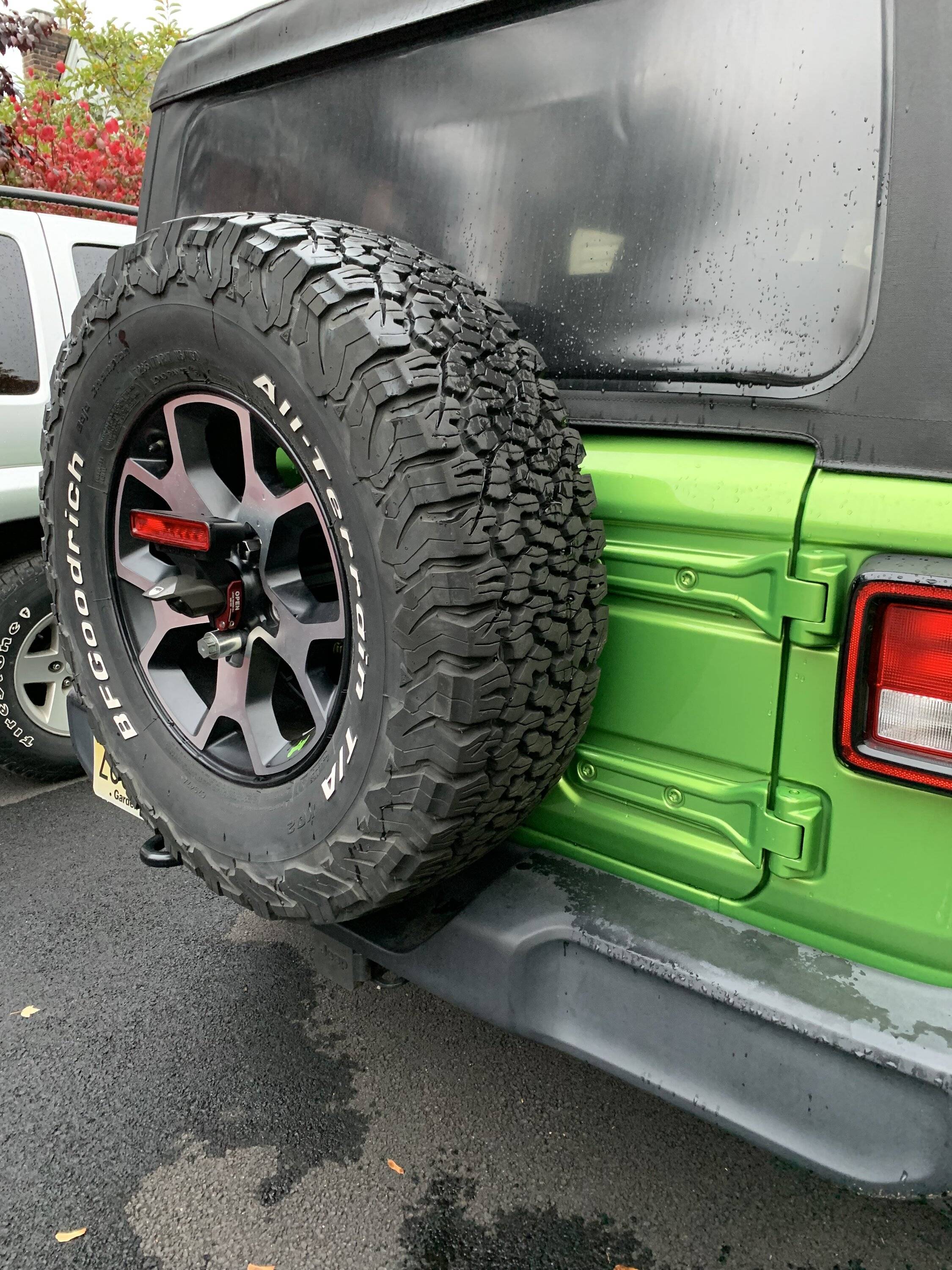

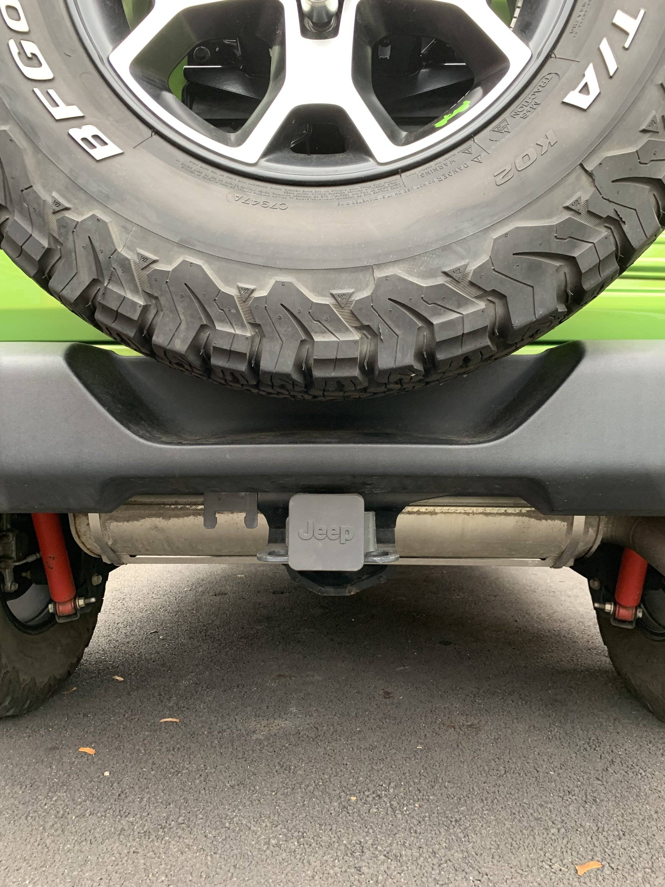

Figured I'd bring this thread back, because I finished the install over the weekend. Here's the Teraflex Alpha carrier with the studs set to the middle position and a 285/70 KO2 tire. Plenty of clearance at the bumper now; before, it was actually resting on the bumper with the stock Sport tire carrier. This carrier is awesome, and the view out the window is actually better than before since it gets rid of the plastic bracket that the brake light sits on.
