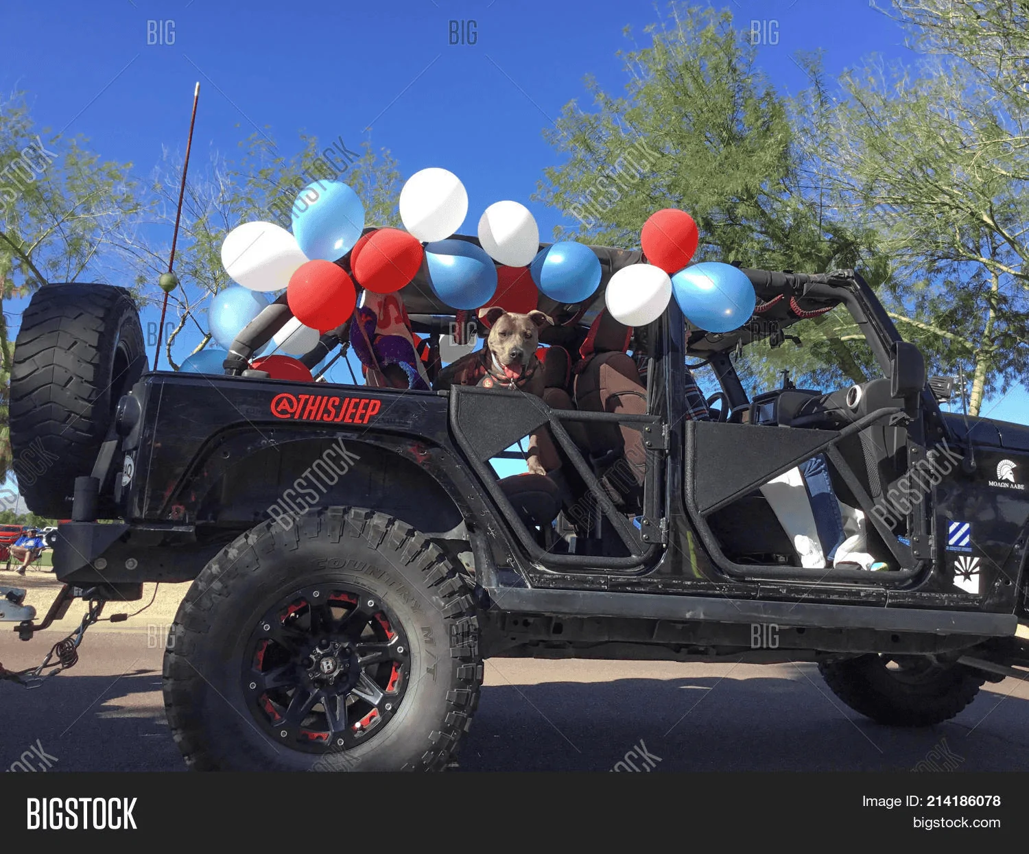

But seriously, 35s are a smidge too large for a Sport without a lift. Generally fine but they will rub at full articulation.
Where are they rubbing? If it's on the top or the lower lip of the fender, you need a lift or a higher fender. If it's rubbing on the side toward the center of Jeep you need longer/adjustable control arms (like the Jeep in the pic above desperately needs).
