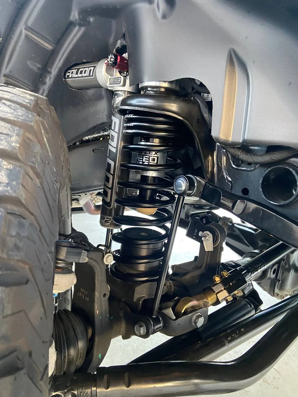

For whats its worth, im an old guy with 50+ years of expertise with moderate builds for overlanding and rock crawling in the sierras (6 hour drive) .. my most recent Jeep builds started in 2018 JLRU with Mopar and factory Fox jeep 2 inch kit installed by the dealer.. long story short, after 5k miles all shocks leaked.. and years of chasing death wobble and fighting FCA at every step in the way..
Once i got past all the lemon law stuff.. it was back to basics, a couple of 2024 2 doors and studying the market.. lots of options, but if your trying to keep your Jeep to the basics I found Trail Recon you tube and my local club (Point Mugu CA 4x4) to prove and demonstrate the value of "matched" multi rated springs and shocks are the most important thing to consider, especially if you are often changing the weight - use case of your target operating environment (sorry engineering geek on display).
EVO with Kings and Terraflex a were my final down select as well, But Terra flex won me over on the multi rate springs, shock adjustability (I go from sand beach weight = 4k lbs to 5k lbs 2-week overlanding with M416 trailer), adjustable steering stabilizer and the hydraulic bump stops..
I did use the EVO lower control arms (LCA), as those are beefy and fix the death wobble (>5 degrees) at the recommendation of Go Big in Ventura CA (great team!)
FYI: no need to spend $ on a whole kit... LCA is all you really need with <3" lift and with Teraflex you will get an honest 12" travel thus 630 RTI rating.. only rock buggies go higher than that and i guarantee they spent more than me (<$3K)..

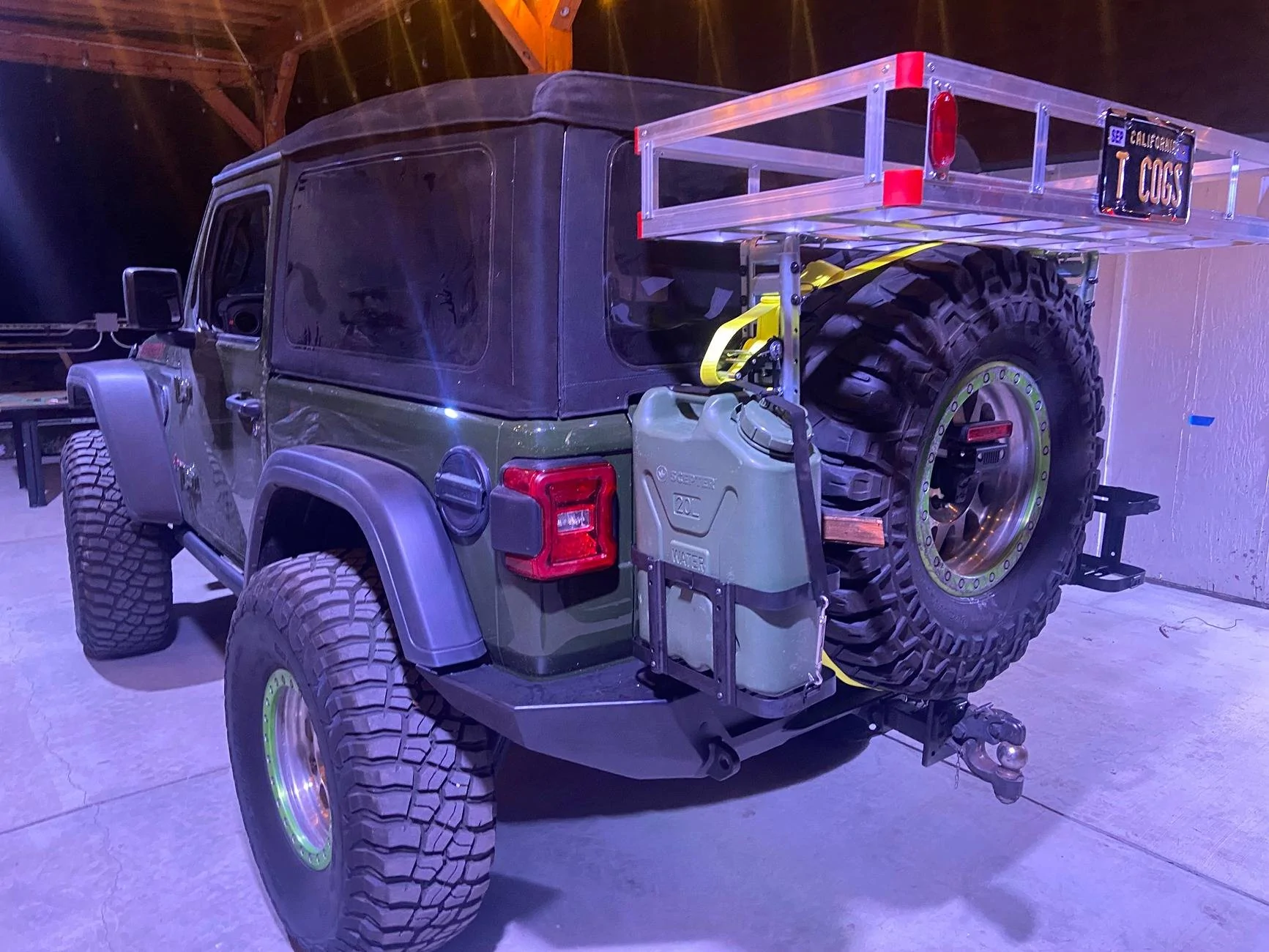

I went with EVO, front LCA and drag link only.. all the other pieces are just fine.. and after running Fordyce last week it all worked very well.. Loaded to the gills for a weeks off grid camping, then when base camp was set up, i removed all the gear and hit and made every winch hill obstacle.. Fordyce trial in MHO, has the toughest obstacles i CA. Fordyce Jeep Trail, California - 70 Reviews, Map | AllTrails
My next thing to add back (was on my 2018 JLRU) is the Ram 1500 HD air springs to help with leveling, as you will see the 2-door is really weighted down and sagging, but when the weight is removed it is raked the other way..
