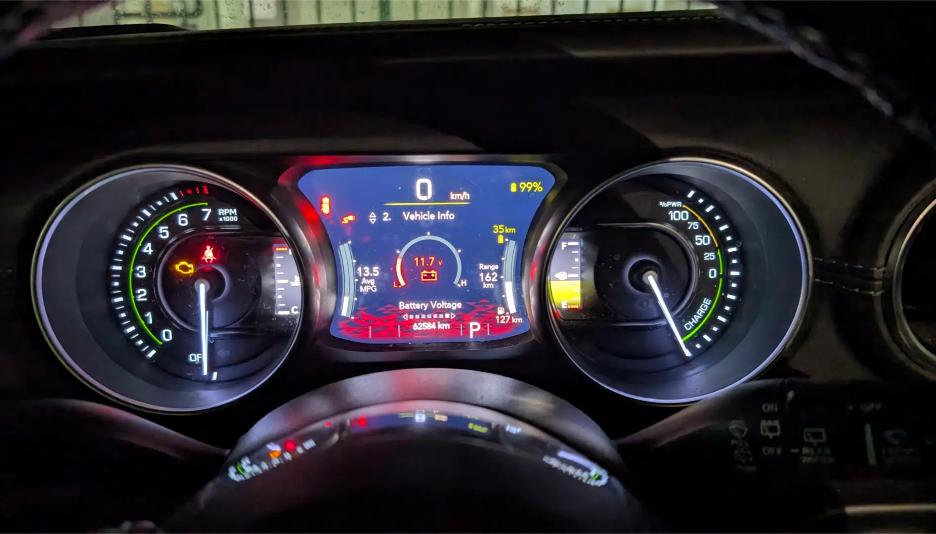

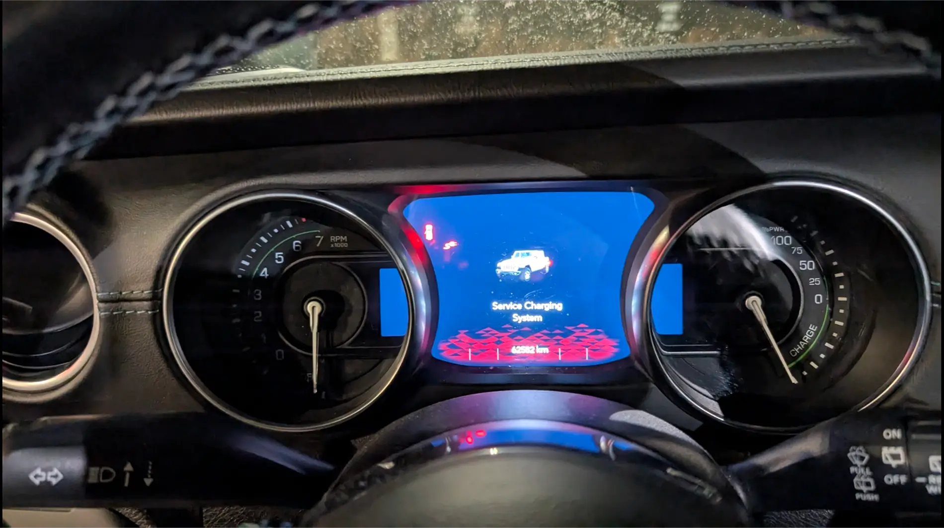

When the HV battery fails the behaviour seems weird. From what I've seen people say in the past, some say the 4xe disables the max Regen, and some other hybrid functions. I think they call it isolating the HV battery.
When my 4xe HV battery failed it started by firing up the gas engine, then I drove it home a mile away.
I tried starting it the next morning at 8am it wouldn't start.
A few hours later when the tow truck showed up it started up the gas engine, seems like it might have run for a bit, how long not sure.
I didn't take a picture when it started up when the tow truck came.
All in all, mine is a city vehicle, I can deal with some downtime with a rental, just happy I have it back, I just hate buying gas for a non Wrangler rental, I don't mind buying gas to drive a Wrangler, but to buy gas for a non Wrangler, is adding insult to injury.
This is when it initially failed the night of January 19 - 7:33pm
Jeep Wrangler JL EV Battery needs replacement 1000033343
Next morning January 20 - 8am
Jeep Wrangler JL EV Battery needs replacement 1000033344
