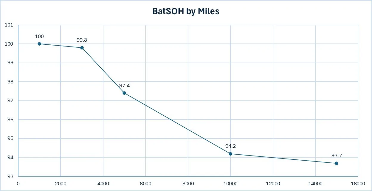

b/w anyone tracking what their SOH was when you needed a replacement? the general consensus is around 80%

HV Battery State of Health. You can find it out via JScan or similar tools
I maintain a chart like this
