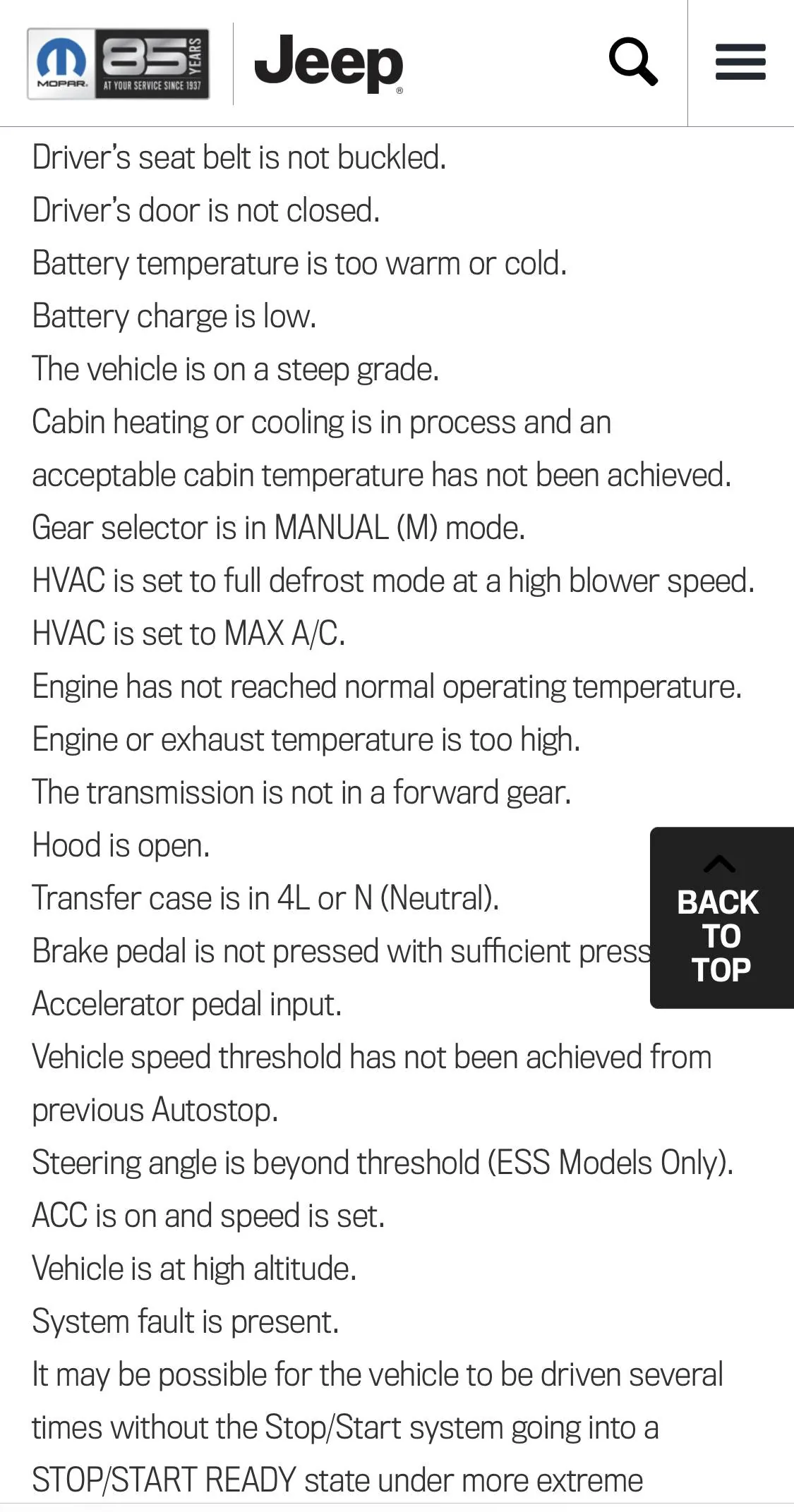

I would wait; Just from what I read on the internet (Yeah, right) actually on this forum. There are an easy dozen parameters that must be green before ESS works. I have read they include things like reached set temp in cabin, and other arcane things. Try a search here. Hopefully others more knowlegable will comment. Good Luck.

I saw a video by Jeep saying you can call up the ESS screen in the dash and it will tell you what conditions are not met.
Exactly. With no CEL light, scroll thru the screens and find out exactly why ESS is not ready.
