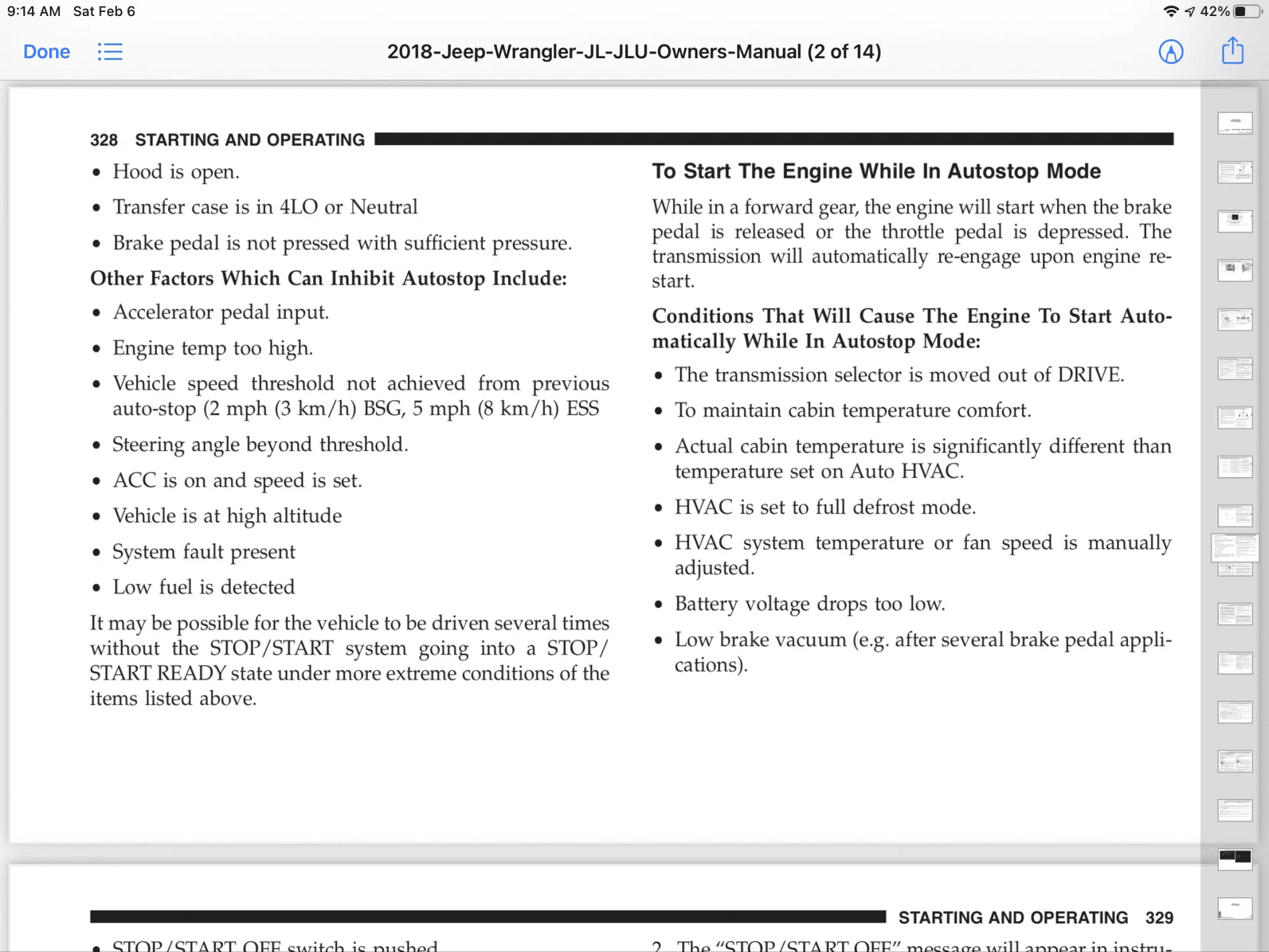

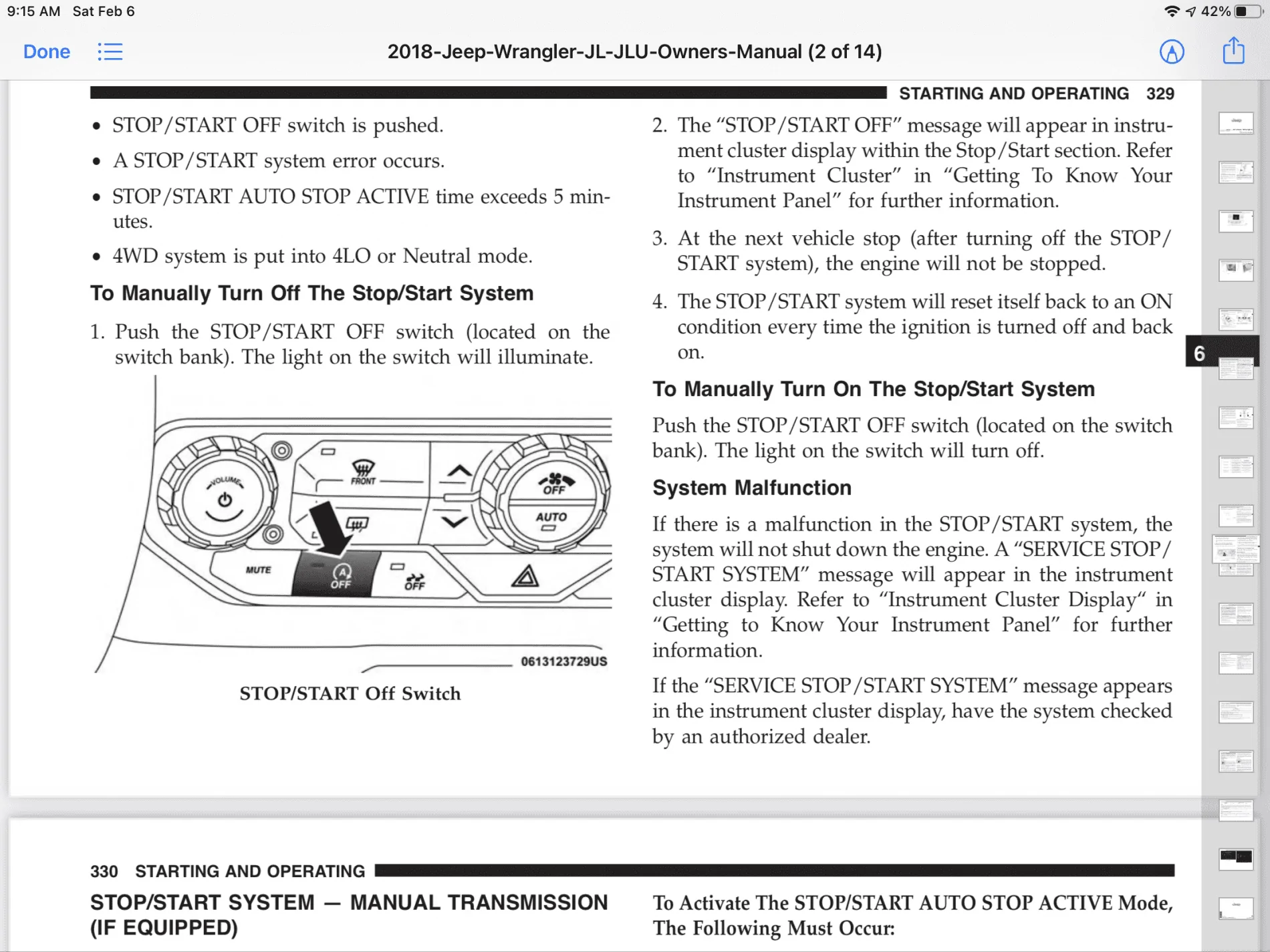

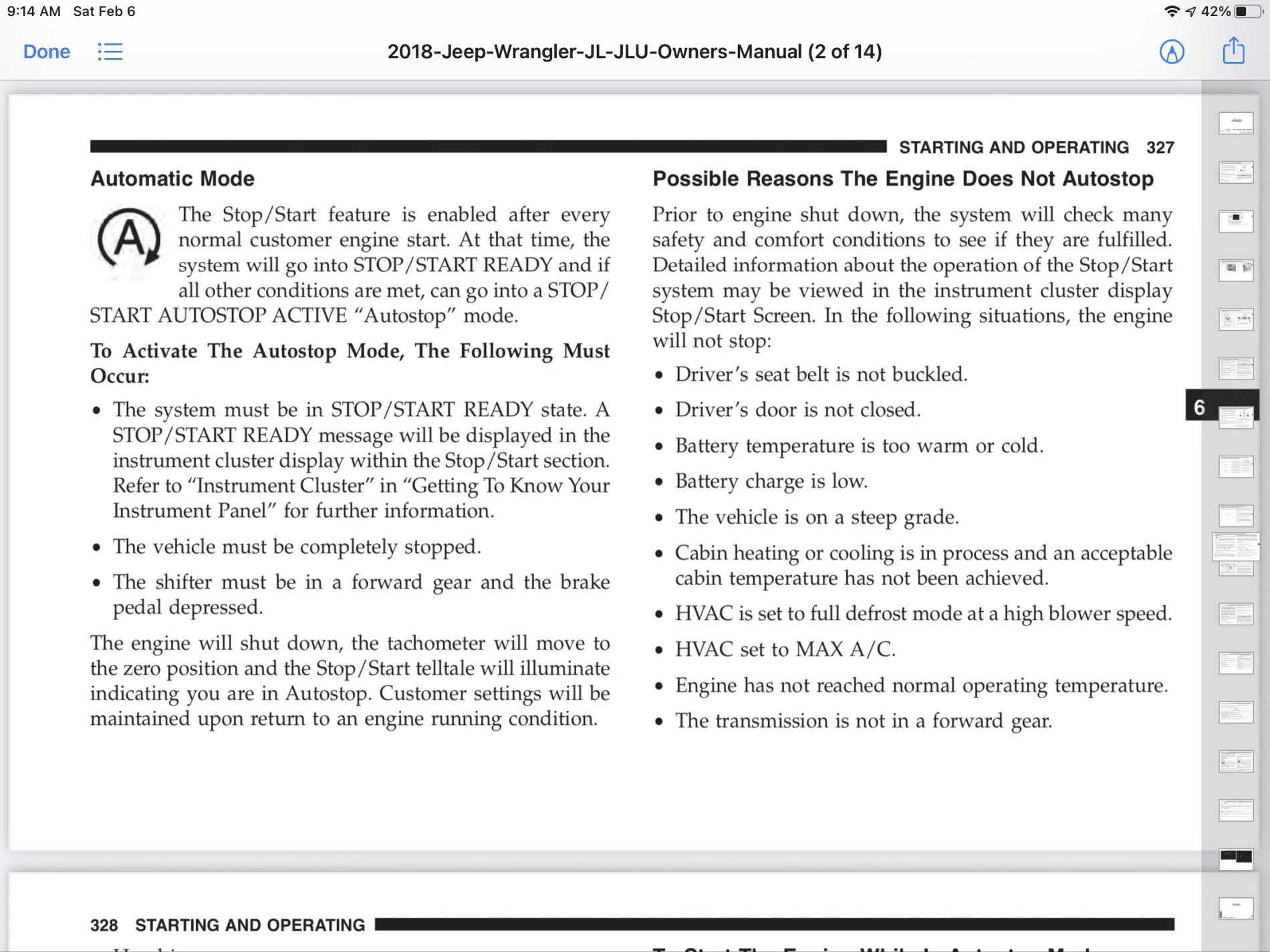

Here is some info from the manual, also if the ESS EVIC display advises not ready due to battery charging not a good sign and as stated if under warranty have dealer address after addressing since it’s a 2018 as stated you can have the TSB applied as @Rhinebeck01 advised and this will address the issues if the ESS battery dies and it won’t leave you stranded, there are lots of additional options one can take to address this poorly designed system once its up and going and a simple search will divulge lots of options and you have to decide what works for you.
