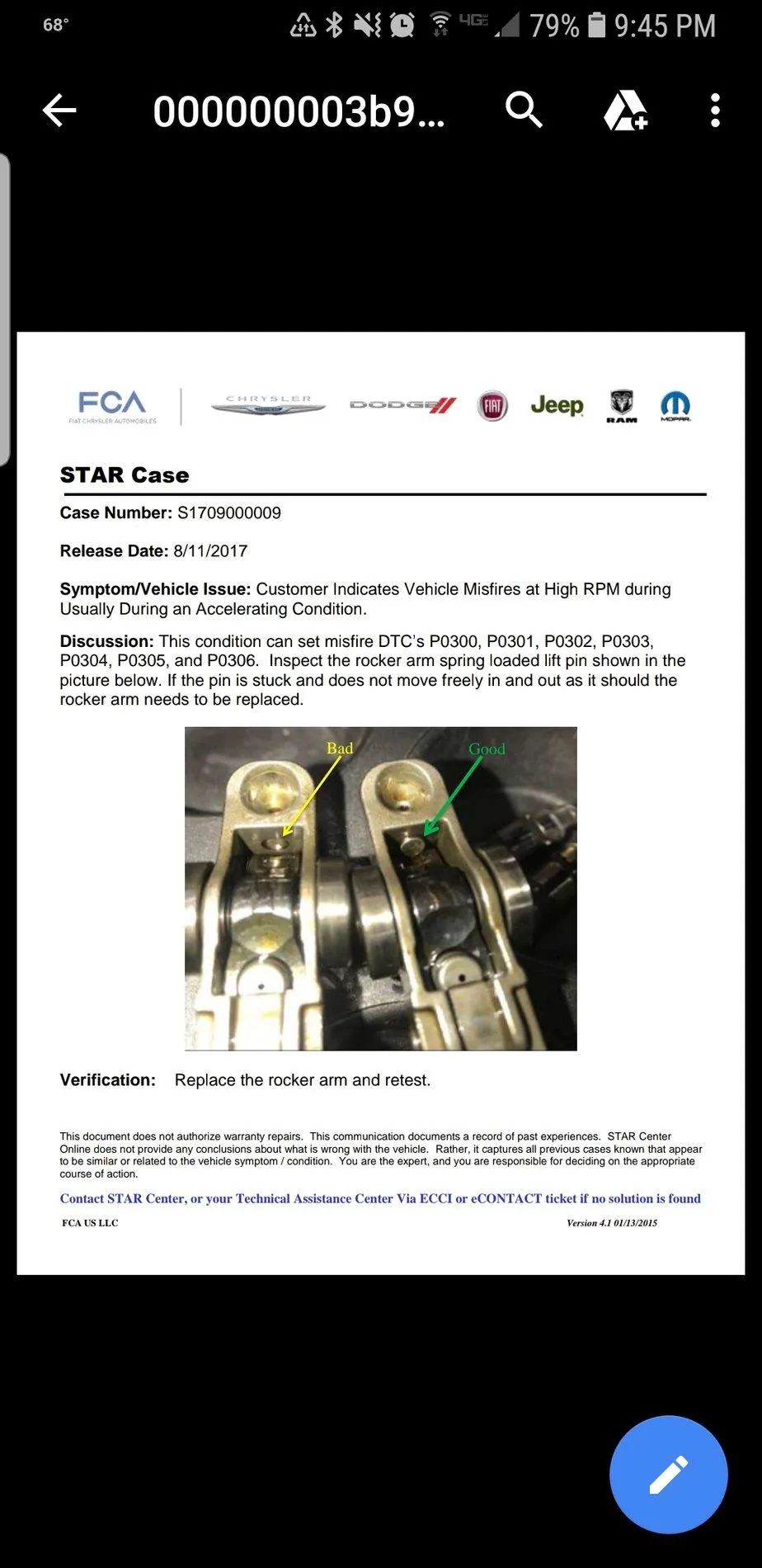

Theres a star case for the misfire.
Jeep Wrangler JL ESS and flashing CEL Screenshot_20180620-214516_Driv

First I've heard of this! Thanks! Do I just give them this info?

You can, it's not an definitive answer to your problem. It's a good place to start.
I wouldn't drive the Jeep until it's fixed. They can provide you a loaner or rental at no cost to you.
