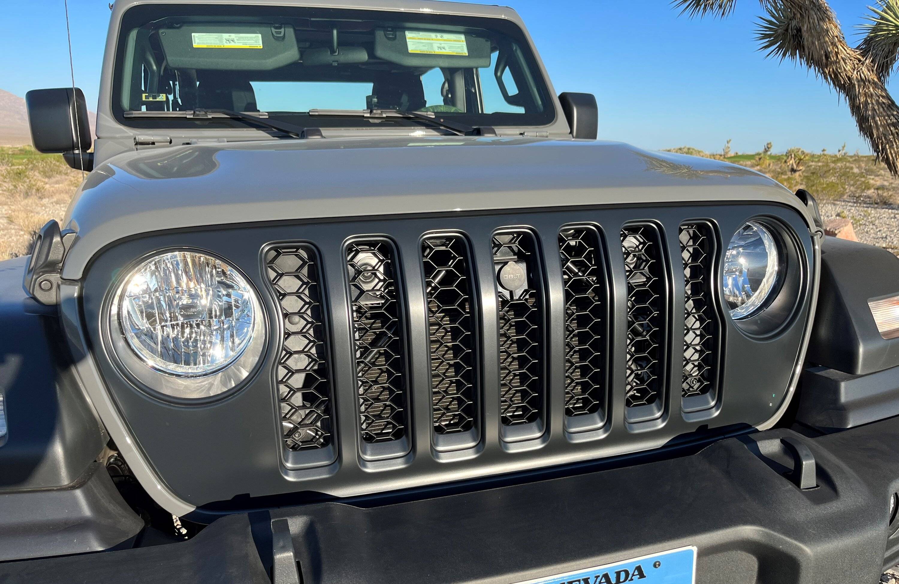

So...after reviewing several forum discussions on the potential benefit in engine cooling with the wider JT mesh, I decided to try it out for myself. I was able to do a pretty accurate comparison between the JL and JT grilles by driving with each on the same road at the same speed (70 mph) for the same amount of time (30 mins), and with the same outside air temperature (87 degrees F) and environmental conditions.
In both cases, the engine oil temperature in my 3.6L eTorque topped out at 226 degrees F. While a little disappointing, I realize these are only two data points, and won't conclude that there is/isn't a benefit with the JT grille. Just wanted to share my experience since there doesn't seem to be much data available for this grille retrofit. Curious if others have tried the same thing and can share their observations. Thanks in advance and happy Jeepin'!

I'm guessing you would need to be working your vehicle extremely hard to see any tangible difference. Like maybe towing uphill in 110 degrees.
Or slow speed rock crawling in 90+ degree temps.

Good point. Assuming that's the case, I'm still glad I did the conversion, since I occasionally do slow-speed offroad stuff in 100+ degrees here in Southern Nevada. Last time I was out on the trail, outside air temps were brutal at 109 degrees.

haven't we already seen testing where the grille was removed completely and there wasn't any appreciable difference?
and haven't we seen that these things create the highest temps when under load at speed?
(i know i've crawled all over in triple-digit speeds and not seen temps as high as when moving at speed.)
after playing all kinds of games with my other J**p in search of better cooling, i wouldn't think there's going to be any better improvement found than by using a better radiator.

Apologies for my ignorance, but no, I don't think many of us have seen this testing. I know it wasn't addressed in the forum discussions I read, so I'd be interested to see the data and how it was collected.
As you stated, I think we all can agree that a better radiator will result in better cooling. However, not all of us really need to make that modification, given our different use cases. I'm just trying to document actual comparative data for the JL and JT grilles, since it seems to be a popular topic here in the forum.

Anyway...we know that FCA made a deliberate, conscious decision to widen the grille mesh for the JT. Even though I didn't observe any benefit in the mode of operation and test conditions for my science experiment, there is probably some combination of these factors where the improvement is apparent. As stated previously, perhaps under a heavy load, low-speed offroading at high ambient temperatures....maybe something else?
