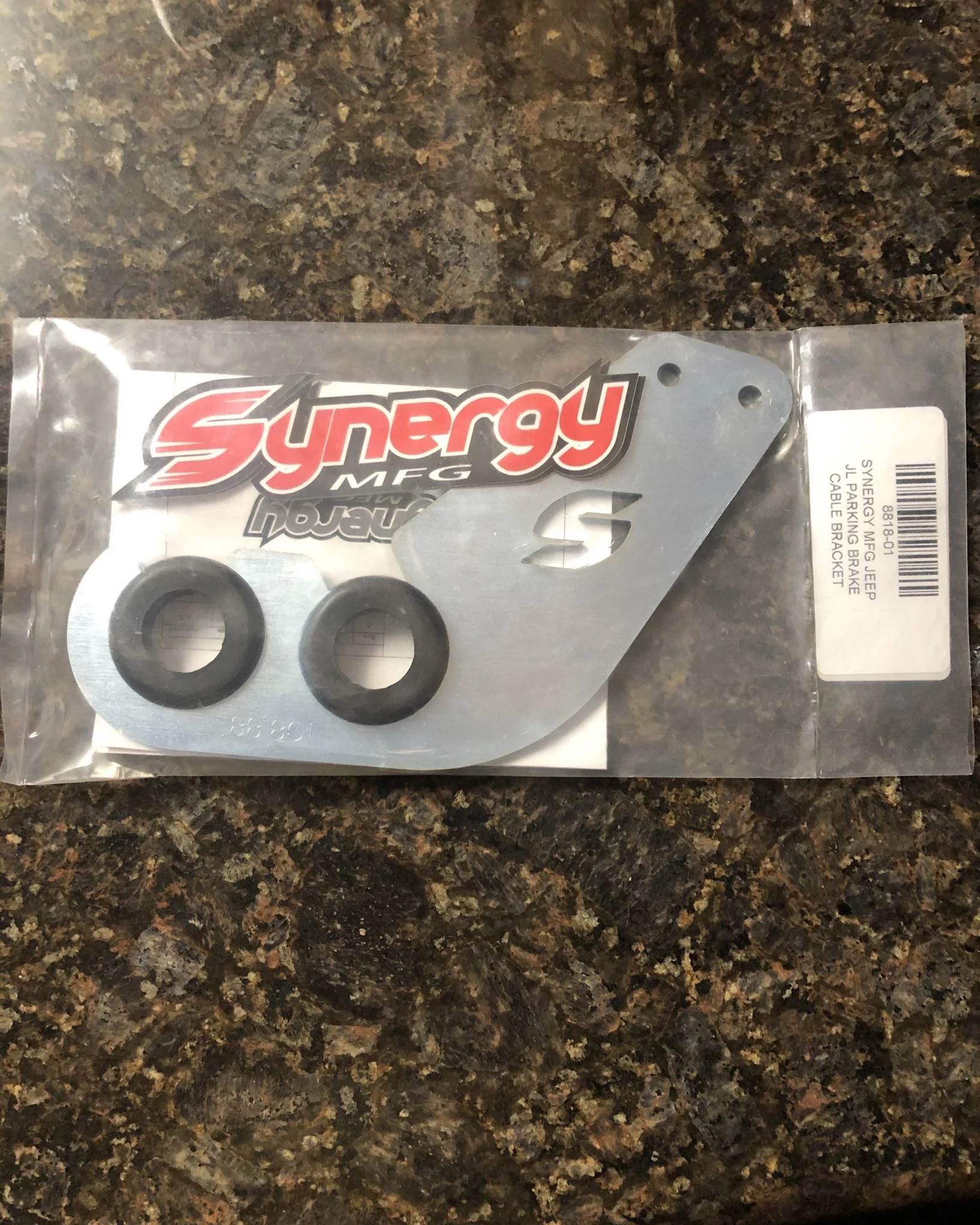

I ran without the bracket for a while too, until I noticed my E cable was melting laying on the diff, lol… if you don’t use a bracket, at least keep them off the diff with something……..
Did you have any issues after installing the bracket? My cables are still gently touching the diff/axle. I was thinking of maybe wrapping them in heat shield tape maybe?
No, after I installed the bracket they didn’t lay on the diff anymore, maybe slightly touched it, but not melting like before…….heat tape would probably work. It was just the outer protective sleeve that melted, the actual cable sheath underneath was untouched…..

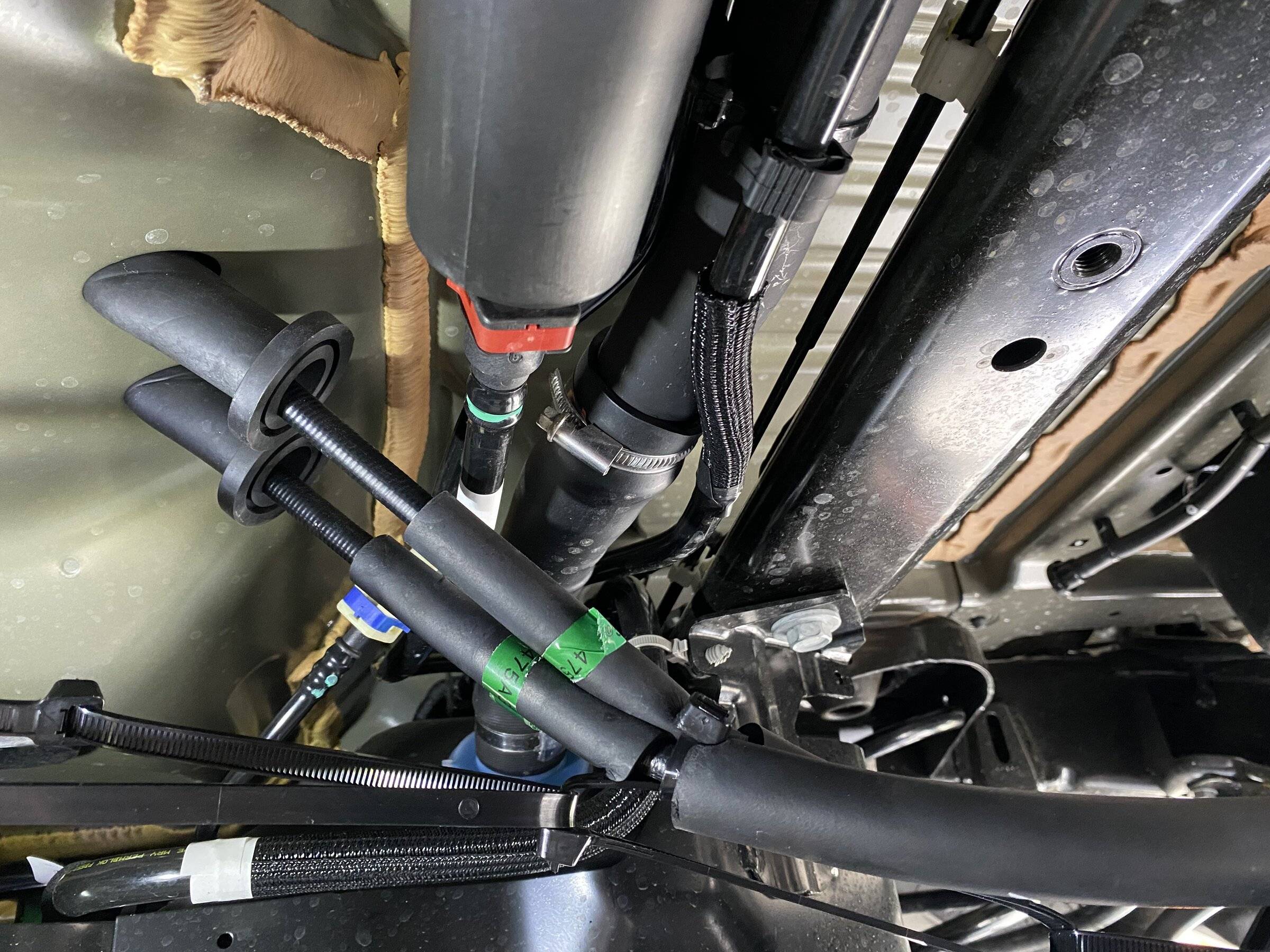

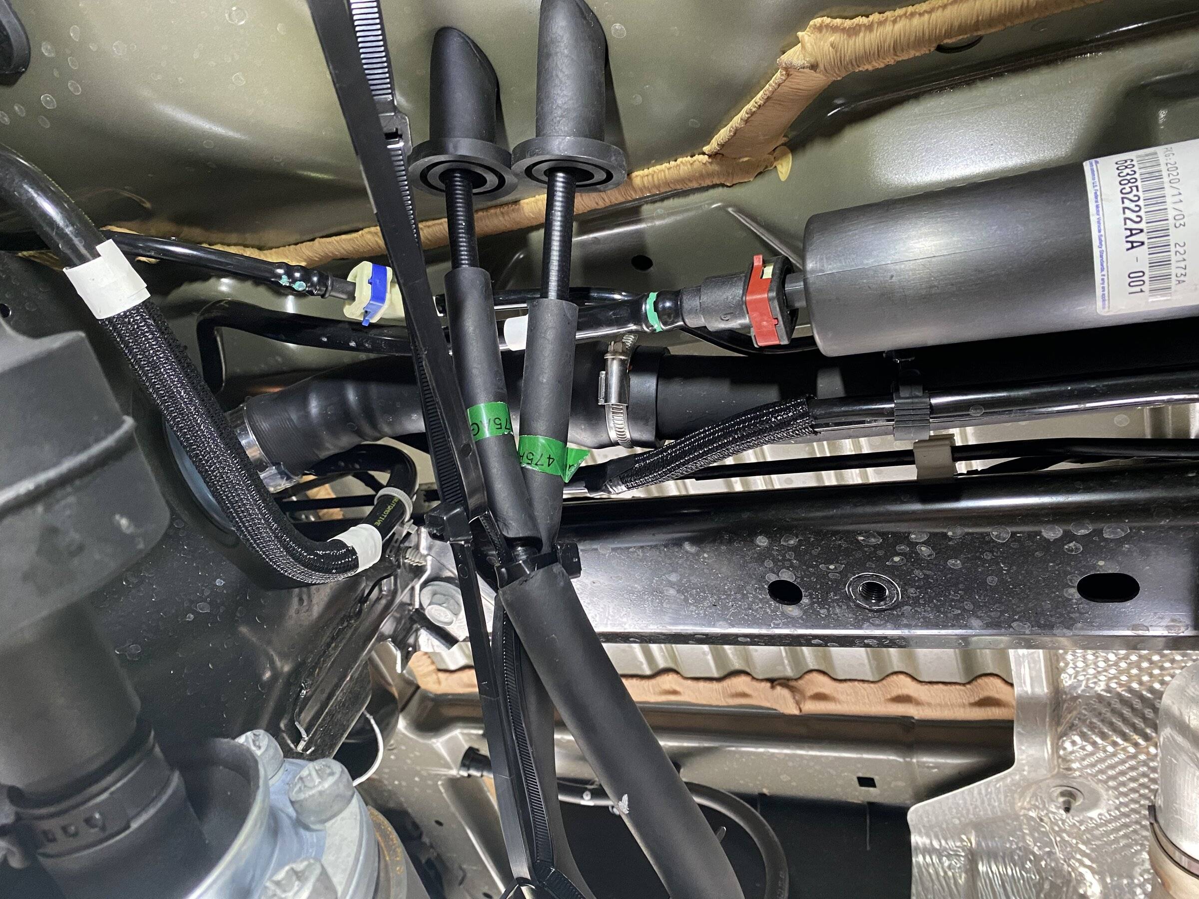

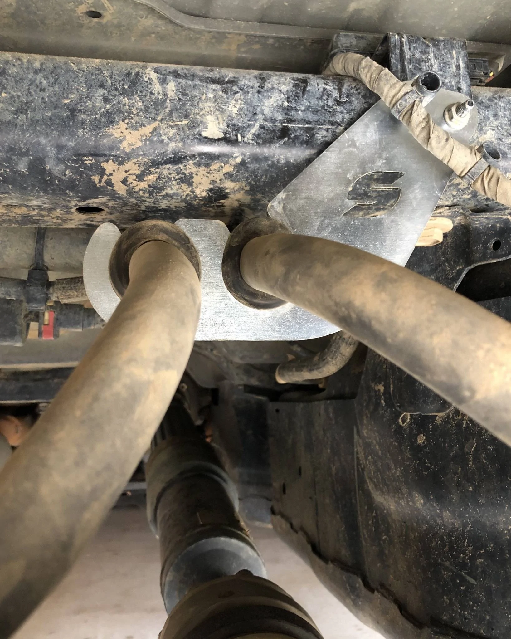

New Jeep, new problems. I rerouted and now the cables damage the evap system (vapor tube). Dealer made an awkward zip tie system to get it back home after repair, but now I meed a permanent solution. Any ideas?
Jeep Wrangler JL ebrake cables (re-route?) C1E7E65D-E35E-46D3-ABDC-0A6EDC311859
At first I thought maybe a MORE skidplate, but it doesn’t protect the part the parking cables contact.
Jeep Wrangler JL ebrake cables (re-route?) 9E2E25AB-9B81-4DB9-8C5D-2CAD6330C206

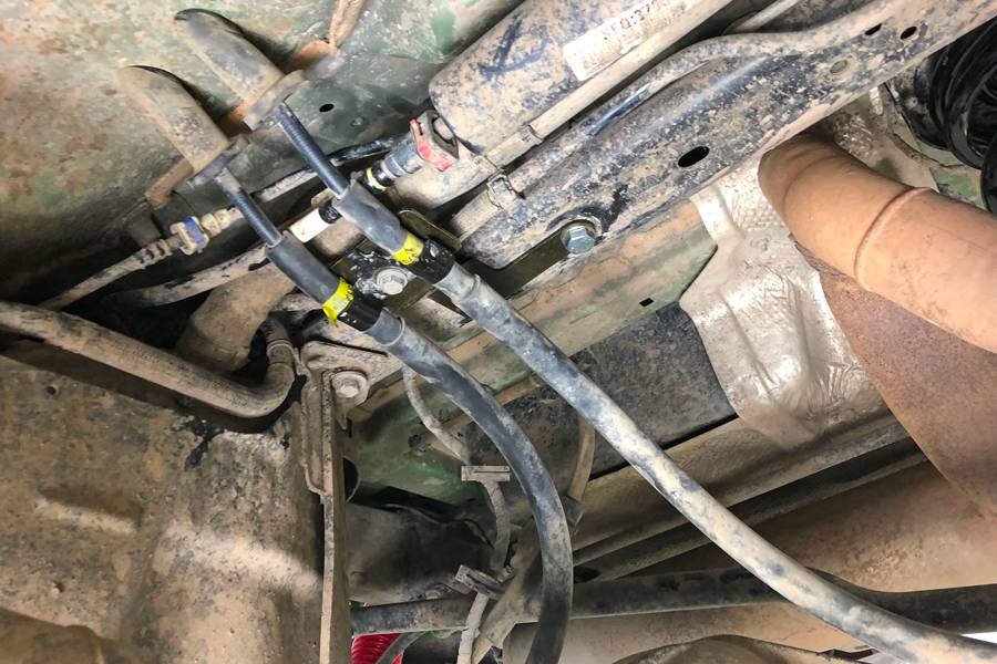

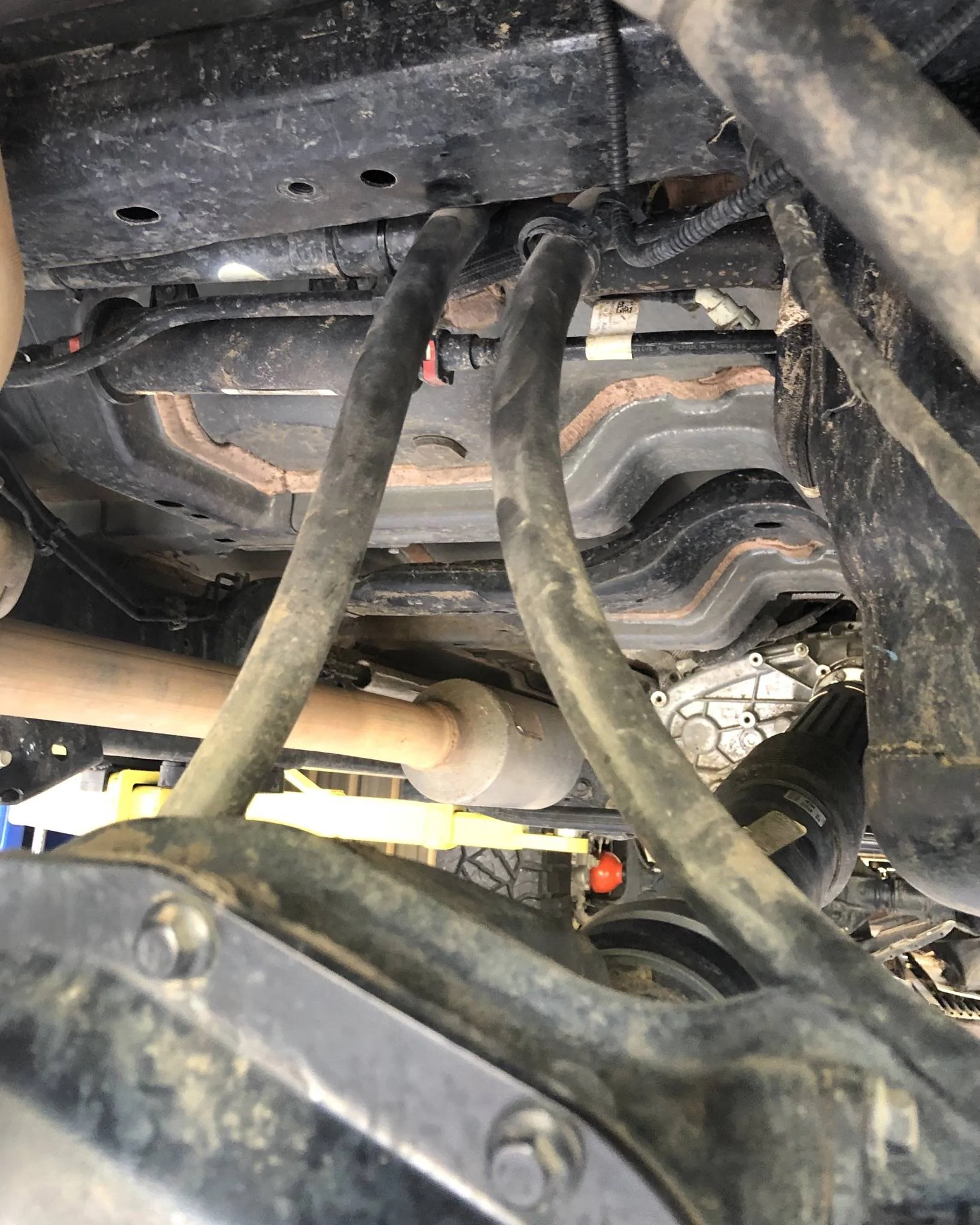

The problem is your under those lines , you should be above them, but under the frame.
Jeep Wrangler JL ebrake cables (re-route?) D1ACF5A4-D23A-46F2-97D0-12A9E81E283C
Also get one of these, it helps a lot…..
Jeep Wrangler JL ebrake cables (re-route?) C8FCA083-D055-452A-A1D8-3D53EE660C65
Jeep Wrangler JL ebrake cables (re-route?) 93532B63-6185-4D60-8214-B3E57C1932B1

I routed them back over the evap canister. Hopefully it doesn’t pull it apart at full droop.
You should be good, my rear tire drops out to 33” no issues…….

I routed my ebrake cables UNDER the evap vent tube. Is this going to be a problem? I spend quite a while getting the ebrake cables back on the eyelets and really don't want to do that again. I see where the previous post mentions to route them under the cross member but above the evap tube.
