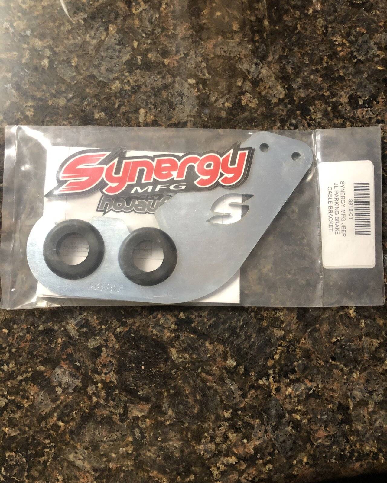

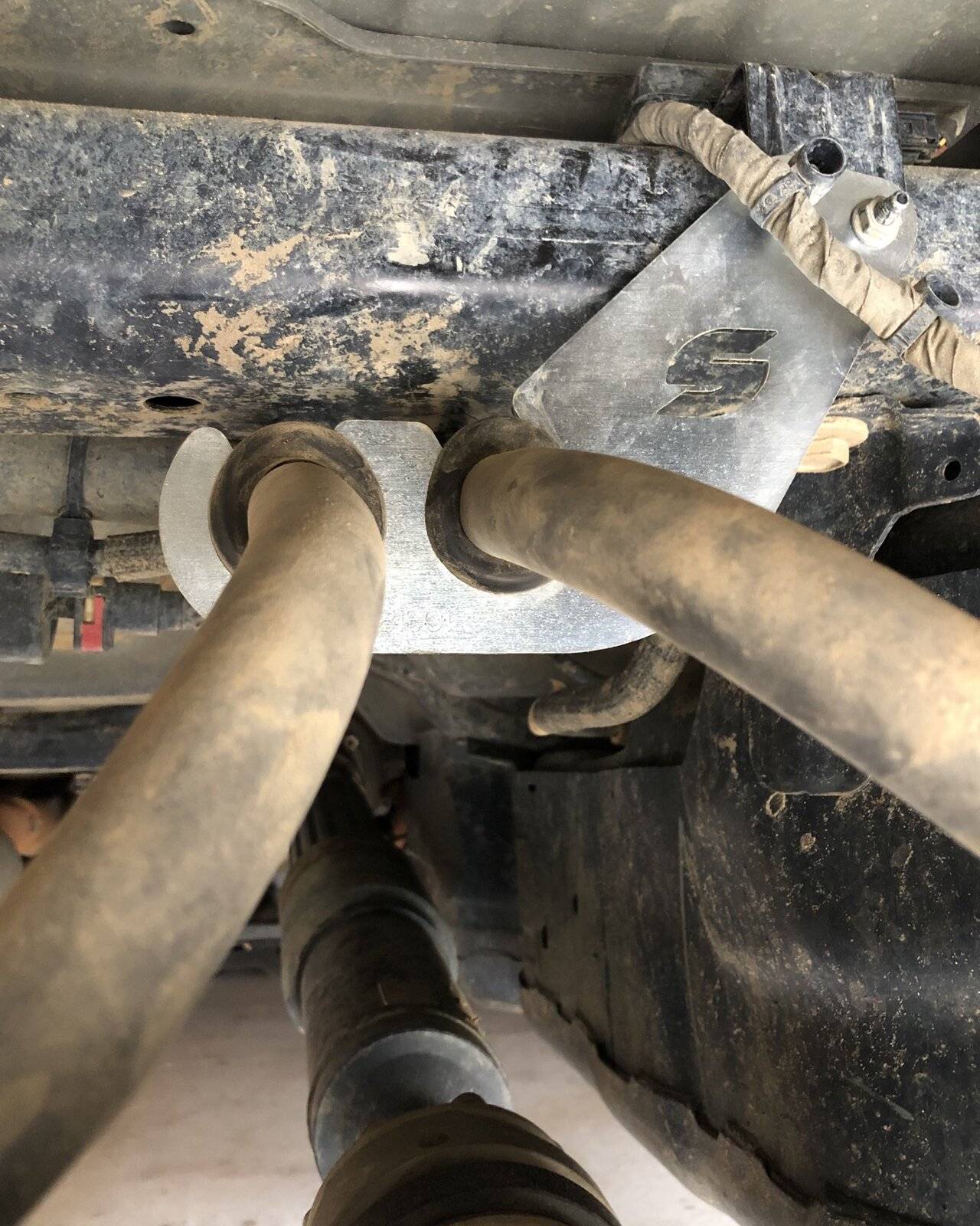

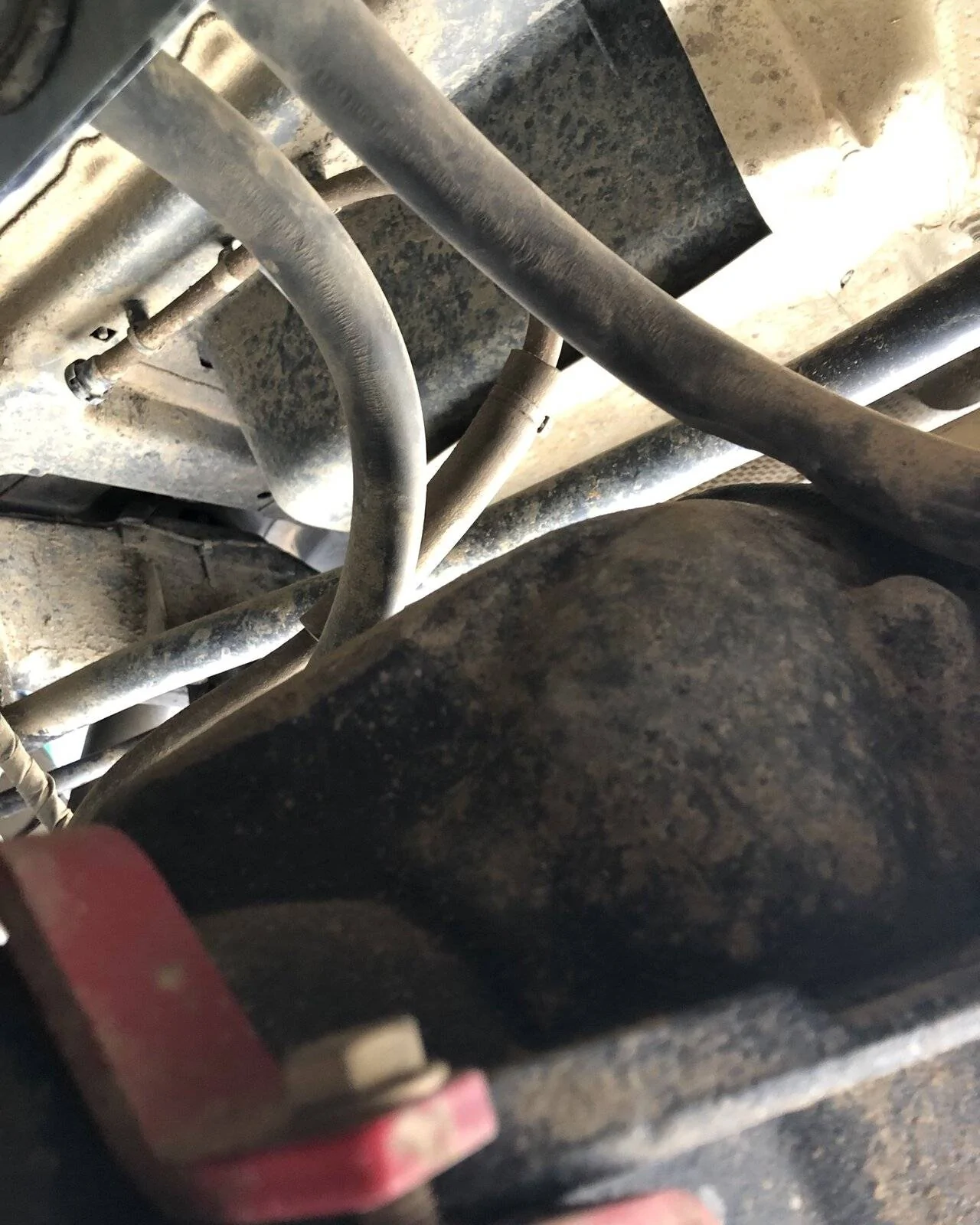

You need to re- route them under the cross member. Then I used the synergy bracket to hold them off diff.
Perfect thanks! Some of these things should be mentioned in the directions IMO.
