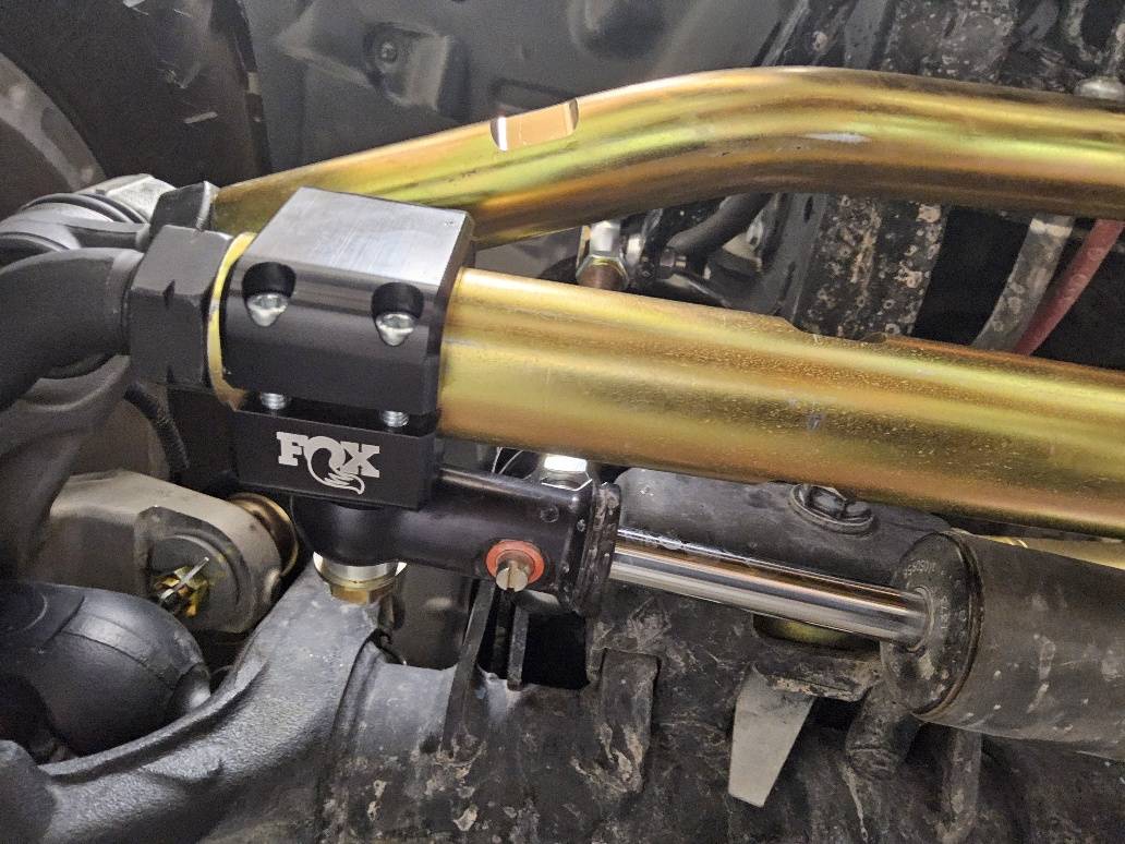

Most single stabilizer relocations utilize the track bar axle side bracket and attach to the tie rod on the other end (driver side). Stock attaches under the axle and the passenger tie rod end.

This is how my Fox 2.0 ATS was installed on my 23 Wrangler Rubi 2 Dr. with the Metalcloak stuff.
