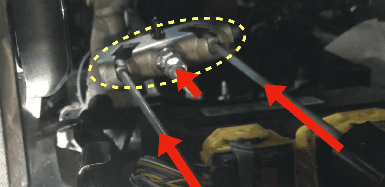

Fortunately it isn't as bad as it sounds. Four 10mm bolts and the console is free enough to lift and get your hands underneath. The cables fall out of the retaining bracket VERY easily with no tension. I managed to wrap some duct tape around the bracket so they won't fall out should I ever need to disconnect again in the future. Took about 15 minutes or so.

I don’t think so. IIRC, the cable sheathing is mounted to a fixed point, whereas the cables obviously slide freely when not attached at both ends.
I don’t know the correct terminology, but under the console the cable ends pretty much just rest inside of a “saddle”. When tension is removed they can easily fall out of that “saddle”.

Here is the aforementioned “saddle” right behind the parking brake lever, underneath the center console. Both sides of the e-brake get centered here at this location and become one cable that the lever pulls on.

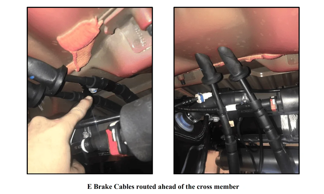

In the Metal Cloak install instructions there is no mention of re-routing the rear e-brake cables.. However I noticed in the RockCrawler instructions it mentions this. Anyone know if this is necessary or not. Will test it but not clear how the ebrake cable comes off the axle. It's a strange little connection and it seems like there is quite a bit of slack already.
I have the Metalcloak 3.5” gamechanger. I took it upon myself to order and use the synergy bracket for the parking brake cables.
https://www.synergymfg.com/synergy-jeep-jl-jlu-parking-brake-cable-relocation-bracket.html
**edit
Saw someone already mentioned this.
Also you can use a 13mm box wrench if you can’t find your 1/2” lol.
Credit: Cheaper Jeeper TV
So I think the saddle is easy enough to extend (Northridge actually has an extension they sell for the UD60 swap), I'd have to figure out some way to extend the bracket that locks the jacket in (and also apparently holds a bunch of harnesses).

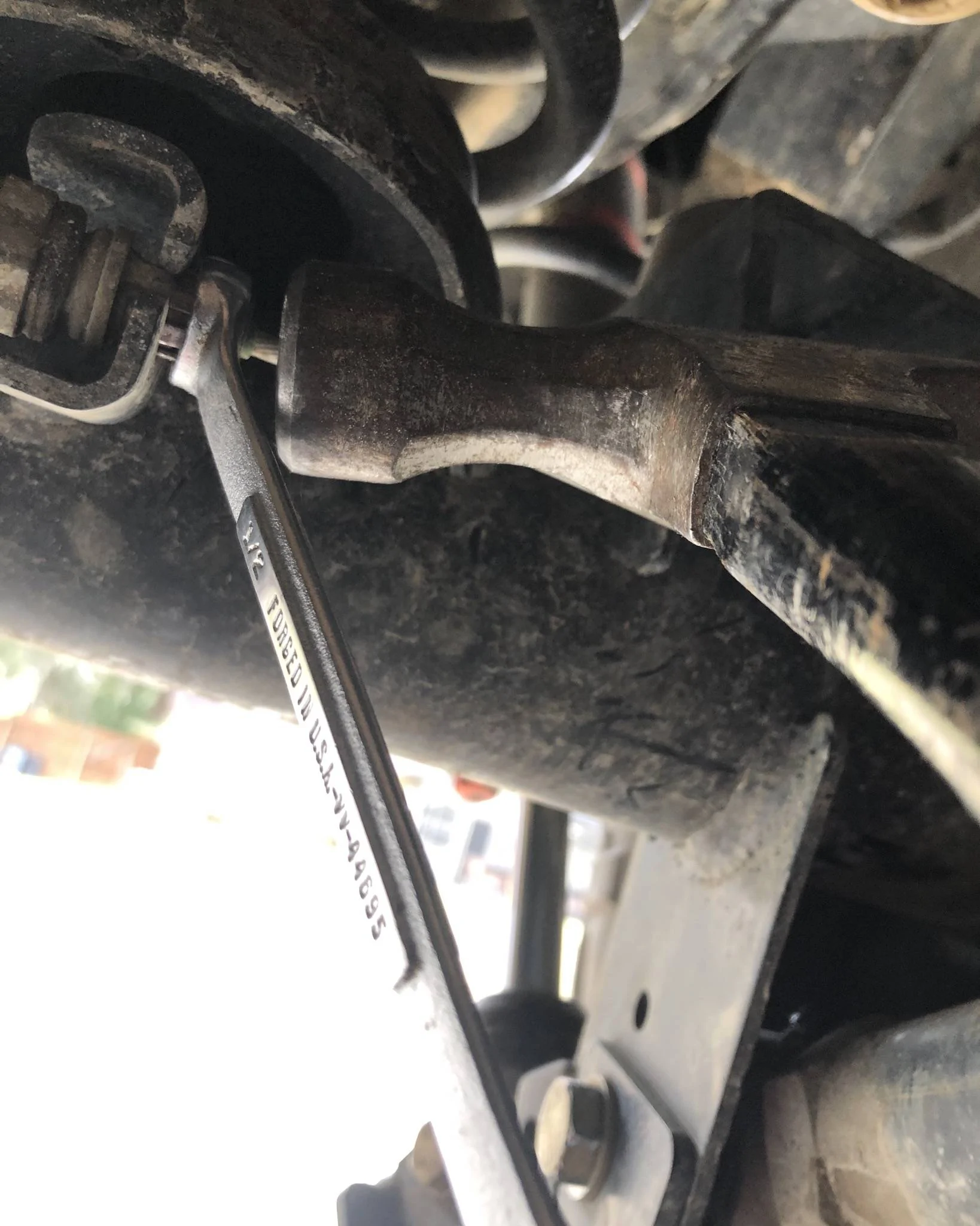

You definitely need to re-route them. I use a 1/2” box wrench and tap it on clip with hammer this will depress all the fingers at once and will come right out…also synergy makes a bracket fir them, I recommend it….
That's the trick!
I use a 13mm wrench.
