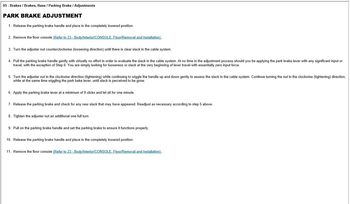

Looks like it needs adjustment. I'll see if I can find the pix of what's under the console.
roaniecowpony
Dec 4, 2018
198
13,118
20,937
Retired Engineer
So, in reading my service manual, it appears that they are seeking to adjust until just zero any play in the lever. Since yours has a lot of play, it appears that adjusting it is what's needed.
Jeep Wrangler JL E-brake concern pkg brake adj
roaniecowpony
Dec 4, 2018
198
13,118
20,937
Retired Engineer
You might also try driving about 10-15 mph and yank the parking brake to see if both rear wheels lock up. You are looking to see if you have enough brake lever travel to lock the brakes and that both cables are connected to their respective brakes.
roaniecowpony
Dec 4, 2018
198
13,118
20,937
Retired Engineer
If you want to adjust it yourself, I'll post all the steps. You have to remove the console to adjust it. It's not a great deal of work, but it requires removing the shifter knobs, top cover of the console and side bolts. You don't have to remove the front seats.

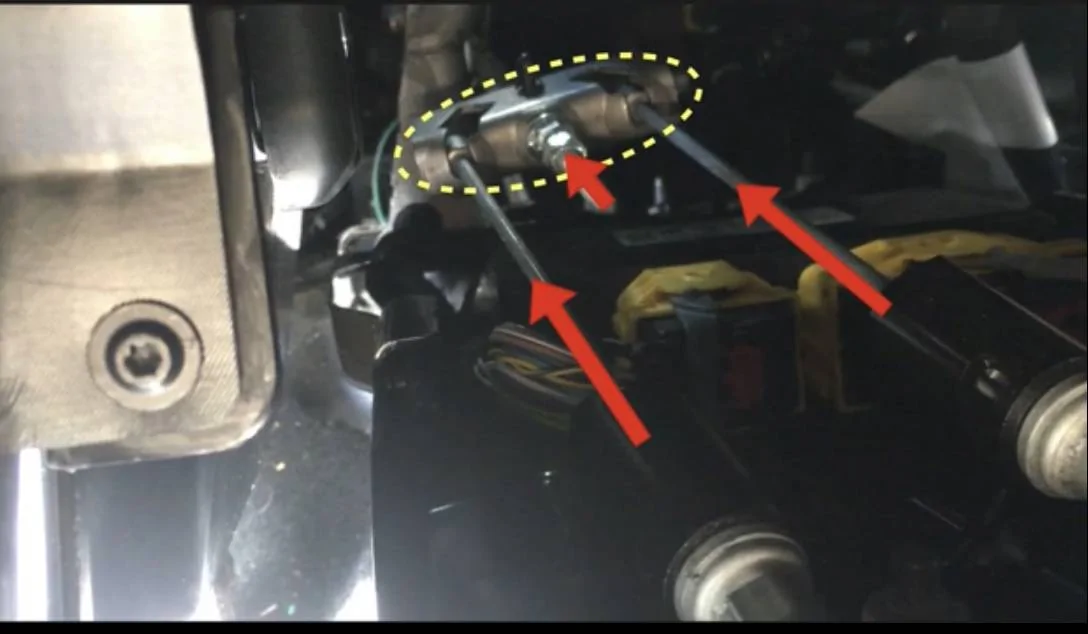

There is a way to adjust parking brake without taking apart the entire console. There are a few videos on YouTube that can assist you with this. You remove four bolts from console, lift entire console up and prop up, and then tighten bolt with 10mm socket with extension. The far left and right are cables, make sure they are seated properly. If so tighten middle nut to adjust.

This is the way, super easy if you have a 4 door. Still easy if you have a 2 door.

Super easy to adjust, pop two bolts out of back side of console with little black covers over them, prop up case and stick a 8” extension with a deep socket in there and adjust. Just did this yesterday after an axle swap.
