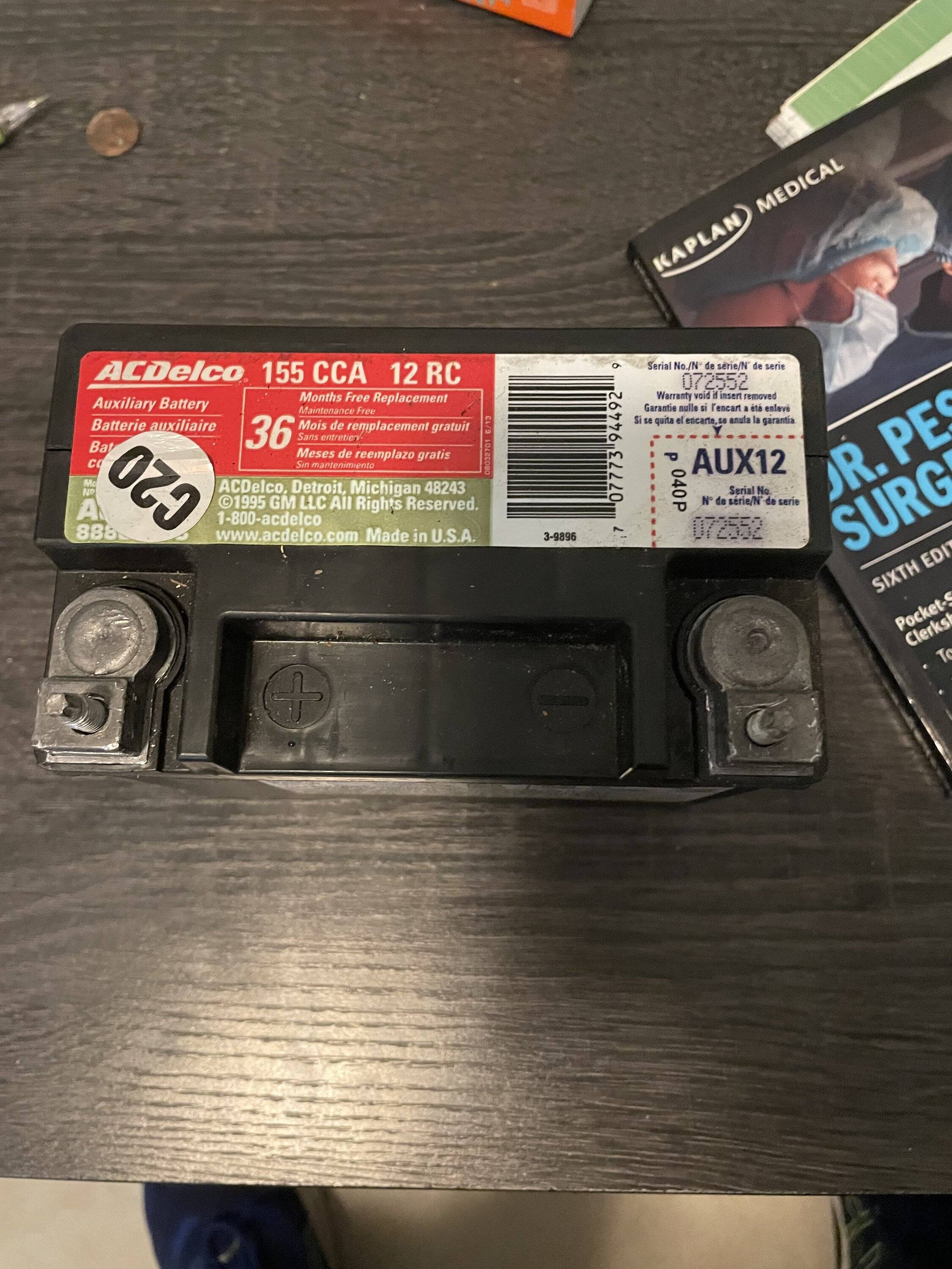

Shouldn’t it be an aux14? The dealer replaced it under warranty years ago.
