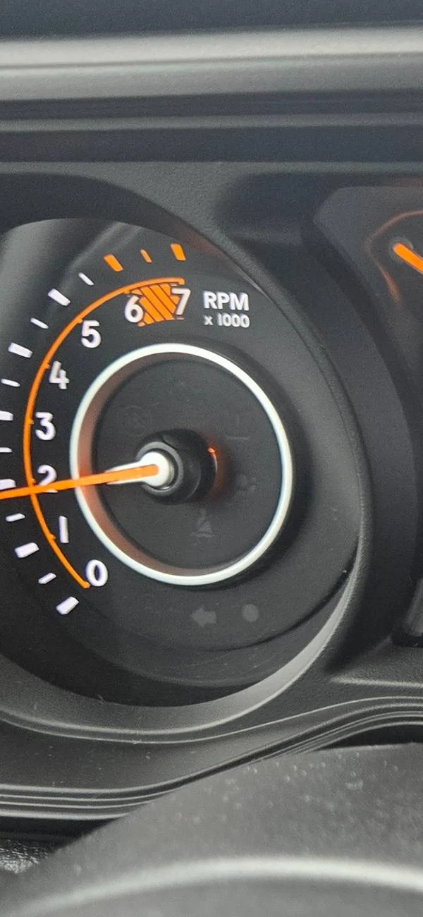

Wow, my redline is 6000. So anything below is safe?
