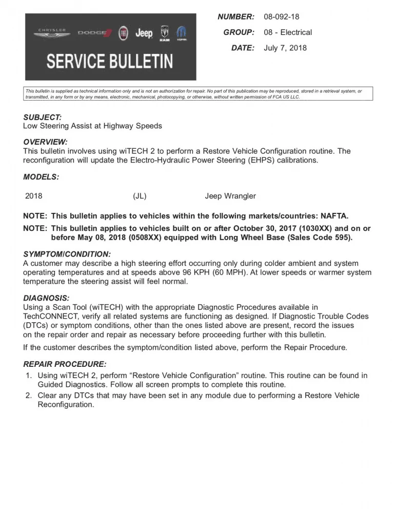

Is the U62 recall the same as , or related to this TSB?
