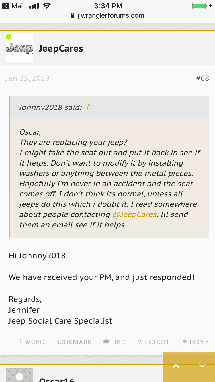

And don’t bother with Jeep Cares. They have done nothing since my problem started back in Jan.

Hi Johnny2018,
I have looked into your last conversation you had with one of my colleagues. Because you have gone to the dealership and had this concern diagnosed, we would be happy to have a case escalated for you!
Alex
Jeep Social Care Specialist

Case escalated? What is it you plan on doing that was not done initially?
As you can see by previous messages I’m not the only one getting parts backed ordered over and over. Sounds like the problem is with manufacturer. These parts should be in stock especially since several customers are experiencing it. Since January and still no part. :(
