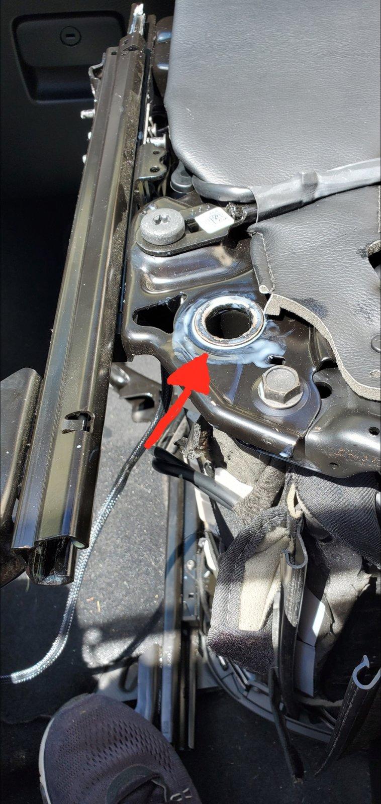

Today I discovered what is making popping sound on my passenger seat. The machined fitting has 1/8" of movement when I apply pressure. This probably should have been spot welded. I applied some lithium grease and popping is temporarily gone.

I don't see how that is possible. I think the only real fix would be to weld those two pieces. I wonder if the newer frames that are being replaced are different.
There were definite changes to the frame/part number when I got my replacement frame the first and second time. The second time they also replaced the internal mechanisms of the seat adjustment and that resolved everything for me.
