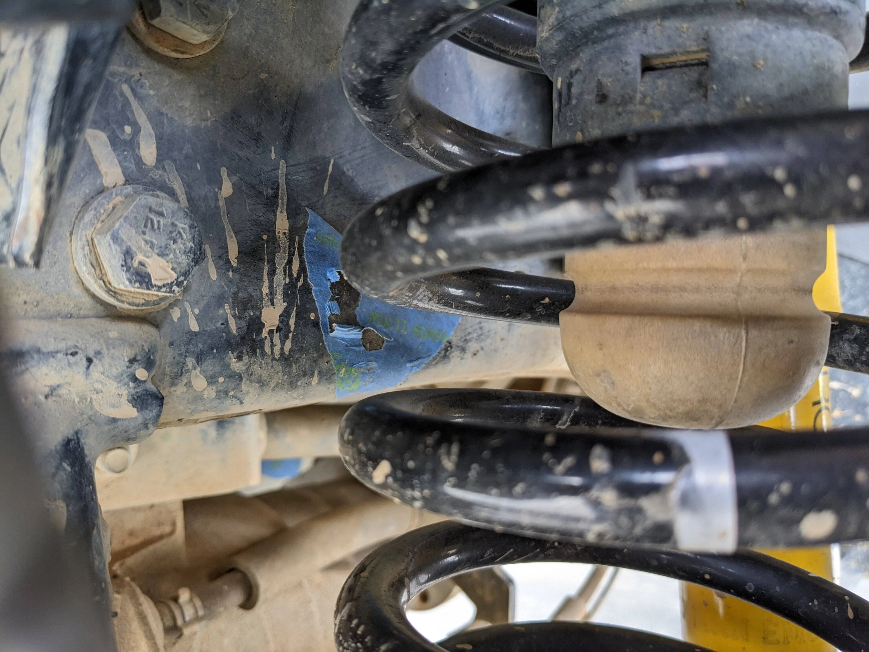

I installed an OME 2" lift on my JLU recently. Hadn't really had a chance to fully stuff each side until recently and noticed that the driver side spring was rubbing the frame a bit when that wheel was fully stuffed. I added some painters tape there to confirm and just looked again to see it's rubbed away a bit. I did not install an adjustable front track bar with the lift.
I was under the impression that when lifting the vehicle that the front axle will shift to the driver's side as a result of the front track bar "being too short". Is there a reason that my axle would have shifted towards the passenger side?

The spring will bow inward when compressed and the other side drooped. If you were able to stuff both wheels equally then the spring would compress straighter…… Hitting the frame is just a way of life for me……? …..

If you’re stuffing the passenger side as much as the driver’s side it should be hitting as well…….. you can prevent it with added bump stop, but that’s really defeating the purpose of max articulation…..

I am stuffing them equally but the painters tape on my passenger side looks completely intact and not rubbed at all. Yeah I certainly am not adding bump.

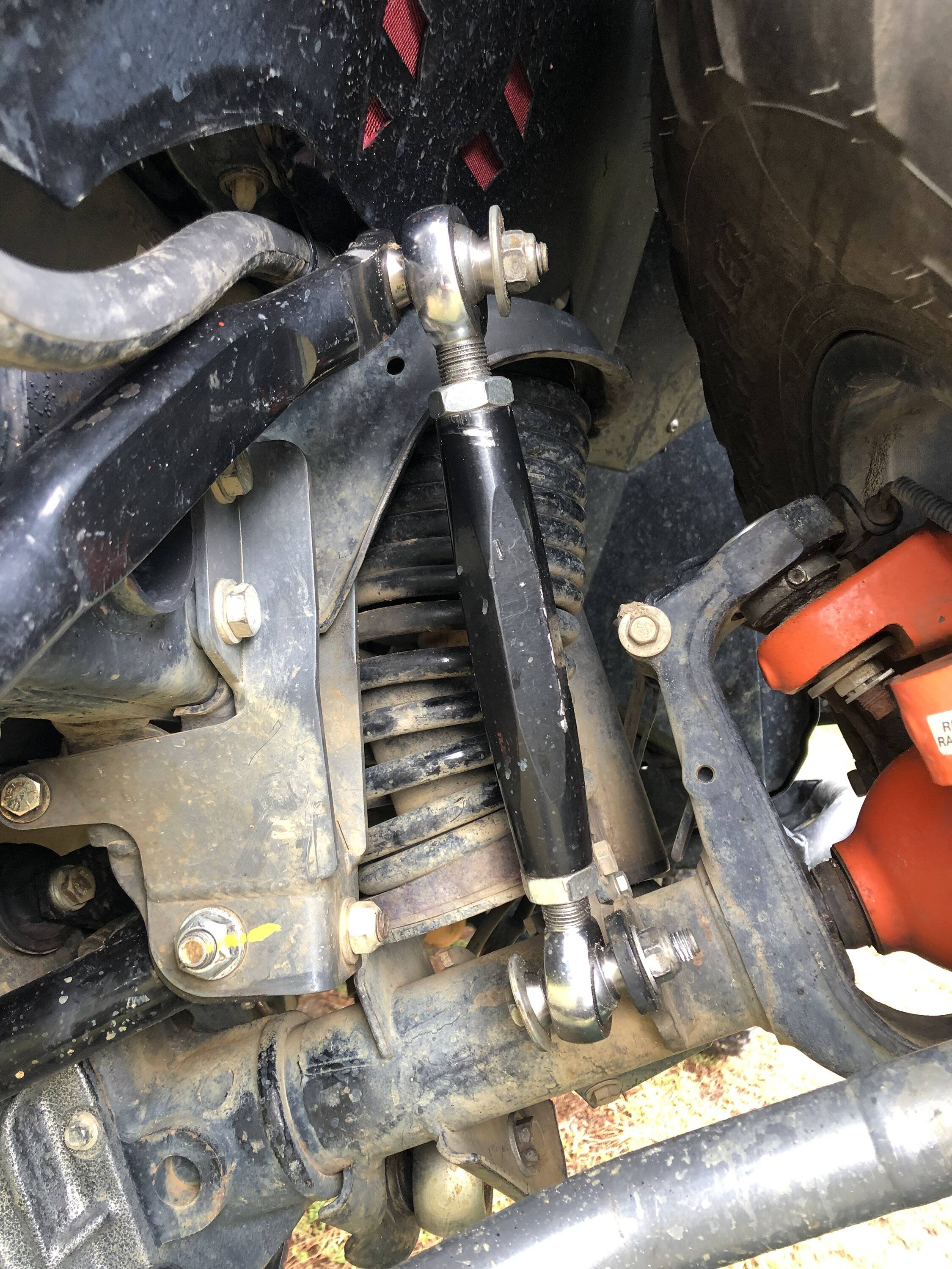

I think you should go ahead and install the track bar, and center your axle…..since the axle is shifted to driver that pushes the bottom of the spring over enough that the bow is increased when stuffed. On the passenger side since the spring is more towards the frame then that may create less bow…..probably only gonna move the axle 3/16” but on the suspension, a little bit is a lot…….. it’s a good reason to have bought the track bar…..:)

I have the OME 2" as well. Adjustable track bar is your answer. Center your axle and reduce the bow of the driver side spring. When you stuff the passenger side the arc of the track bar will push the axle to the passenger side. So your symptoms do make sense.
