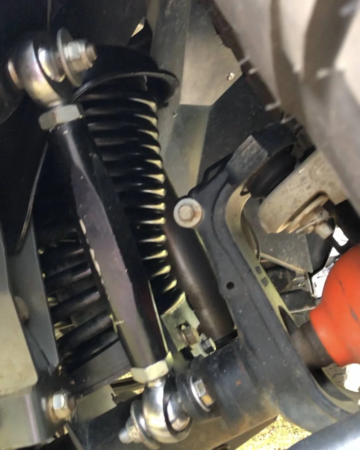

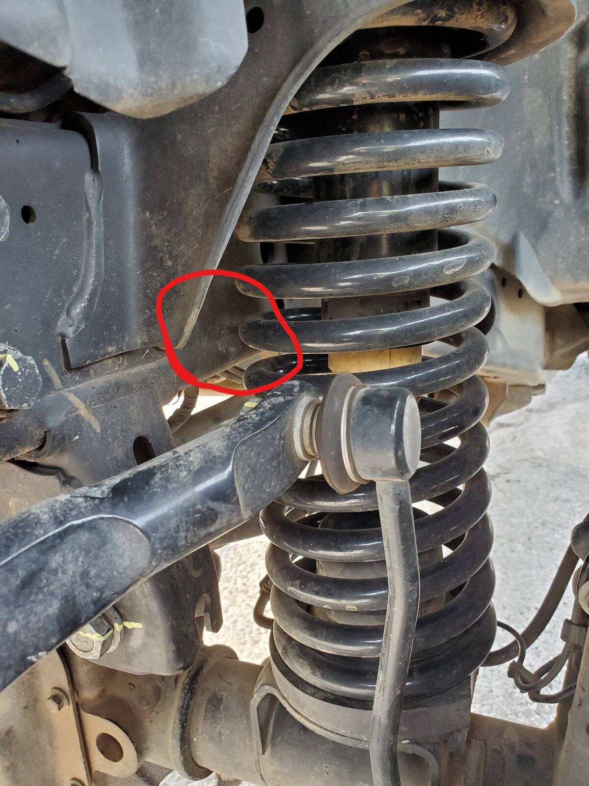

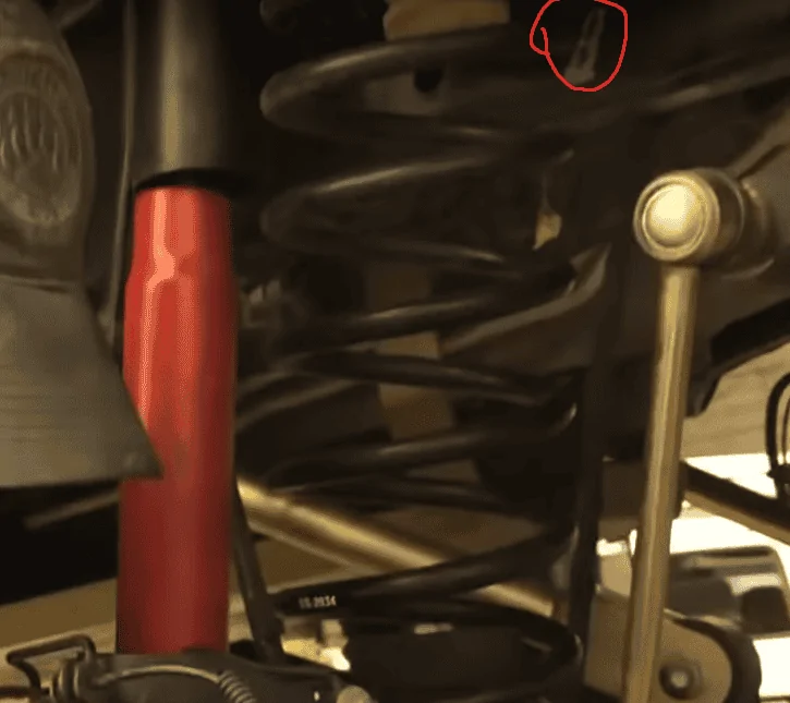

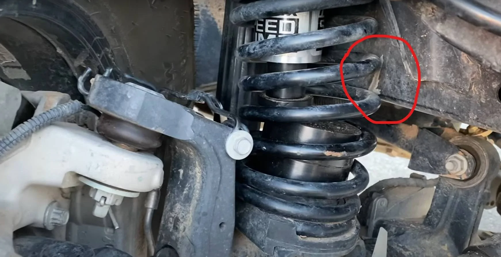

Anyone else having this issue? its rubbing on both sides when flexing and I do have an adjustable trackbar. Found a couple of youtube jeepers have this issue too. Is this common?

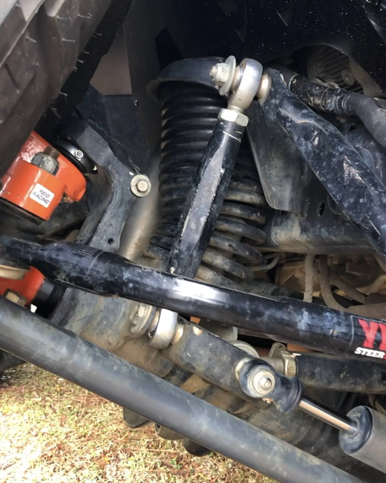

I’m on 3.5” RK springs and they do hit the frame at full stuff.......
Jeep Wrangler JL Spring rubbing against frame 12BB9B07-393C-4D16-9C62-4DE4E453C471
When you have a lot of articulation the spring perches get out of alignment with each other when compressed, the spring has to bow. Unless you have long arms then the axle stays centered in the wheel well during articulation.
Got it! ? glad to see that it's not an issue

OCD insisted I put some fuzzy side Velcro where it hits, it deadens the blow a bit, but that’s just how it is inside my head....:facepalm:.

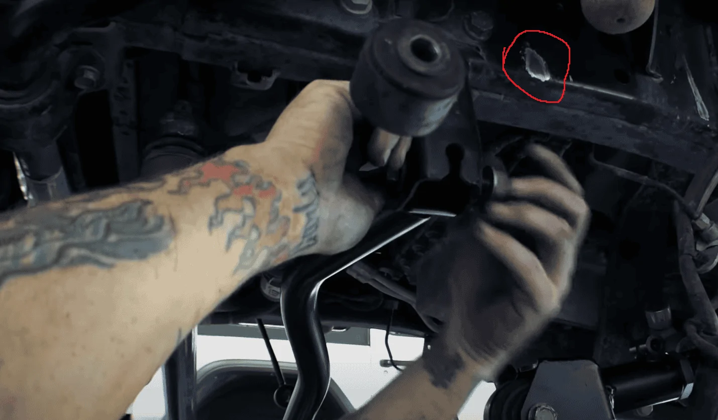

Jeep Wrangler JL Spring rubbing against frame Coil Spring Issue
AEV 2.5 Dual Sport Lift - Passenger side rear rubbing on frame - couldn't figure out the squeak for a few weeks -

Same issue after installing 2.5” springs. My passenger side spring was making a binding sound and turns out it was rubbing on the frame. The upper isolator needs to be spun 180 degrees, and redrill the hole for the little peg to fit in. After I did that the spring sat about an inch from the frame- problem solved. Hope this helps. 🍻
