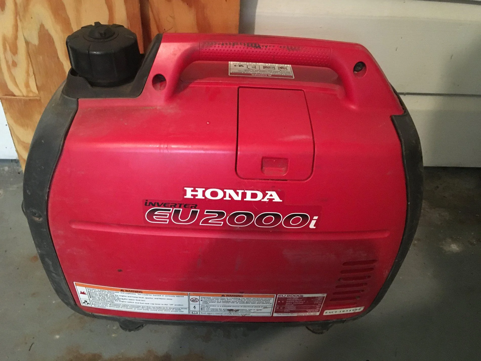

Jeep Wrangler JL Drained Battery, Any jumpstart tips?? BC78E634-8442-45DB-905D-E723807B444C
Be aware that the dual battery/Aux battery jump start related threads refer only to the 3.6 ESS system, not the 2.0. It's the same for the jumper and negative cable disconnect, it's for the 3.6, not the 2.0. From what I've read, the 2.0 does not have an Aux battery and the 48v battery will never be connected in parallel to the main 12v battery. You may still benefit from reading the battery thread I posted because it covers some very basic electrical concepts, just remember your 2.0 battery system is different.
Thanks. I’m thinking this may accompany me on all future backcountry explorations.
