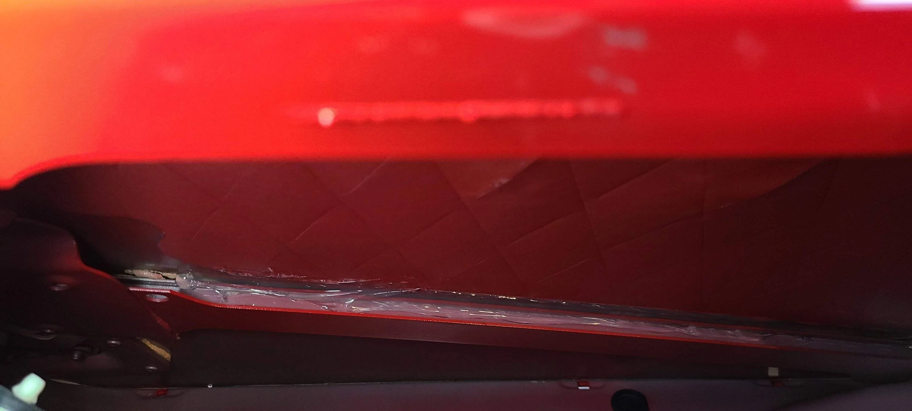

You can fix it. I had the issue with my 21 2 door and pulled the interior trim panel to access. I ran a thick bead of clear silicone along the top of the bar between it and the door skin, let it set up for a day, and the sound is gone. Door feels less flimsy when closing also. I had pics, but they're gone now.
