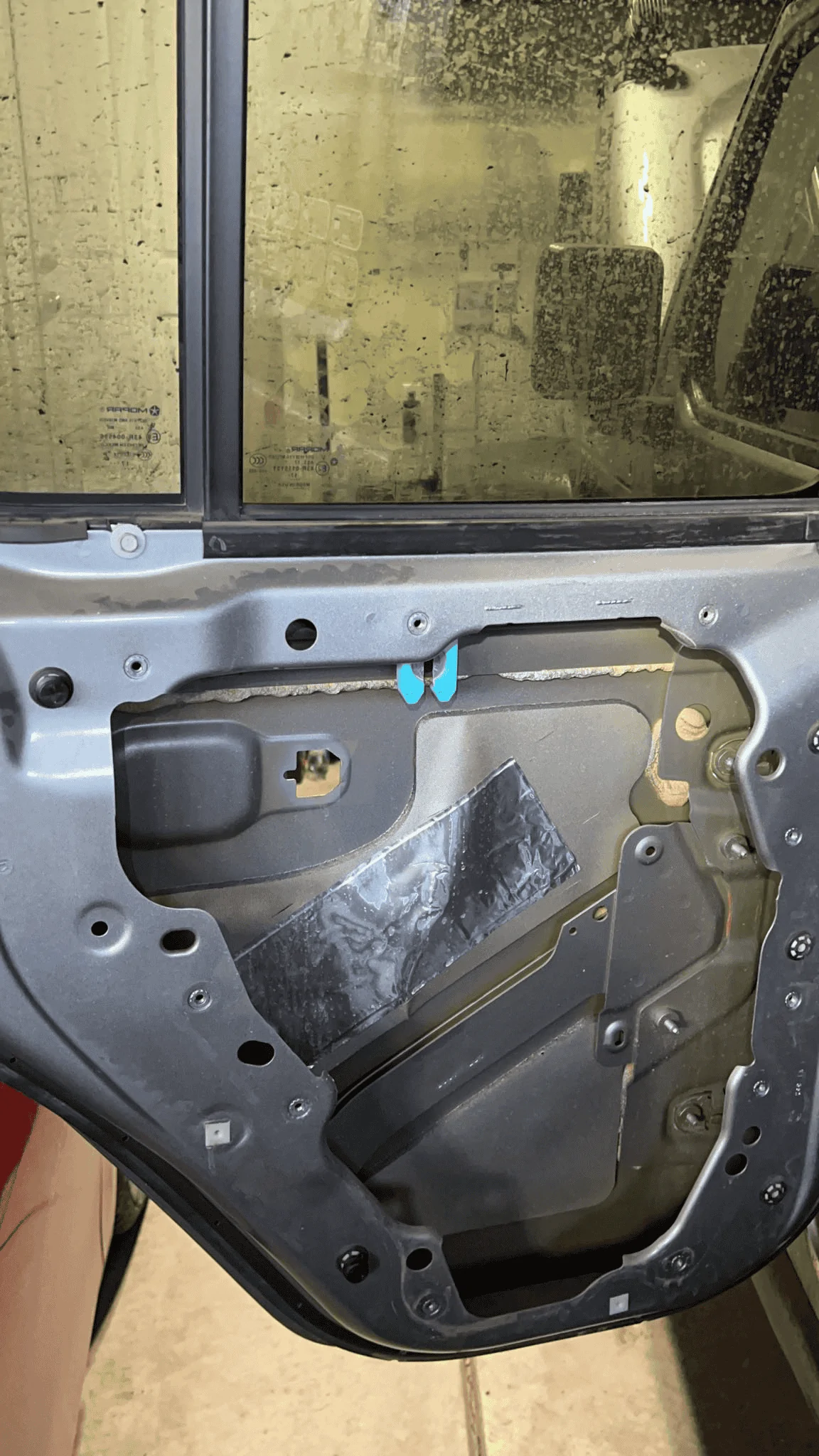

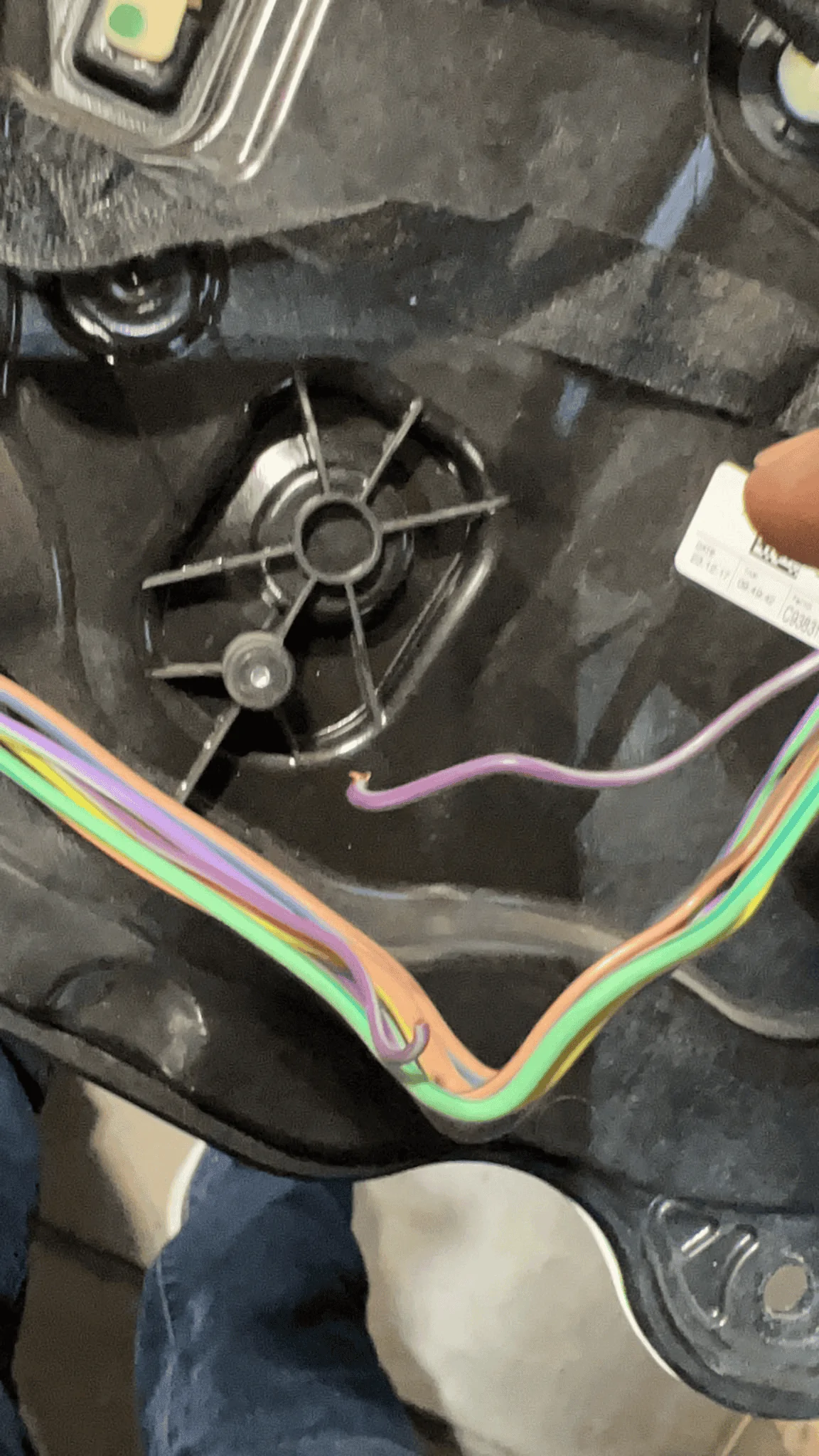

Found the culprit after a fun continuity test of the sensor wires for the failed door. Going to solder this back up, check the new voltage and state on the Micropod 2 and put it back together!
Did you find a reason the harness flexing?
General use and poor design is all I can figure. No kids kicking the wires here…It severed inside of the rash guard sleeve where the harness runs from the door to the panel by the driver seat. I’m surprised that the two wires for the sensor were 20 gauge compared to the others for the lock and window. Jeep also skimped out and didn’t wrap the wires inside the sleeve. After soldering and a heat shrink I put a protectant wrap over the whole bundle as an added measure. Hoping to not have to do any of the other doors.

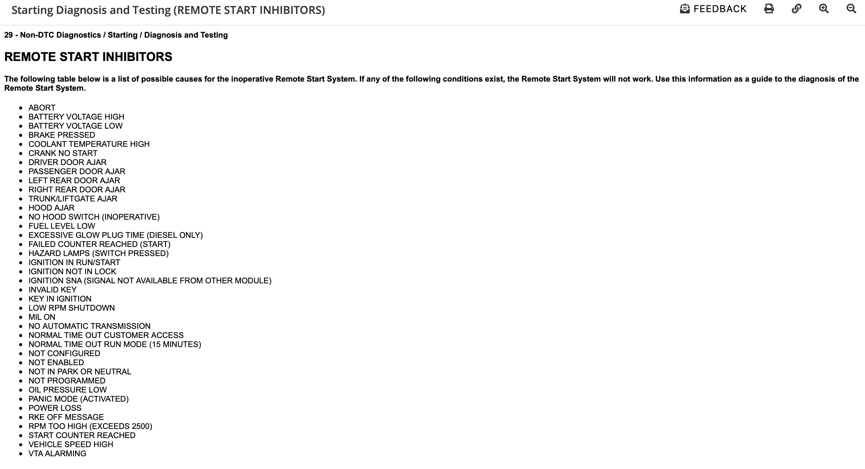

Here's the complete list of remote start inhibitors for others having issues. You can match these up to any DTCs being thrown. Last resort, scan as I did for the specific inhibitors being thrown for the system. I can use my Micropod for anyone around Denver.
