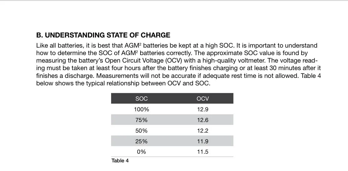

This "IBS SOC" discussion is really a thread drift, so I'll try to be brief. First, for a good, simple, explanation of SOC, here's what the engineers at Odyssey say:
Jeep Wrangler JL 2025 JLUR Remote Start Does Not Work DDFF440D-C119-4C53-9FA2-CFFA471E495A
(Note, I believe virtually all $20 digital voltmeters will be sufficient for Jeep owners).
