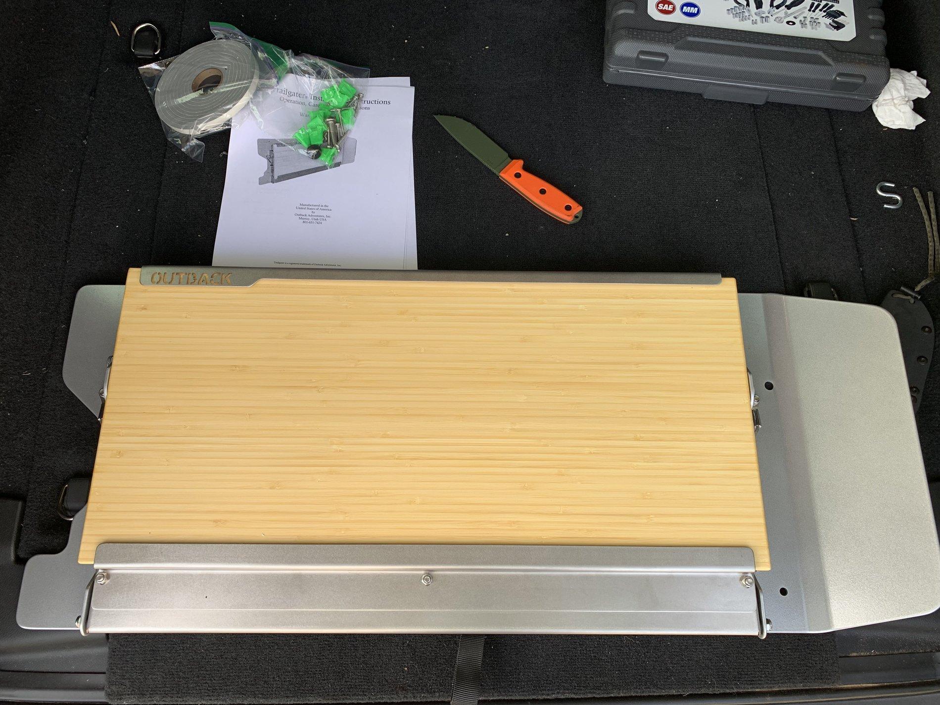

I have an outback adventures one I'm trying to sell but man the shipping cost is kinda high. If anyone is in South Texas I'd sell it for 275. Its almost brand new.
wish you were closer. We’re trying like heck to find a tailgate table in preparations for our big trip and nobody has any in stock

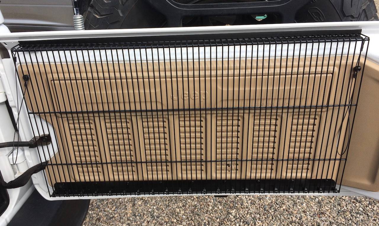

My DIY $35 drop down table. It is all available at Lowe's.

That's fantastic. Really well done and unique to those that know but looks so clean and OEM to those that don't know.
I Krylon Plastic Fusion rattled canned much the upper interior. Too much black IMO. There are a couple photos my showcase...https://www.jlwranglerforums.com/forum/showcase/biscuit.1163/

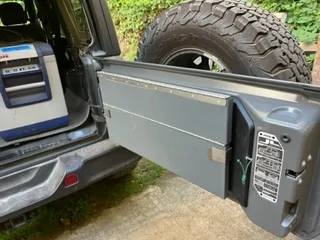

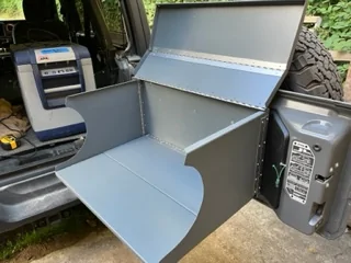

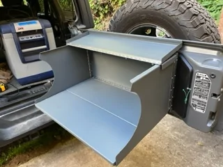

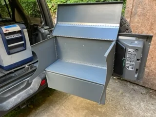

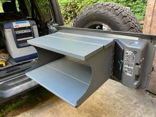

A re-post I did on the "Best table " thread, then saw this DIY thread that seemed more appropriate.
I just finished a DIY table from scraps laying around the shop - I spent a total of $1.36 for 5 screws. All else was "free". However - if I were to have been paid $2.00 an hour for engineering and fabrication time - it'd have been much cheaper to buy one.
That being said, here is my "do-all" table. 28" wide, 22" deep, with a 16" deep top shelf. Everything is hinged, so I can use either half table or whole table, top or bottom, as I see fit. The whole thing weighs 14 pounds and sits less than 2" deep when closed (including the 0.200" offset from the tailgate for venting). Made out of 0.062 aluminum.
I like the KISS theory, but always seem to fall into the KICD clan (Keep It Complicated Dipwad).
Jeep Wrangler JL DIY Tailgate Table table closed
Jeep Wrangler JL DIY Tailgate Table table open
Jeep Wrangler JL DIY Tailgate Table table 2
Jeep Wrangler JL DIY Tailgate Table table 3
Jeep Wrangler JL DIY Tailgate Table table 4

That's pretty slick
MPTee
Mark
May 26, 2022
112
131
Pacific North Wet
Jeep - "nuff said
Thank you Sir. It turned out better (and bigger) than I expected.
