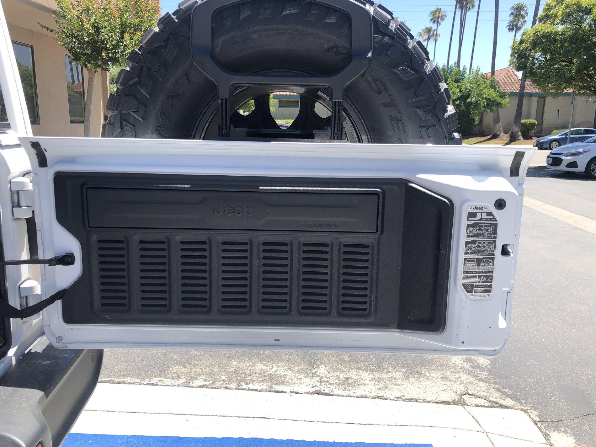

Has anyone attempted to do their own DIY tailgate table?
Got the idea from this video, but curious if anyone has successfully done it on their JL.

You’re right. It’s not metal. Curious how the modifications would work for the JL. Here’s a pic if anyone has any ideasThe magnet is interesting, unfortunately the JL tailgate is supposedly magnesium alloy now.

Nice! I may go with your method. Do you have any pics? Would love to see them.I made one and it worked well. I used a 1/4in plywood sandwiched with a nice 1/4in black HDPE sheet.
I used these shelf brackets and just flipped them upside down.
https://www.amazon.com/Folding-Shelf-Bracket-330lbs-release/dp/B06XBWCQB5
If you pull off the plastic cover on the tailgate, there is a set of empty bolt holes that take M6, if i remember correctly and just bolt the hinges in to that, but get long enough ones so they can reach through the plastic cover.
KISS - Keep It Stupid SimpleJust thought I’d share the final product. Pic in Zion
I recall seeing a youtube video on installation of one of the commercial tables. You could look for one of those and see what holes they used. I seem to recall that they used some open slots and put in custom molded plastic inserts to put some screws into.Nice! I may go with your method. Do you have any pics? Would love to see them.
