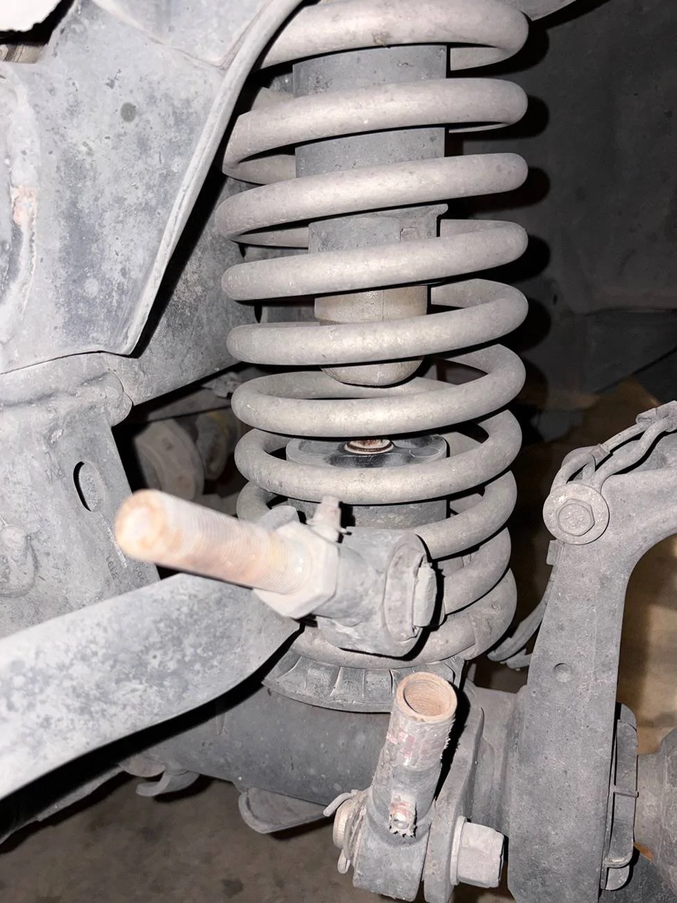

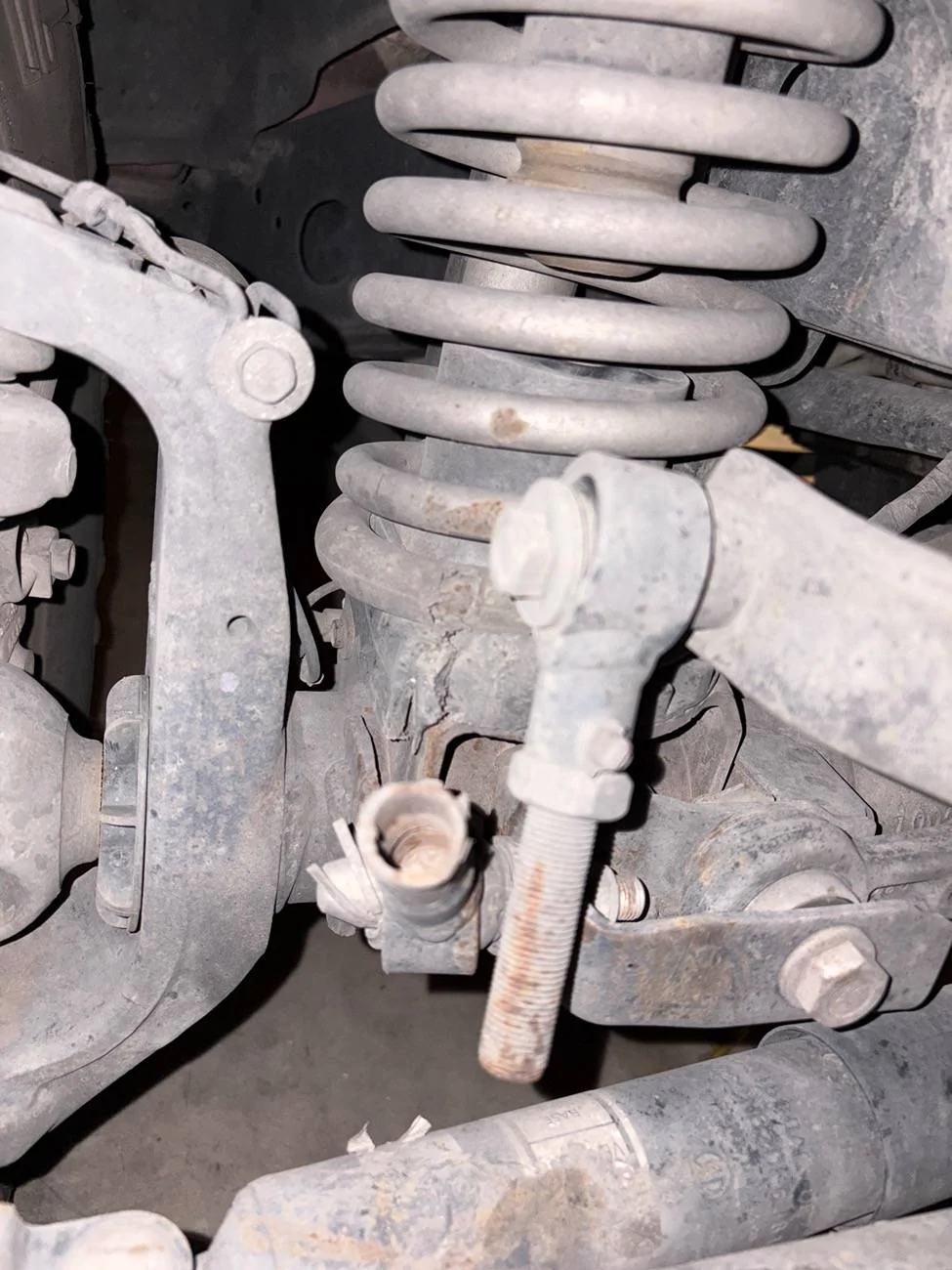

New Jeep owner here. I’ve had my 2018 Jeep Wrangler Sahara for about 3 years now. Purchased used with modifications done by the previous owner. It is lifted and has 37s. I went to have my oil changed at the Jeep dealership and I asked them to check my vehicle over for possible maintenance. I was told I would need to replace my brakes soon and I was also told that my front sway bar was disconnected. This is my first jeep so I had no idea that I was driving around with a disconnected sway bar. I have not noticed any sort of death wobble when I drive and I haven’t noticed any handling issues on dry roads. I have noticed it did not handle well on snow covered roads whatsoever and on wet roads I noticed some occasional sliding. My tires are off-road tires not all weather tires, so I’m not sure if it’s the sway bar coming to play or my tires with wet or snowy roads.
They suggested that I reconnect the sway bar for safety issues. I don’t use it for off roading at all. (sacrilegious, I know! But I live in the city and eventually will) I have been driving the vehicle on the street without issues on dry roads having the sway bar disconnected. Should I have it reconnected? What issues will it cause to leave it disconnected and what issues will it cause to have it reconnected? The dealership told me that it appears that everything is stock and I would just need to purchase the links and have it reconnected.
I am also considering looking into a shop that deals with off-road modifications to maintain my vehicle because the dealership has not been great at being forthright with the modifications that have been done and any safety issues I can be up against unless I straight up ask them and answers vary depending on who’s on shift that day. Is it better to stick with the dealership on issues like this? My vehicle is not under warranty anymore.
Thanks!

Wow.. that's wild. Somebody installed removable sway bar links and then make them hard to remove by using cotter pins instead of the normal snap rings.
It's a little hard to be sure from the rusted parts but it looks like the links were too short and not enough thread was left on the adjustable links and they simply pulled apart ...
You very definitely should get them reconnected. Without them you will have pretty significant side-to-side sway and any sudden high speed maneuver (ie.. avoiding a deer) gets damn scary. At slow speeds, off-road, having your sway bar disconnected gives you much more flex since the sway bar is no longer trying to keep the two ends of your axle level....
You definitely have some sort of a lift, somebody went through the hassle of installing the bump stop extensions (notice the big black round things on the inside bottom of your springs). So, its very likely can just buy as set of OEM "REAR" links and use them in the front. Many of the lift kits do that ... replace the back ones with longer links, use the rears to replace the short stubby fronts.....
If you don't take your Jeep off road at all then you should reconnect them. While you can drive around perfectly fine with them disconnected, you'll likely notice your Jeep will feel much more "planted" and less wallowy in the corners with them connected. I've heard that emergency braking with a disconnected sway bar can get sketchy too, so just something to be aware of.
Your current end links appear to be broken, or perhapd came unthreaded from the base. Either way you should get new ones as the bushing looks shot. If you're lifted on 37s you'll likely need taller than stock end links. What lift do you have?

That is not what I expected when you said disconnected. That's easily fixable though, sway bar links are readily available and you can even make it where you can disconnect when you want

It's something you can easily do yourself with a wrench. I'd remove that old one and put a new one on. It looks like the bearings on the old ones are kind of toast.
If you check out youtube there are tons of videos on how to replace swaybar links. 👍

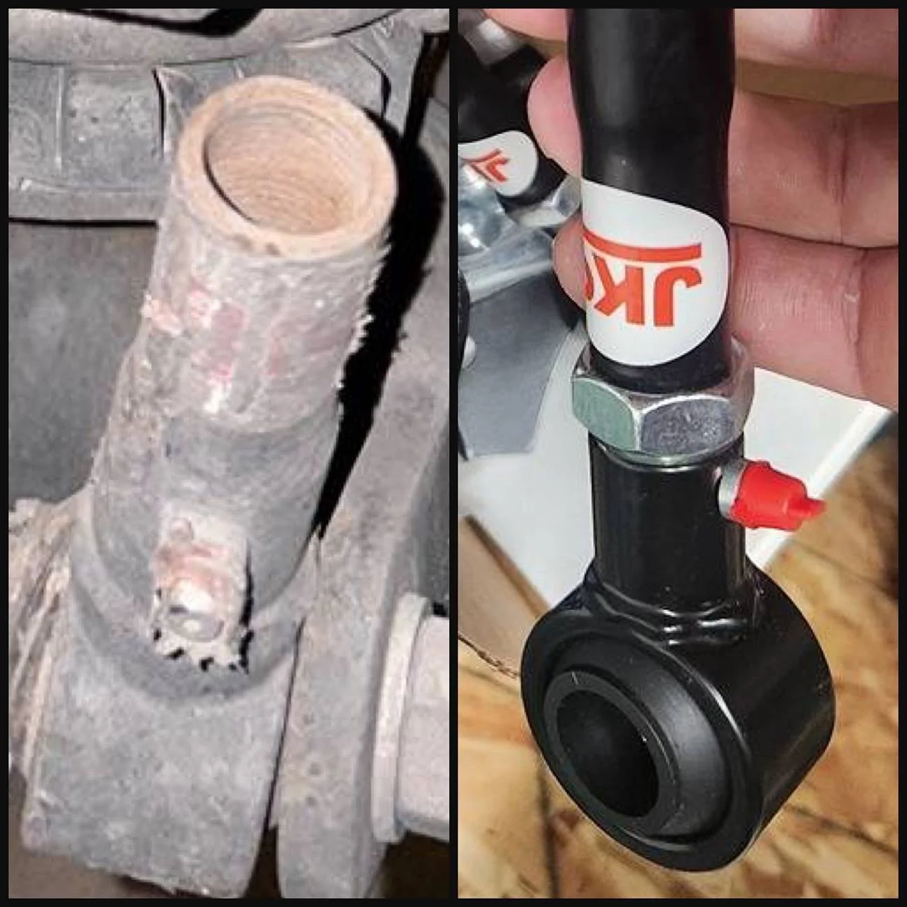

Looks like you have JKS sway bar links, they do not disconnect by unthreading. I wonder if they are stripped out and became 2 piece sway bar link.
I think you nailed it. I’m amazed that someone sold the Jeep like that. Well, not amazed… more disappointed to see someone take advantage of someone this way.
