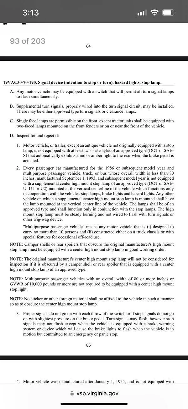

No state requires a 3rd brake light. It's a federal requirement to sell a new car, that is all the reason for them.
By way of example, Pennsylvania -- the state just to the north of you -- requires a functioning 3rd brake light in order to pass the annual Safety inspection.

I stand corrected... will change my original post.
Though I expect once my 18"x10" wheels with 2" spacers and 13" wide tires are installed, 80" will be my width with my Rubicon. If not a custom 3rd brake light will be added for inspection.
I'm pretty sure (not entirely) that vehicle width is fender to fender for Wranglers. It excludes mirrors, so I suspect wider tires would be excluded as well.
