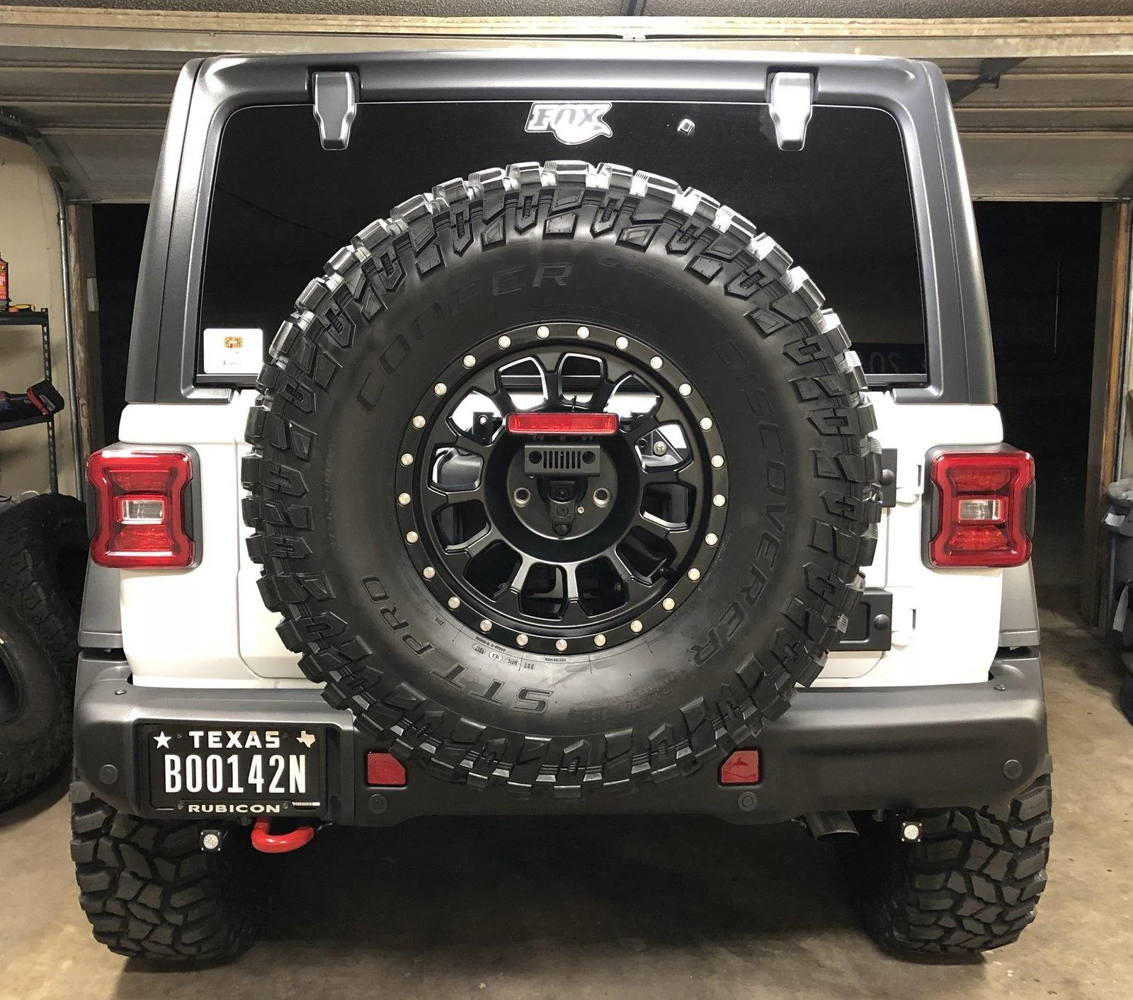

A few here have installed an LED light ring and removed the stock 3rd brake light altogether. Requires splicing into the 3rd Brake Light wiring harness. Requires some metal cutting on the offering to get it to work on the JL The LED light ring is not DOT approved. This vehicle will not pass State Vehicle Inspection.
A couple of forum members here have installed the LED light ring but have also left the stock 3rd brake light in place. Requires splicing into the 3rd Brake Light wiring harness. This vehicle will pass Vehicle State Inspection.
There are also a couple of copy cat aftermarket relocation offerings that mount similar to the Mopar relocation kit. These offerings use the stock 3rd Brake Light, move it down and mount it just as Mopar mounts their offering. I have seen two of these aftermarket offerings and I don't care for their look. No wire splicing required. This vehicle will pass State Vehicle Inspection.
Personally, I do not care for the LED light ring look. I do not care for the aftermarket kits brackets on the ones that mount as the Mopar 3rd Brake Light offering does.... I need to be able to pass State Vehicle Inspection with a DOT approved 3rd Brake Light. So, I went with the Mopar Relocation kit at least for now.
Anyway, I went with the $70+- Mopar 3rd Brake Light Relocation Kit. Sees you removing the 3rd Brake Light mounting bracket and the 3rd Brake Light itself is moved down to center of spare..... down so it does not block rear view. The relocation requires a simple install with no splicing into the factory wiring harness. Takes about 15 min. to install. Easy install for most anyone. This vehicle will pass State Vehicle Inspection.

Jeep Wrangler JL 3rd Brake Light Options fullsizeoutput_13bc
You can buy the LED 3rd Brake Light Ring here: https://www.amazon.com/Xprite-Spare-Light-Lights-Wrangler/dp/B074HS1CRZ/ref=sr_1_31?ie=UTF8&qid=1528244141&sr=8-31&keywords=jl,+wrangler
You do need to make a slight modification to make it work on a JL.
Jeep Wrangler JL 3rd Brake Light Options kkkk
