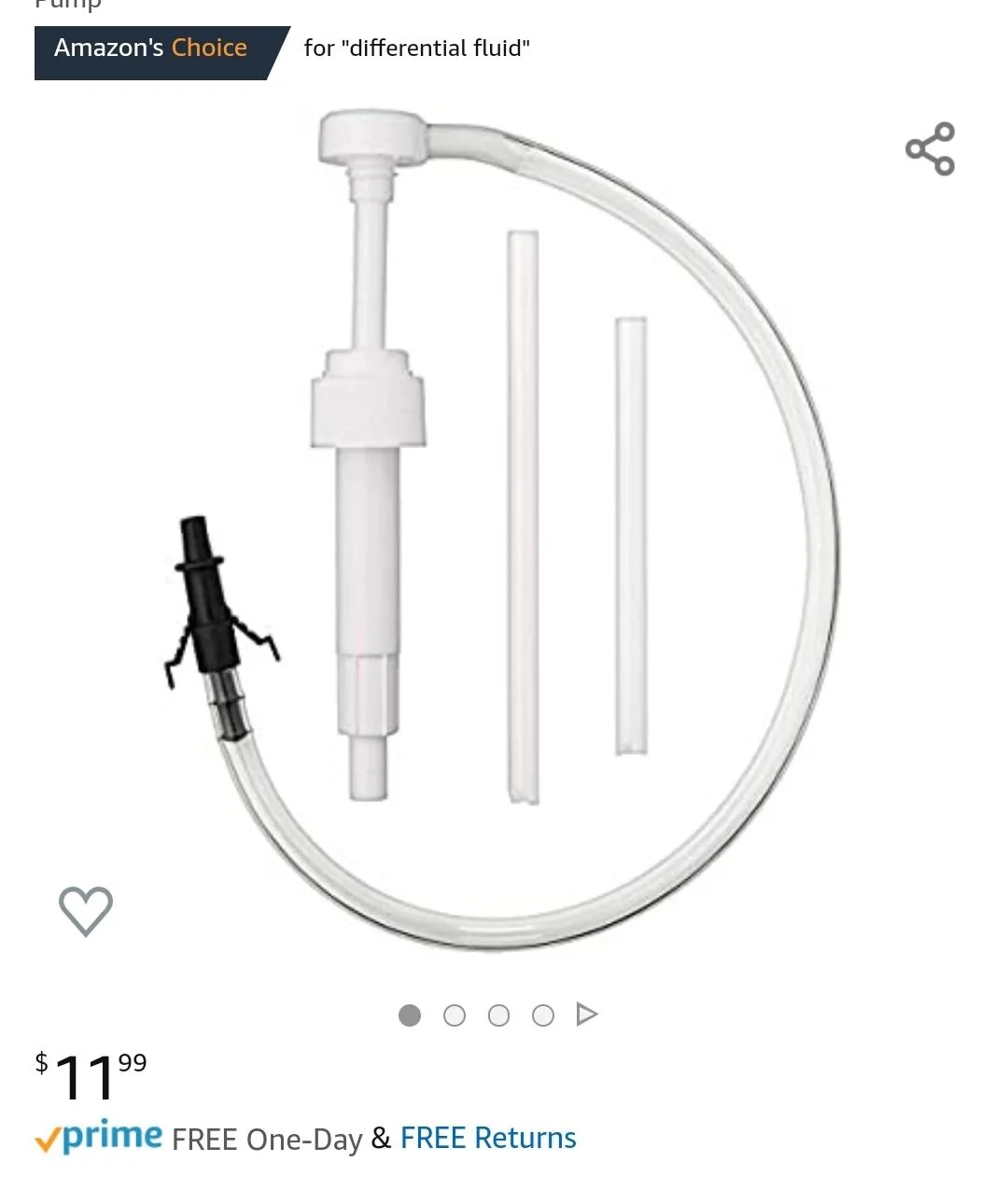

What’s the trick for filling the front with the tie rod in the way?

I use Amsoil and it comes in a very convenient squeezable bag. Have a JULR and changed both front and rear oils with out any pumps and no issues. Start to finish took about 20 minutes to drain, clean plug, reinstall and refill on each end.
