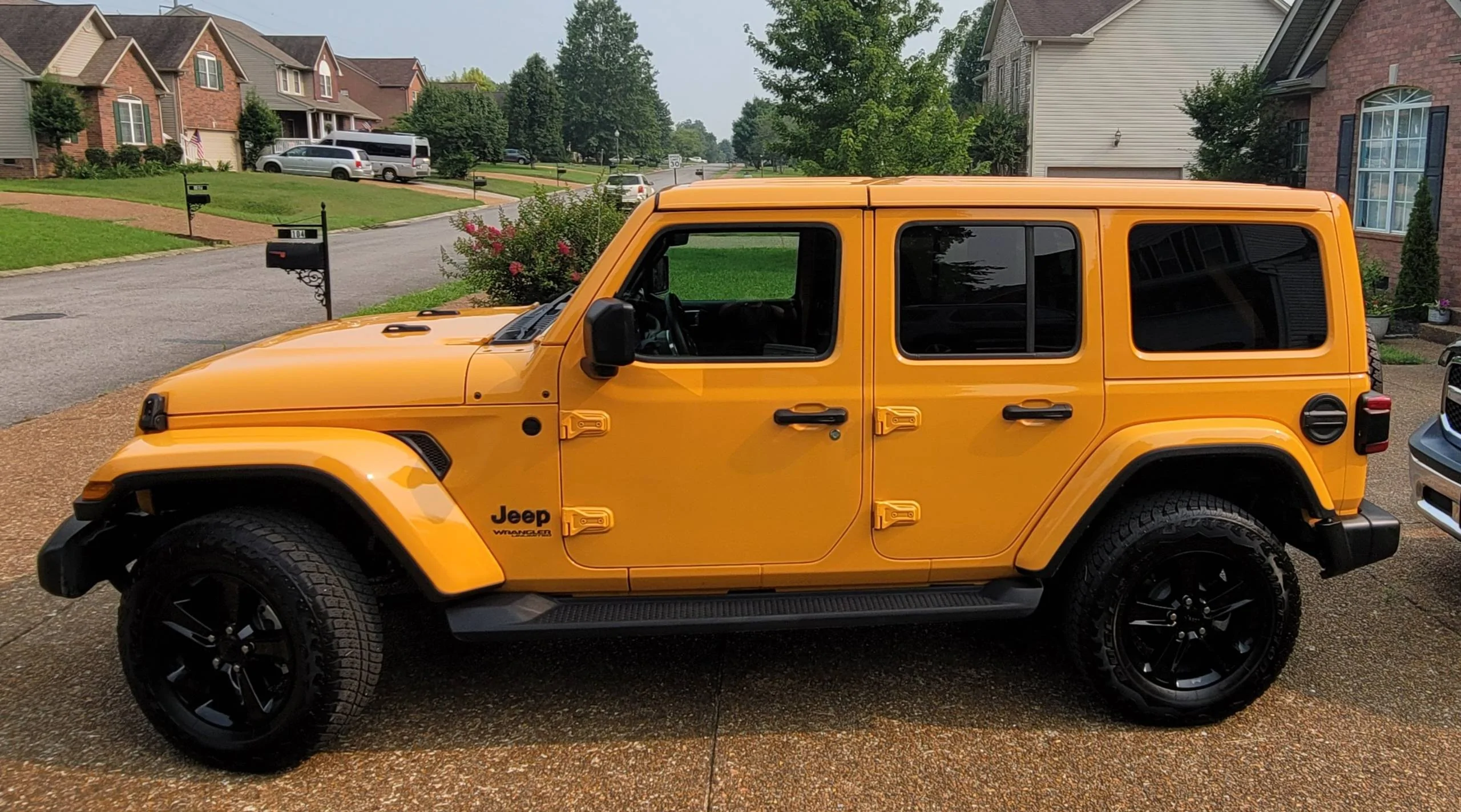

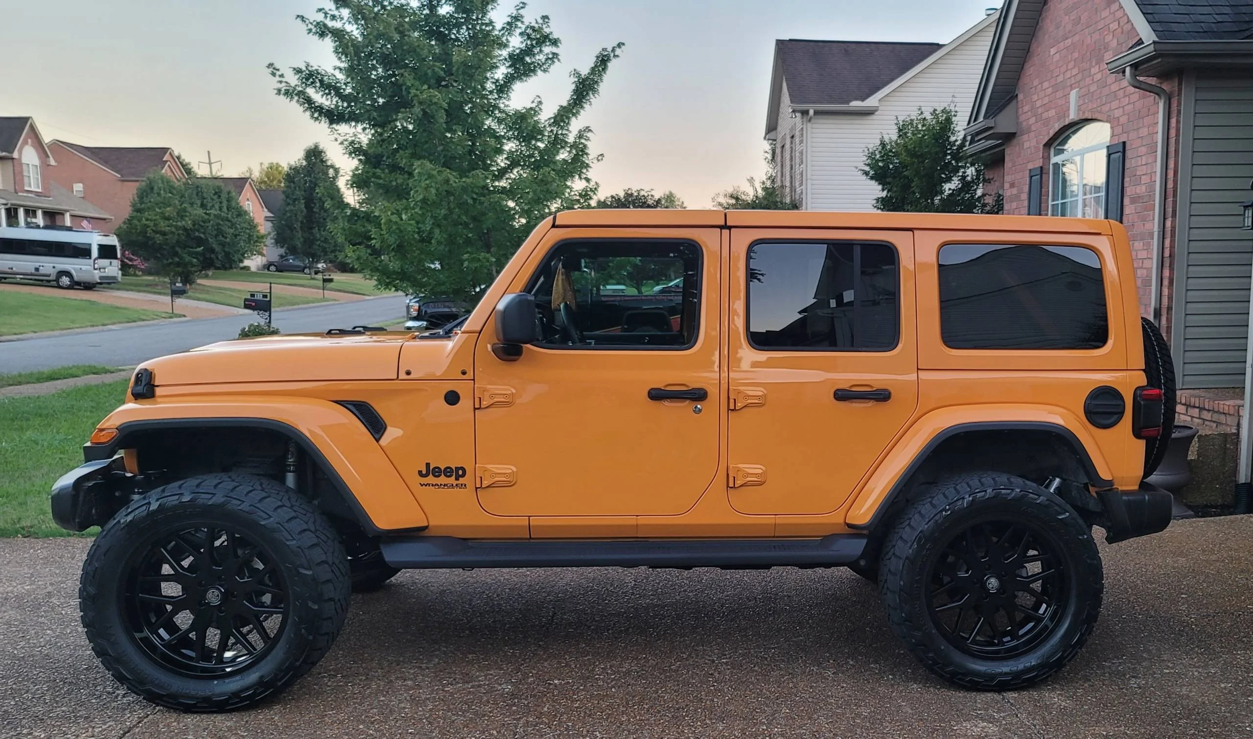

Just picked it up after doing mopar diesel specific lift with bilstein reservoir shocks, yeti front and rear adjustable trackbars, yeti tierod assembly, yeti draglink, yeti sector shaft brace, and relocation bracket, upgraded fox steering damper and brackets, quadratec hd ball joints, 22x10 thret offroad monarch wheels wrapped in 325/50r22 Nitto Recon Grapplers.
TAZER programmer and jeep has had new tire diameter set.
Drives great, tracks straight and true, no wobble or wandering at all... no noticeable loss of power. LOVE IT.
But it does seem more sensitive to inclines and the mpg is suffering more than I wouldve thought from the diesel. I am now getting 28 ish on hwy and averaging 23 - 24. If I geared at 4.10 could that help mpg? Ps. Some before and afters:

That's still pretty damn good mileage.
Is your build intended for rock crawling or just for looks? Your equipment list implies rock crawling, but your sidewalls look awfully short for that.

Your tires are about 50% wider than your previous tires, which could potentially double rolling friction. Your tires are also going to be equally as much heavier. The higher ride height will add substantial drag. You're getting about what Rubicon trims get because you're running nearly Rubicon weights and ratios. Higher gearing might get you 5% more, but really you're right on target with expectation... Getting a GDE tube might get you 15% based on what others have started, but you're never going to get close to your previous economy because there is very considerably much more systemic resistance.

Mostly looks, But it gets taken off road on job sites and mild trails.
I put all of the beefier stuff under it because right after i bought it, it had a couple of incidences of death wobble over bumps at hwy speeds... and it was bone stock, so i replaced all of the cheap hollow parts with what i felt was the best available. And now, i have a good foundation to build from, if i want to beat on it 1 day, its ready!

I'm gonna be real, putting 22's on your jeep is just something else. You just massively increased the driveline weight for almost zero performance benefit. Your MPG is going to suffer for it, not much you can do. I'd imagine it's lighter with less sidewall though
Yeah, thats what i figured...ill hit it with gears and a tune or derringer setup and rock it!
Next tires im gonna go with 35x12.5's, 1" less width and therefore less contact friction...just thought these 325/50's were SICK looking!
