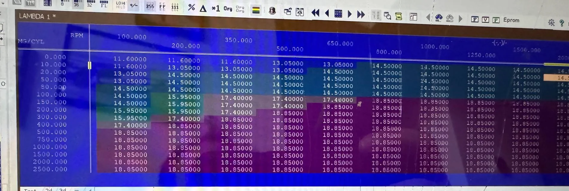

Factory tune targets 18.85:1 AFR and max 1400F EGT at full load . Derringer drops afr into 17:1 range and temporarily raises egt limit to 1530F .. they can easily say that is above the factory limits .
This!!! I know a lot of people out there think that the dealership cannot tell if you take it off, but most of them do not know that the ECM records things like max limits.
@rickinAZ, whether they find out or not depends on a few factors. When the technician gets the work order for your vehicle, they will diag it. Since warranty does not usually pay much for diag time, they will likely want to do it as quickly as possible so you may have a case where the tech will not even bother digging into whether any mods caused the damage if it is not clearly evident(ie. still being installed).
The tech will then submit his diagnosis to the warranty clerk who will in turn submit it to the manufacturer for approval. The manufacturer can either immediately approve the repair or request further diagnosis such as pulling the data from the ECM. If they do this, then you are screwed. They will know that the max allowable limits have been passed regardless if you take it off before hand or not.
So if you take off the Derringer, there is a chance that you can go through the whole process without anyone finding out, but they can ultimately tell if they do enough digging.
