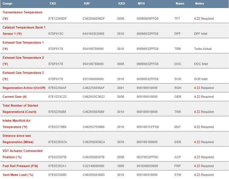

I have a Scangauge II. I got it so I could learn more about the regen cycle. It works well.
Jeep Wrangler JL Monitoring Emissions Equipment xgaug
