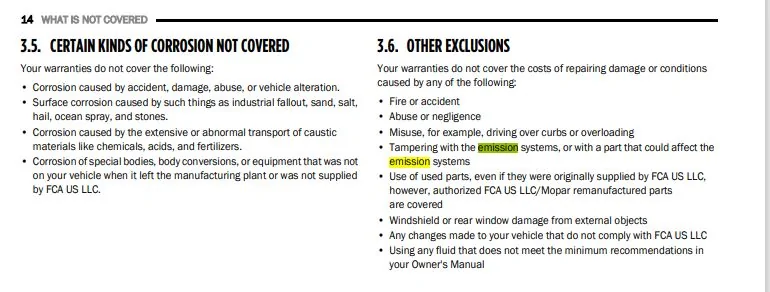

I would bet that if you checked the warranty statement for your vehicle (any vehicle) it will explicitly state that it is a violation of federal law and emissions warranty to modify engine controls at all.
This is straight out of the diesel warranty booklet:
Jeep Wrangler JL Derringer vs. emission control warranty? Capture1
'Tampering with the emissions system' = any fueling or air control modifications.
That being said, Banks is generally pretty conservative in their parts/tuning and it is unlikely to cause any issues while inside of remaining warranty.
If the dealer knows the Derringer was installed and is looking to get out of a warranty claim, then that will be a problem. Also, if the dealer knows about the modification their response will probably depend on Stellantis's policy towards investigating/auditing claims.
