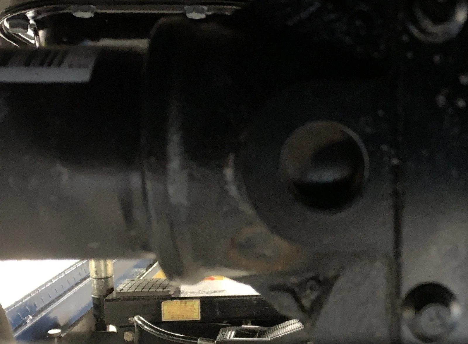

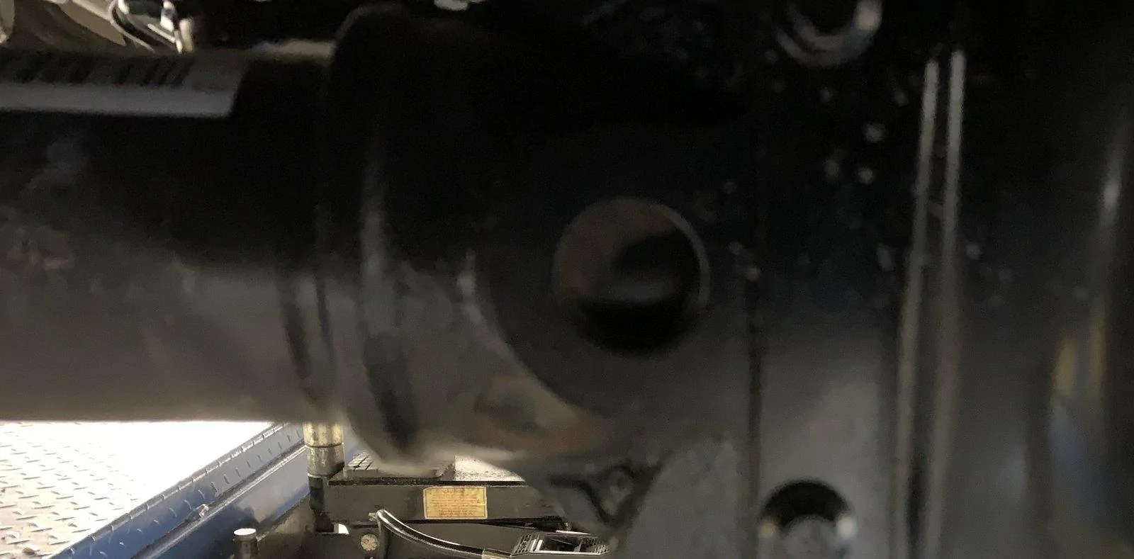

So jumping on this myself, put it up on a lift. Friend noticed a possible axle issue. The axle shaft seems to be moving and the weld may have rusted and broke inside the diff case. What do you guys think? See pics attached. I marked it to see if it’s moving around. I guess have to wait and see but this weld doesn’t look healthy.
Hmmmm. Sure beats me. I will pass it to my tech to look at it in the morning.
Hah. Are you serious? This was a huge problem with a lot of early model JKs over a decade ago, too. Weak welds were causing the tubes to move and hitting a pothole meant a bent axle. Some things never change.

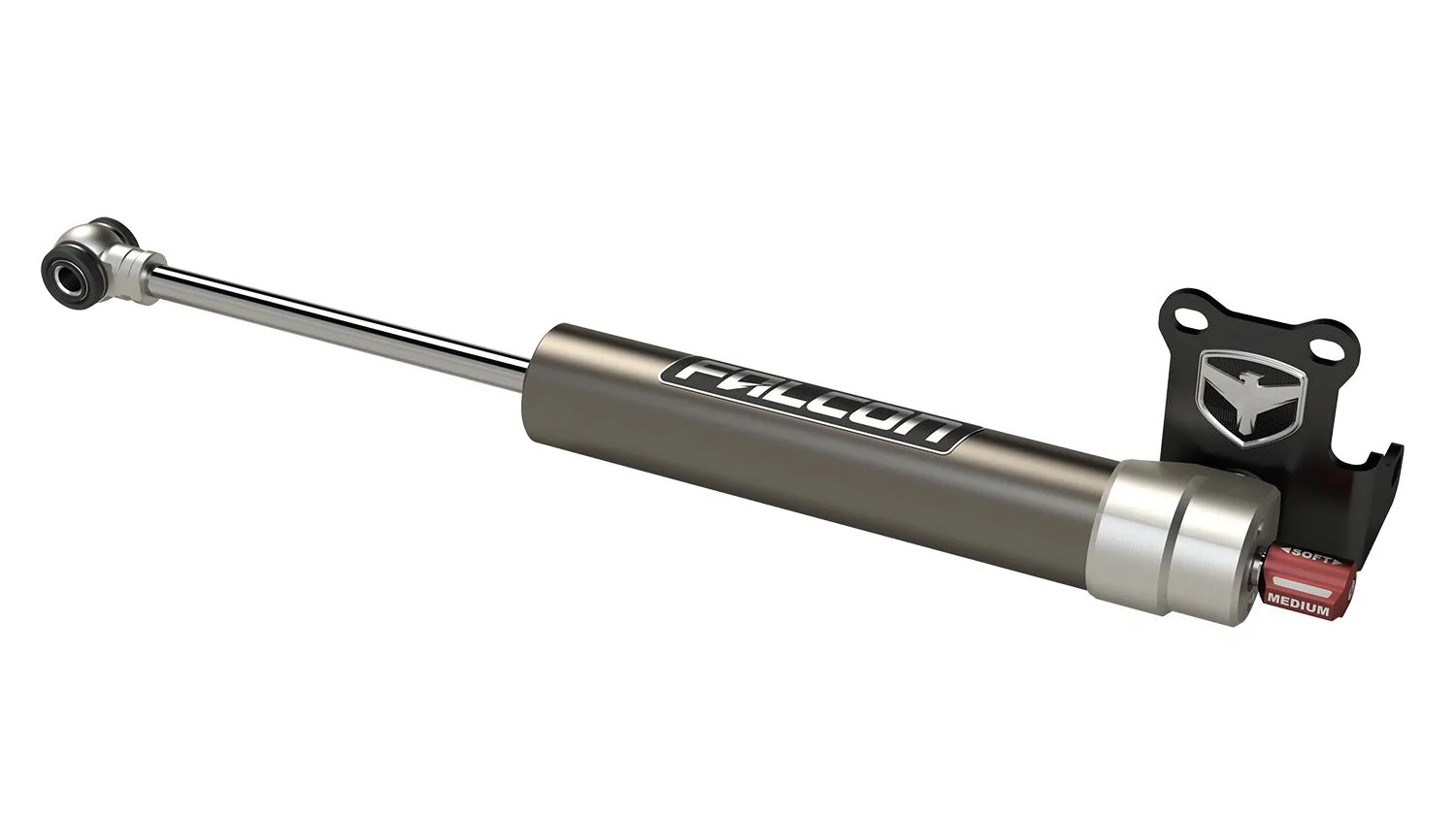

I told Jeep I was tired of there faulty steering dampeners and that they needed to pay for an aftermarket one and they said ok. Got the Falcon 2.2 -- riding around town on medium setting and its very nice. I know its not the root problem but its working out great for me and they are reimbursing me for the $330 I spent on it. I installed last night, drove last night and this morning.
