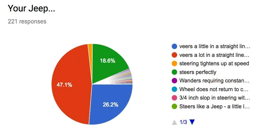

I have test driven 5 JLU's and they all had the wandering steering issue. When driving between 45-60 MPH these vehicles all "wandered." My experience was that holding the steering wheel steady did not keep the car in a straight line. It would wander slightly left or right depending on pavement, driving conditions. The vehicle seems to wander because when the wheel is turned in a direction, there is a 1 to 2 inch play before the front wheels turn in the direction intended.
When I experienced it the first time it was sort of fun. I have since changed my mind and decided that it is a significant problem and potentially dangerous. I was especially upset when the 5th one I drove, which was manufactured 9/18, had just been delivered to the dealership, and which I was prepared to buy, also had this issue. So, it seems to me that all JLU's have the wandering steering issue and that JEEP does not consider the issue significant. My guess is that many buyers of the JLU do not notice this steering issue, especially in short pre-purchase test drives. It also must be that many JLU owners drive differently or have different driving situations than I have. Many of the roads near me are 2 lane 45-60 MPH highways, and this vehicle does not work well on them.
My interest in purchasing one of these and my wandering experience led me to this forum website. My goal is to find out that Jeep has fixed this steering issue at the factory, so that I could then buy one and feel good about it. If anyone out there knows if and when this will be fixed at the factory, please let me know.
I was informed by a large FCA dealership that Jeep Wranglers which were shipped from the factory in mid December 2018 did not exhibit any steering problems at all. If you happen to visit a dealership in the near future and confirm a December 2018 production date, perhaps you can verify that the steering is indeed fine with one or more of those vehicles that you decide to test drive. Don't know if FCA has finally resolved the steering issue or is it still on ongoing problem for new customers to discover after purchase. Unfortunately, FCA has certainly not been very open or transparent to their customers about the steering problems.
