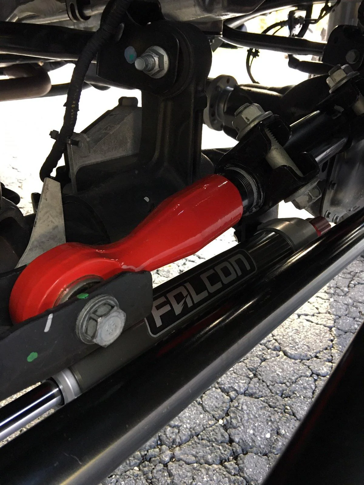

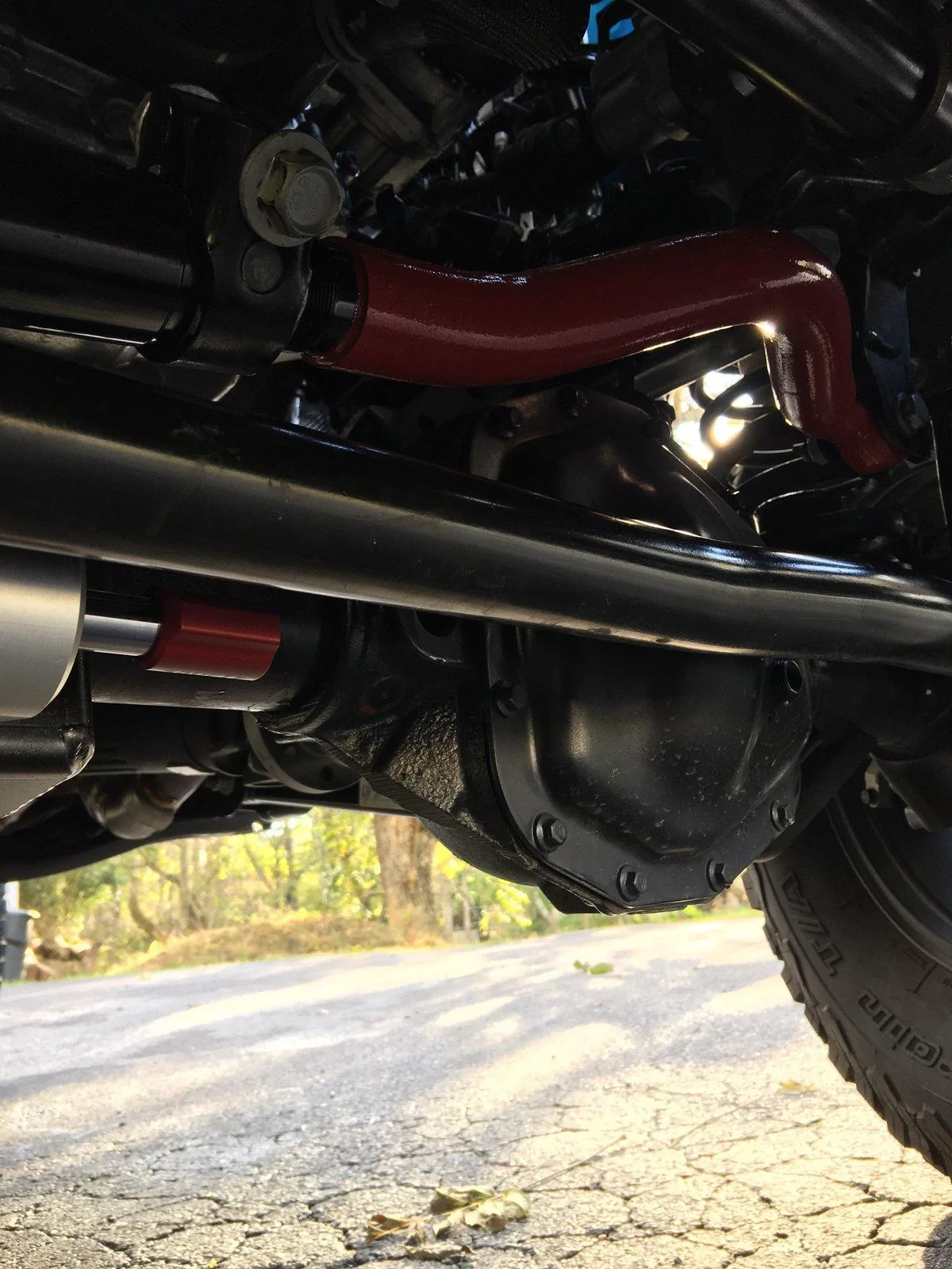

The first thing installed to assist in correcting this problem was the Steer Smarts YETI XD Adjustable Track Bar. It did make the steering better, but there were still death wobble issues. If you install the Mopar 2" lift, I highly recommend this beefy track bar. Joe was determined, and I was patient and willing to help all JL owners. Yes, I wanted my issue resolved, but I also value the importance of helping others. Joe dedicated the remainder of his day to track down this issue. Joe is also a JL owner, and his entire business is built around the passion for Jeeps. Sorry, I know this is a long read, but I want to get this out and hopefully save some JL owners from "steering" away from the JL. Many folks are waiting for steering issues to be resolved, and some have already traded their JL's in. Up to this point no one really has provided a fix or any hope on improved steering. Now I'm not claiming this will fix everyone's steering issues, but I assure you this did fix mine. Not only did it fix my issue, but it completely transformed my steering and driving experience.
Joe installed the TeraFlex Falcon Nexus EF 2.2 Fast Adjust Steering Stabilizer. We adjusted the setting to Firm, and Joe took it on one final test drive. Death Wobble, Bump Steer, Steering Issues, Drifting, all of my steering concerns were resolved with this new stabilizer. I never liked the extra steering drift, but with this being my 1st Jeep, I also read many posts that led me to believe it's a Jeep thing. Now I could of dealt with the drifting for years, but when the Death Wobble came along, well that's where I decided to take matters into my own hands. The OEM Stabilizer is currently on back order. My stabilizer was the issue, and replacing it corrected my issue. But I also wouldn't want to wait around for FCA to replace it with a similar stabilizer.
